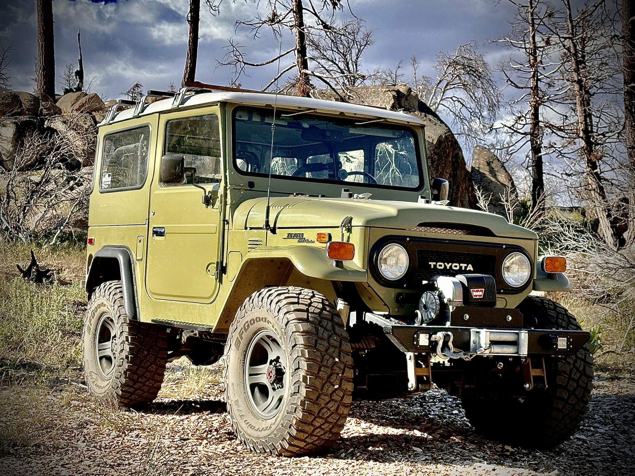

Last week, I picked up my first -40 after more than 15 years of wanting one. I've named him, Gunner.
This project started off as an attempt to get the truck safe to drive on the road and ended up as a full-blown frame-off restomod and at least 4 engines. To date, the truck has undergone three variations; v 1.0- v3.0.

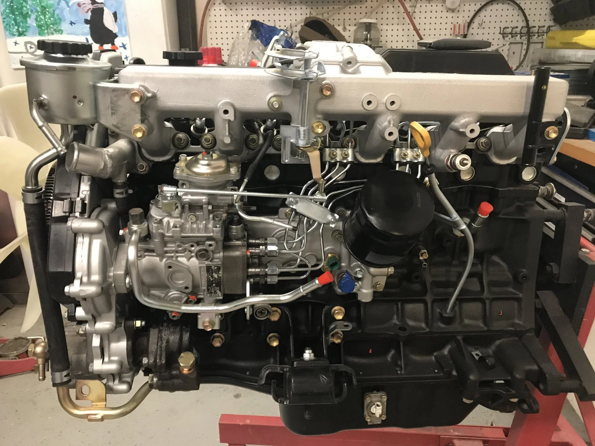

1HZ Turbo Diesel rebuild and conversion

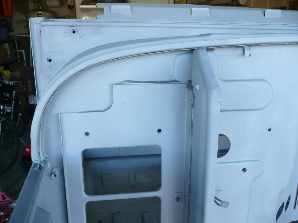

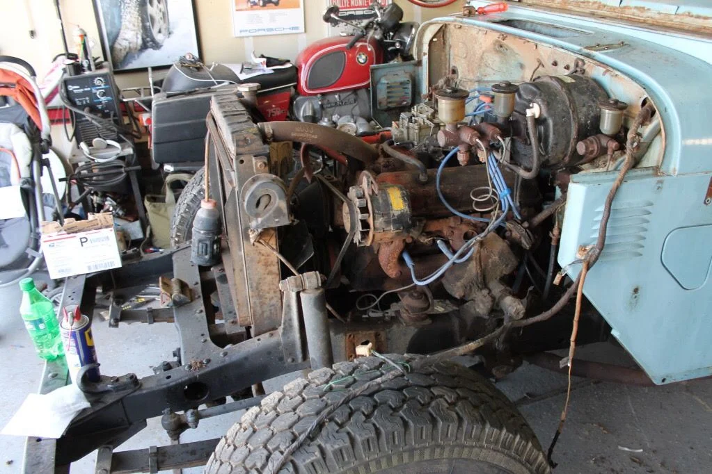

The first task was to see if it would run. I put some fresh gas in the tank but decided to replace the ignition wires first. I had a hard time reaching the rear most plug due to the exhaust routing. So, I started removing stuff until I could get to it.
I can help you out with some of those unknown wires and connectors using my 3/72 as a gude. The two connectors on the firewall, passenger side go to the fuel tank level sending unit and the rear lights. On mine they also include wires for the 4 wheel drive indicator switch even though that unit dissappeared when the 4 WD selector moved to the floor in the 72 model year.
On the driver's side, the green wire goes to the brake warning senders on the master cylinder (looks like your brake booster is not stock, so you may not have these anymore). The connector goes to the vacuum switch valve, an emissions component that was mounted on that bracket with the bolt in it, which undoubtedled disappeared when the PO ditched the F engine, so nothing for you to worry about.
The single wires coming from the firewall include go to the engine sensors; temperature (sensor and switch) and oil pressure. Again, these may not be relevant after your engine switch.
Looks like quite a project you've got going there. Makes me glad mine is more of a maintenance project than a restoration on. Good luck.
Oh yea, I'm really envious of your overflow bottle. Those weren't stock until the 1975 model year - before that, the coolant drained out to the pavement. My own custom bottle was reclaimed from my daughter's school lunch box and doesn't look nearly so macho as yours.
I was able to get to the ignition wires but while I was there, I noticed someone had swapped the 1F with some sort of pushrod V8 thing. While I stared at the V8 looking thing for a while, I accidentally left the frame outside and some a$$hole completely blasted and powder coated it.
This was a real problem for me because it meant that I could not ethically put anything dirty back on it.

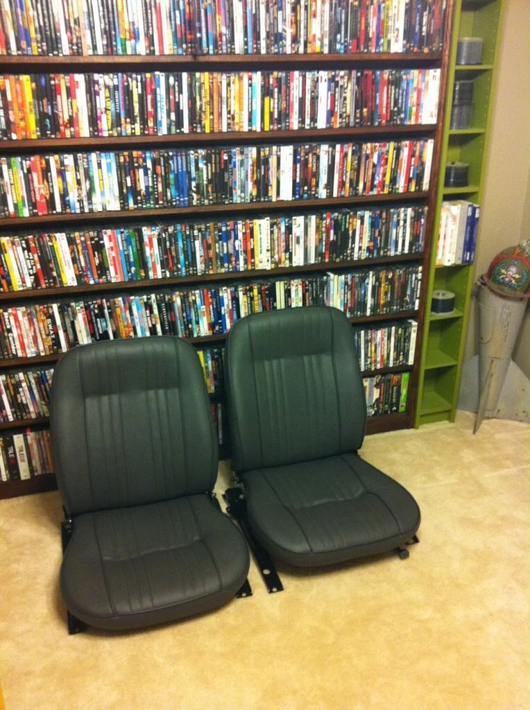

I disassembled the seats and had the frames powder coated and the reupholstered.

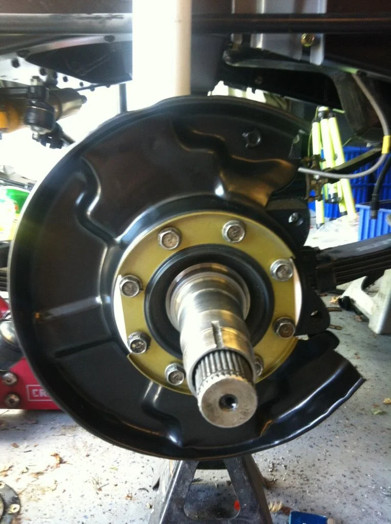

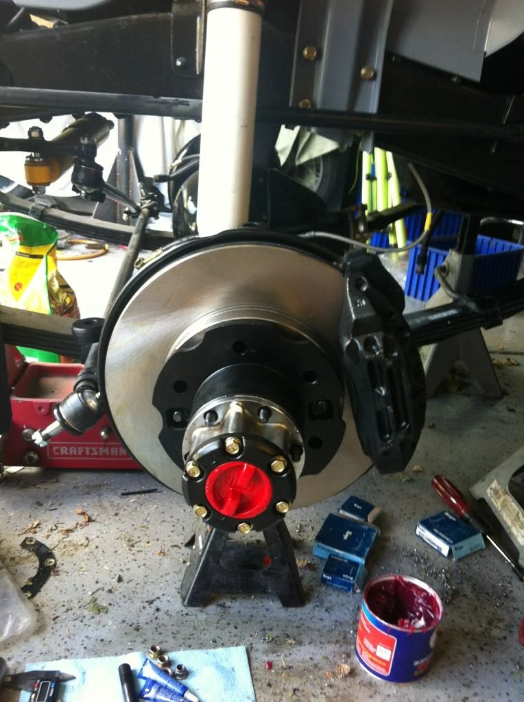

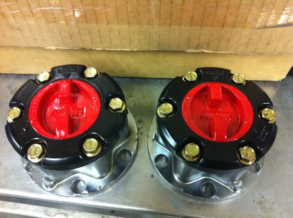

I also set to work rebuilding the axles. The front got upgraded fine-spline birfs, mini truck knuckles, 4Runner calipers, Asin locking hubs, and FJ60 rotors:

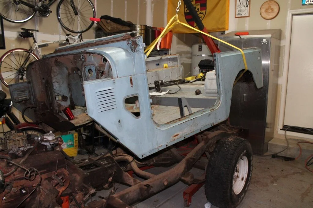

A big job was getting all the tin stripped to bare metal so I could begin to work on the body.
Luckily for me I'm quite lazy so I opted to have a local shop strip every inch of tin work for me.
I'll say this much... it is so nice starting with a relatively dry body. This truck was is much nicer condition than many I've seen on this board.

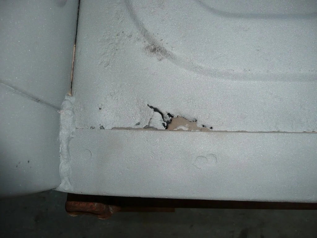

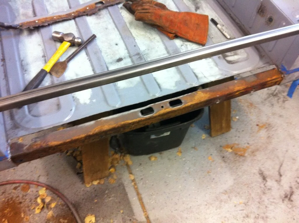

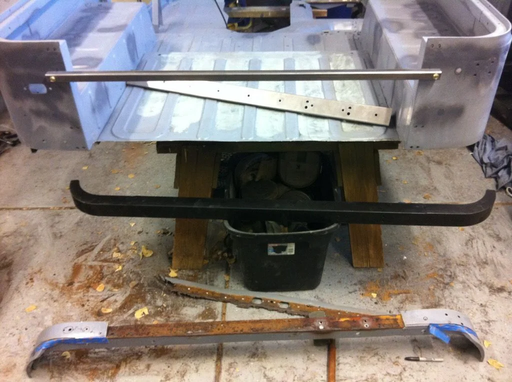

And I know there's a lot of rust lurking behind the rear sill...

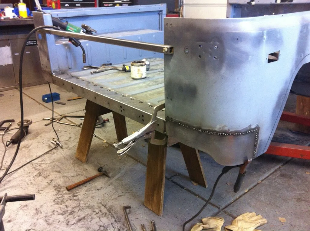

I cut out both front pans and replaced them with panels from CCOT.
This is my first time doing open heart body work and I've made plenty of oopsies.
I warped the drivers side panel because I put too much heat in it while welding.
You can also see where I cut on the wrong side of my guide tape and got half way across with the nibbler before I realized my mistake.
Drilling out all those spot welds was lots of fun.

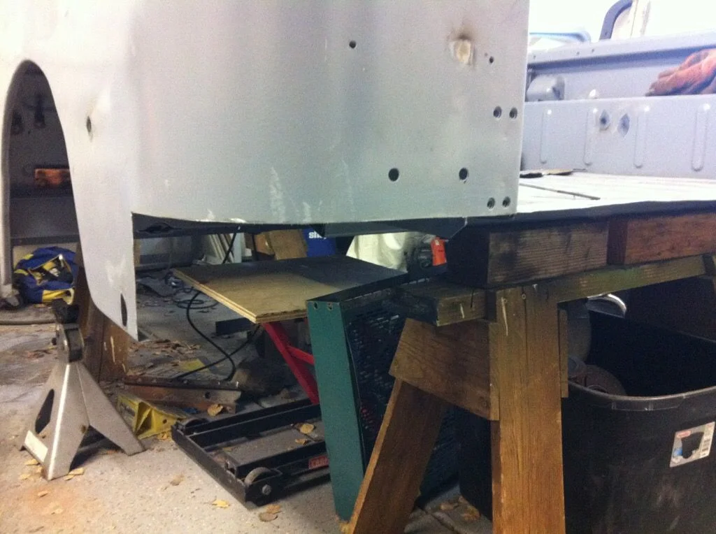

I put the tub on it's side to reinstall the frame gussets.

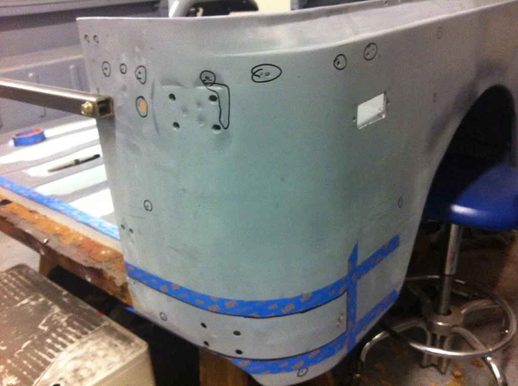

I also cut out and welded in patch panels for the few trouble spots where there was a lot of pin holes.
...as you can see, I'm not a trained welder nor do I play one on tv. I am doing the best I can with what I have and I am already seeing an improvement. I can tell you that my biggest headache has come from weld contamination and unexpectedly running into a thin spot and having it blow through.

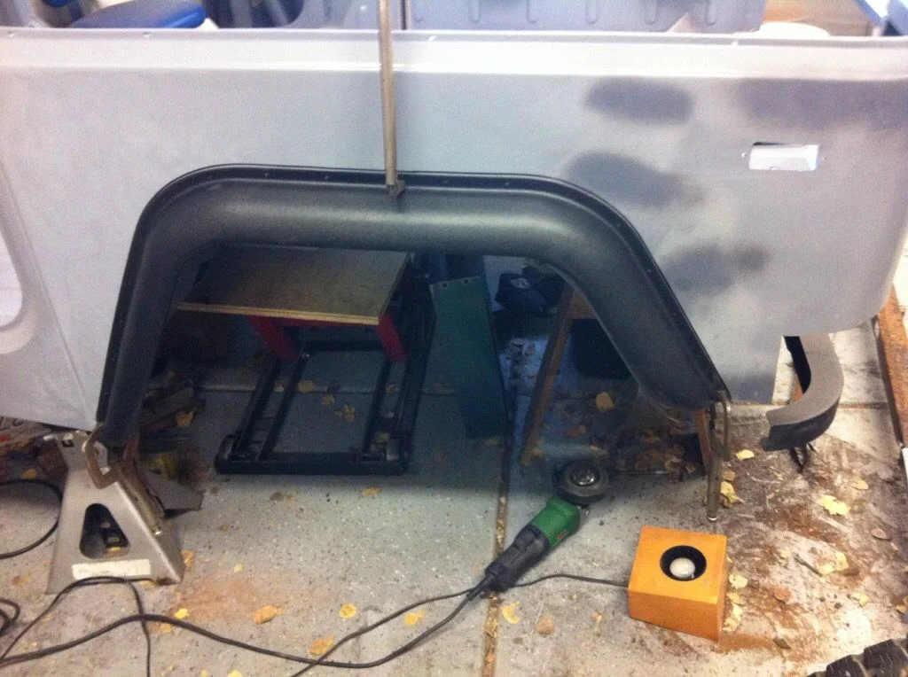

I've also decided to cut out the botched rear wheel openings with bushwacker flares rather than return them to stock.
I also wasted a bit of time and money on the front brakes. I really wanted to dump the drums and was looking for the least expensive way of accomplishing that goal. In my FJ-naïvety I somehow landed on GM Monte Carlo calipers and JTO brackets.
Well, after doing a bit more reading, I've decided that's not such a great idea for front brakes so I've picked up a set of '82 Mini truck knuckle/hub assemblies and will be converting the front axle over to FJ60 vented rotors and 4Runner 4 piston calipers. I'm on the hunt for a set of fine spline outer birfs too so I can dump the Warn locking hubs for a set of Asin hubs.
The GM calipers are going to be moved to the rear axle. I'm going to pick up a FJ80 1" MC, a mini truck booster and a proportioning valve from Summit to complete the brake system.

Good idea on the bushwhacker flares. Mine have been great. Just be careful hitting them in extreme cold. Also make sure you seal them well with good silicon top and bottom do they don't trap dirt, salt and grit against the sheet metal.

Today's project was to install the new rear sill and quarter panel patches:
