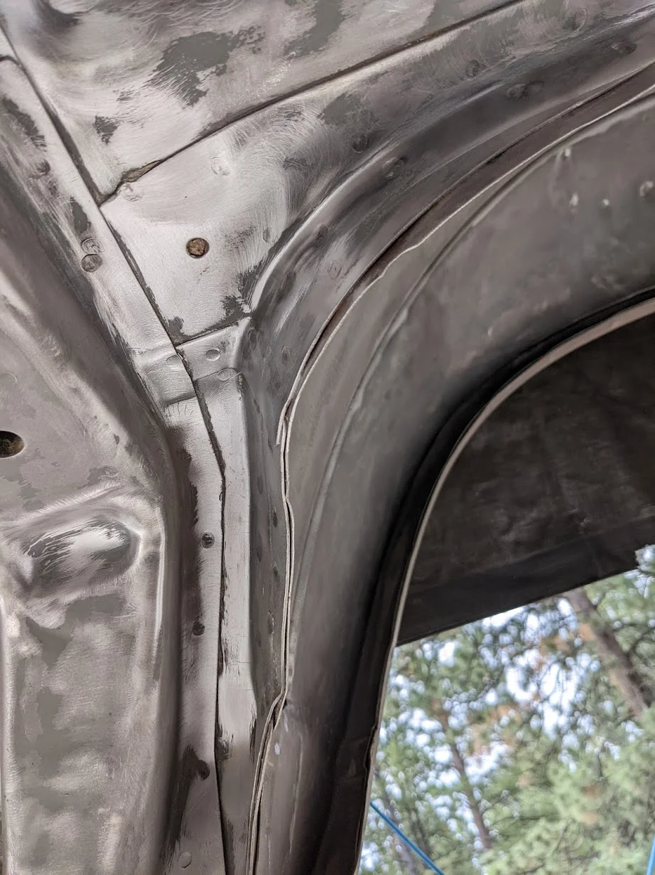

I've taken the body off my FJ60 and am in the process of wire wheeling off all the existing undercoating and rust.. Getting it down to bare metal and a few patches of well adhered factory paint. See here for a partially completed pic:

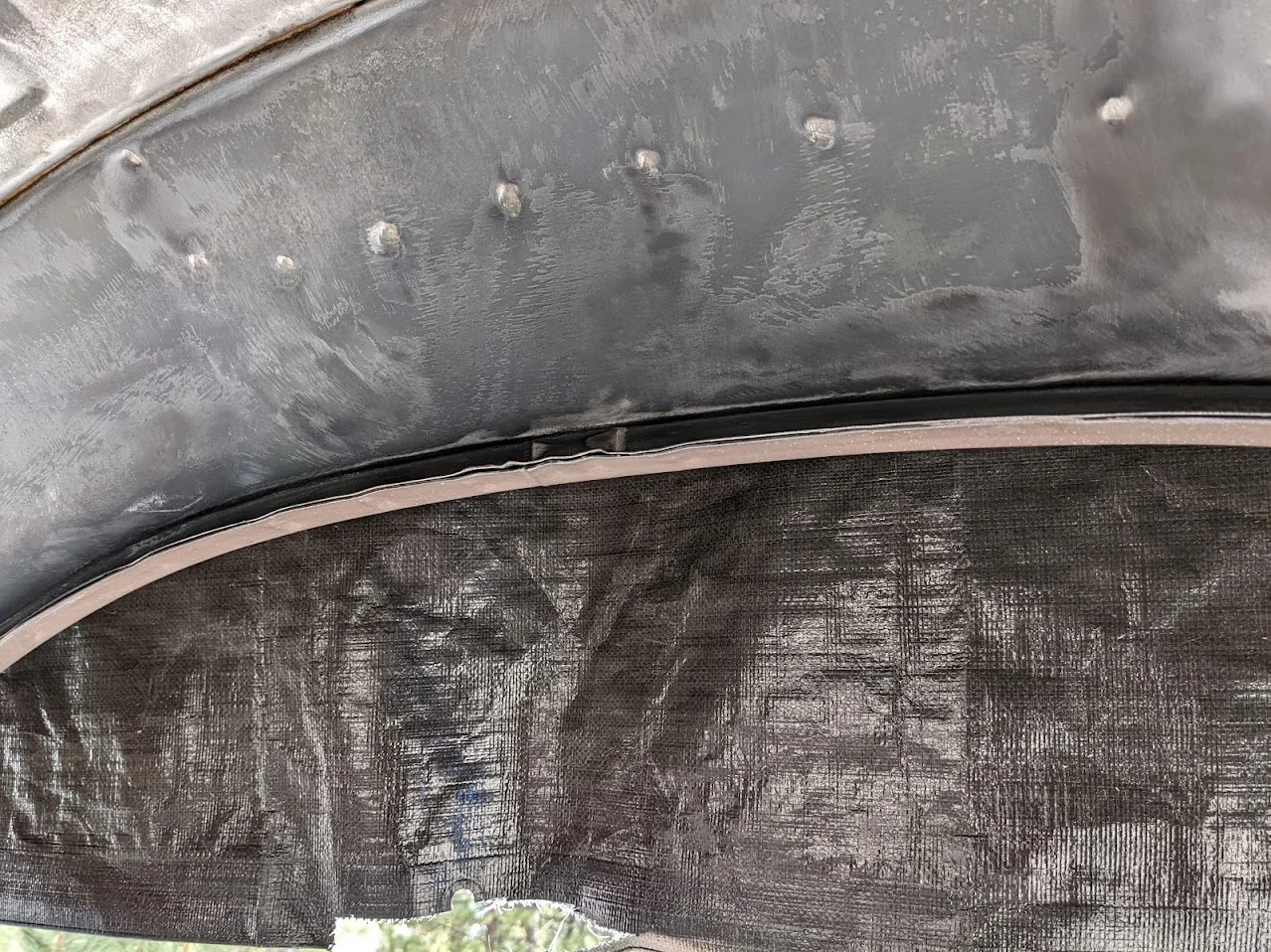

I've got some 3M Heavy Body 2K seam sealer coming and planning to cover every seam I can find on the bottom of the truck. Interestingly, most were bare from the factory. I do have a question for you guys (@CenTXFJ60 and @PAToyota included).. Any tips on seam sealing edge seams like these:
There isnt much there to glob the sealer on to, and for the fender/body seam, it's gonna be semi-visible. Do I just press as much into the seam as I can and wipe off the extra?
I'm also a bit nervous about the sealing b/c this stuff apparently only has like a 15 min working time, so not a lot of time for fixing errors.

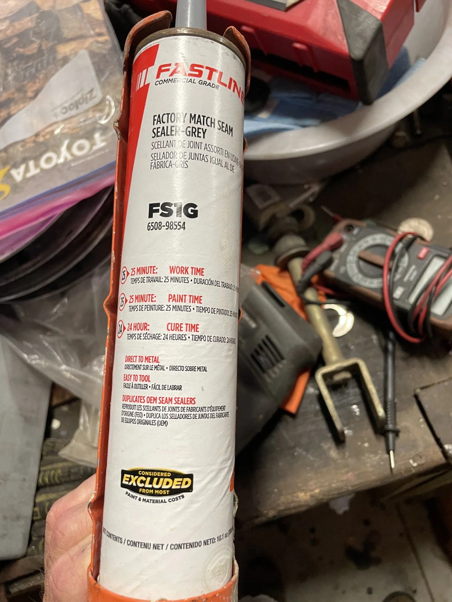

Man…you’re going to town on this rig :). As for the pinch weld on the wheel we’ll return, that would be a tough one. To your point, any excess would be visible on the outside, I’d use the fast line product in this pic. I’ve used the 3m stuff before and it’s much stickier and harder to work with once dispensed.
