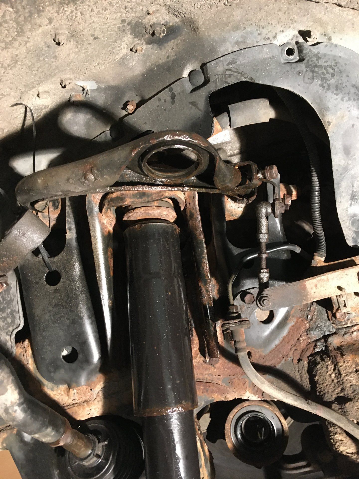

Maybe a dumb question, but how can you tell when your upper control arm bushings go bad?
I am replacing my upper ball joints (which are completely shot) but they just won’t press out. I am pretty frustrated and considering now just going for entirely new UCAs since if I pull the current UCAs to bring to a shop I’d need an alignment anyway.

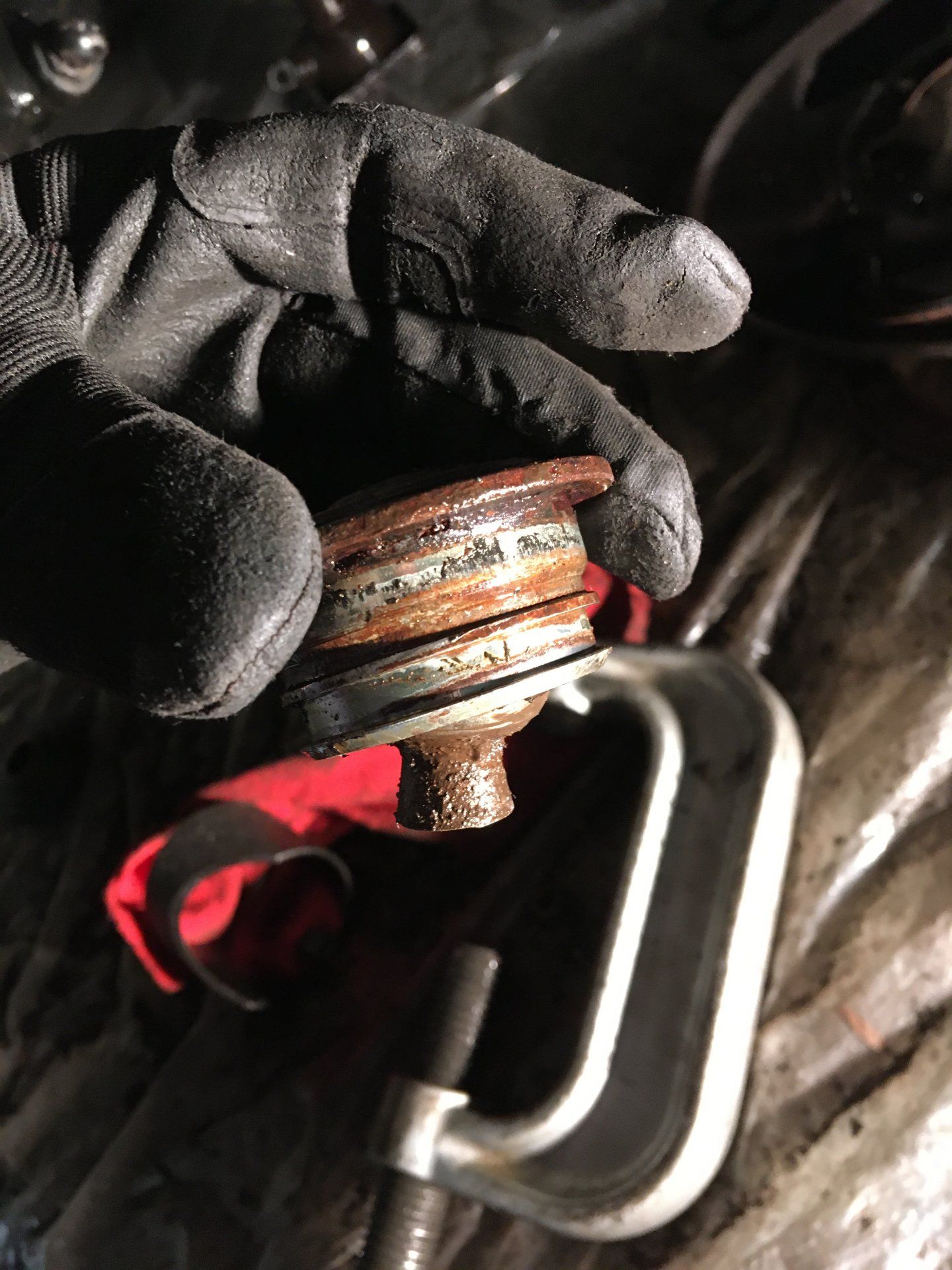

I am using the same tool as in the video, rented from Advance Auto Parts. Been soaking the UBJ in PB Blaster for two days and can’t get it to budge, even when cranking absoultely as hard as I can with my 25” breaker bar. I’m going to buy a torch and a pipe to slip over my breaker bar as a last resort before removing the arms to bring in to a shop with a bigger press.

Do you have any means to apply some heat?
Going to buy a torch head and big pipe later today. I have 3 torches back home but unfortunately I am 1000 miles away.

Torch worked like magic — didn’t even need a bigger breaker bar!

Yep,
Use the tool to put/keep pressure on it then apply heat. No need to use penetrating oil which is unlikely to help 'press fit' components anyway ....or wail on the part with a hammer which I see someone has done to your control arm. The ball joint for the lower control arms comes out more easily.

Thanks! The marks on the UCA are from when I got frustrated with the snap ring. Couldn’t find the correct “duck bill” style circlip pliers anywhere locally and eventually resorted to taking it out with my biggest pry bar. Not my finest decision perhaps but I had already sank several hours into it at that point and was desperate.... Should have slipped a piece of wood in there but hindsight is 20/20.
