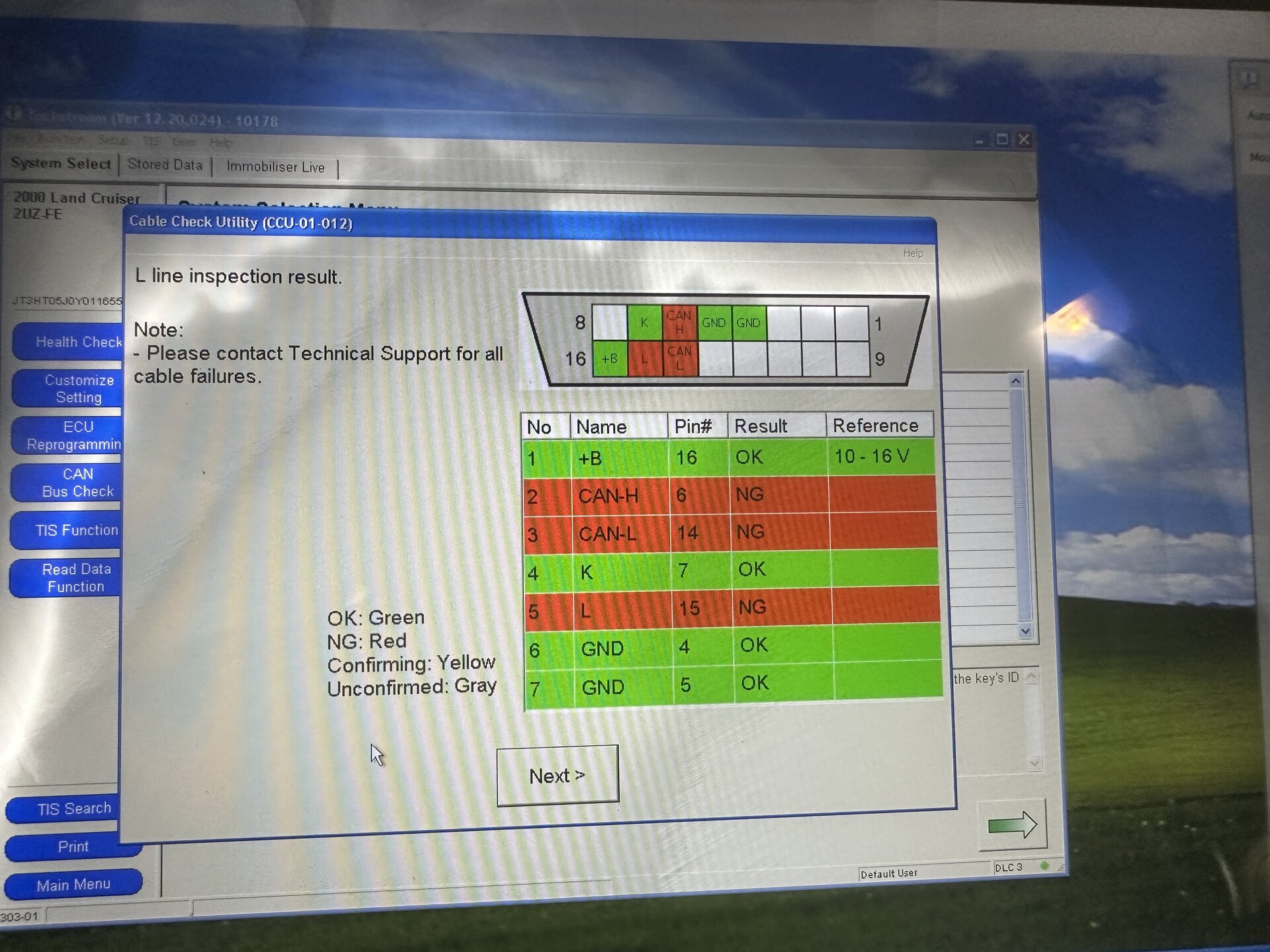

I ran a cable check on a new adapter and received results that say three of the lines are NG. I can read data ok, but I have been unable to do anything else. Is this normal or do I have a bad cable?
I ran a cable check on a new adapter and received results that say three of the lines are NG. I can read data ok, but I have been unable to do anything else. Is this normal or do I have a bad cable?View attachment 3340343
Has anyone ever run the cable test in Techstream? I got the results shown above and an trying to determine if the cable is bad of it it is a software issue. I can read codes and erase codes, but I don't know if I can write anything. I've typed the VIN number several times and it never seems to remember it. Is that normal?
Thanks for any guidance.
I had a cable that worked to read data like TPMS info the first time I used it. It then stopped working and I got these same errors about 3 of these NG. Unfortunately, I never ran this test before the failure so I don't know what it looks like before. These Chinese cables are very fragile and I am not surprised if they stopped working after a few uses. Look at my previous post on VXDIAG. I am so much happier with my new solution. Much more sturdier. It cost 2x but is worth not dealing with the headache of these fragile cables. Luckily I was able to get a full refund on my cable. If you are not able to spend the extra, I would suggest being super careful not to bend it and such. (This is just a guess based on my experience and I don't have any scientific proof)
