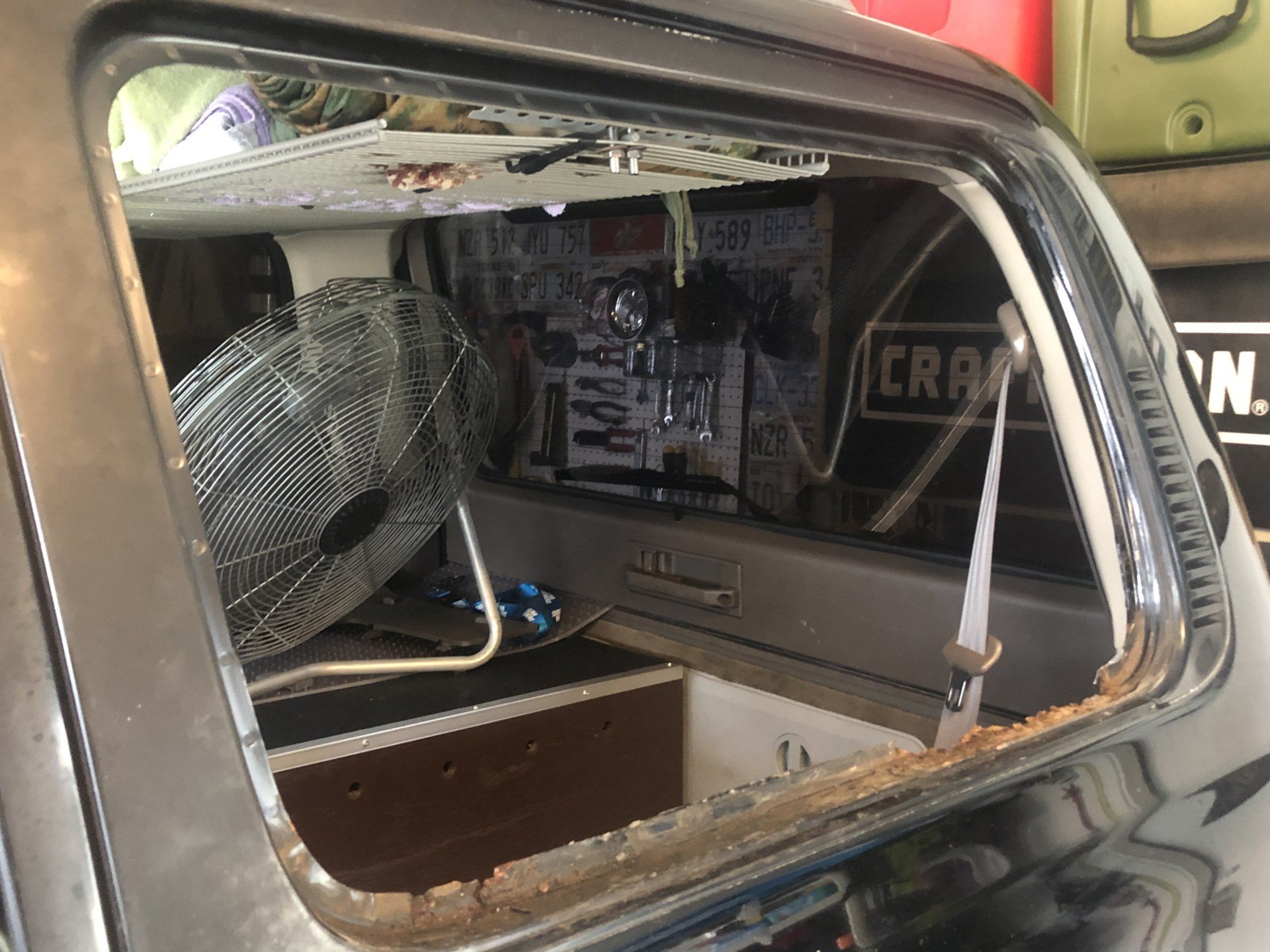

@Blacatoe what was the solution to the rust problem? Found this thread when I realized how much rust I have in the track when I went to open the window.
Rust on the body or the aluminum frame that the window sits in?
On the body: uninstall window sand down and repaint.
On aluminum frame: uninstall window. Remove outer rubber seal that houses the aluminum frame. Remove screws on top and bottom. Remove windows, beam that separates windows, and inner rubber seal that the windows sit in. Assess damage to the frame, if it's gone you'll have to buy one used from somewhere. If its salvageable you'll need to clear out gunk and replace the film squares on the bottom correctly so water can drip out the bottom and not into the car.

@ProjectLover It seems like it actually might just be the aluminum frame, it's not rust, it's just crumbling. If you pull back the rubber seal a bit you find out it's the only thing holding the frame together.
That's oxidized aluminum. If the water cant drain out through those plastic flaps on the bottom then water sits in the frame and dissolves it away slowly. You'll need to pull it to check the condition, clean and probably repair the flaps.
With mine, I had the aluminum frames powder coated to prevent future oxidation and upon assembly left the flaps off so that water will more easily drain. I also live in AZ where rain/ water is not as much of an issue.
I initially thought the flaps also served little purpose. However if too much water travels through the holes on the bottom of the frame it was filling up the channel between the window and the body and overflowing into the cargo area and rusting my jack and soaking the carpet. Those little flaps have to be put together just right to prevent that.
