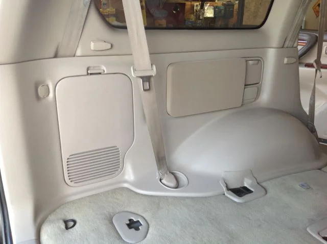

Just pulled my sub box out from the 01 TLC and going to try this

my 02 ML sub was blown and partially seized the voice coil. not salvageable so the hunt began. i ended up with one JL6 with the factory box, kind of. after a bit of calculation i laser cut 4 abs sheets as an adapter/spacer to give the huge magnet some room in the factory box. hijacked the factory wires and added an arc audio amp near the jack. a TON of rattle chasing & soundproofing later, as this thing now kicks some butt (often mistaken for a 12" by people). i added 1" abs to the factory grill to space it out, recovered in new fabric, and voila. looks almost stock and sounds 1000x better.

So I've been dreading tearing into this, but my factory sub has been sounding awful with a serious rattling coming from the sub - even my kids complain.
I got into it tonight hoping all I'd have to do is a simple RTV glue job on the foam or cone. Nope.
It all came apart fine. Thanks for the instructions. There were 3 surprises.
1. There's (2) 4-5" speakers there. They are OEM. Maybe I missed it, but everything I've seen here refers to a single dual voice coil speaker. This Hundy is a 2000 model. There's a 2" air port on the box.
2. There were no tears or damage to either one. I fired up some NIne Inch Nails - loud - and the speakers functioned properly.
3. I buttoned it back up with a few pesky clips but I got em. Cranked the tunes back up and it sounds better than it has in the 2.5 years I've owned it.
Maybe there was an errant connection? Maybe a loose clip? There was some loose insulation. Dunno but I'm knocking on wood right now.
