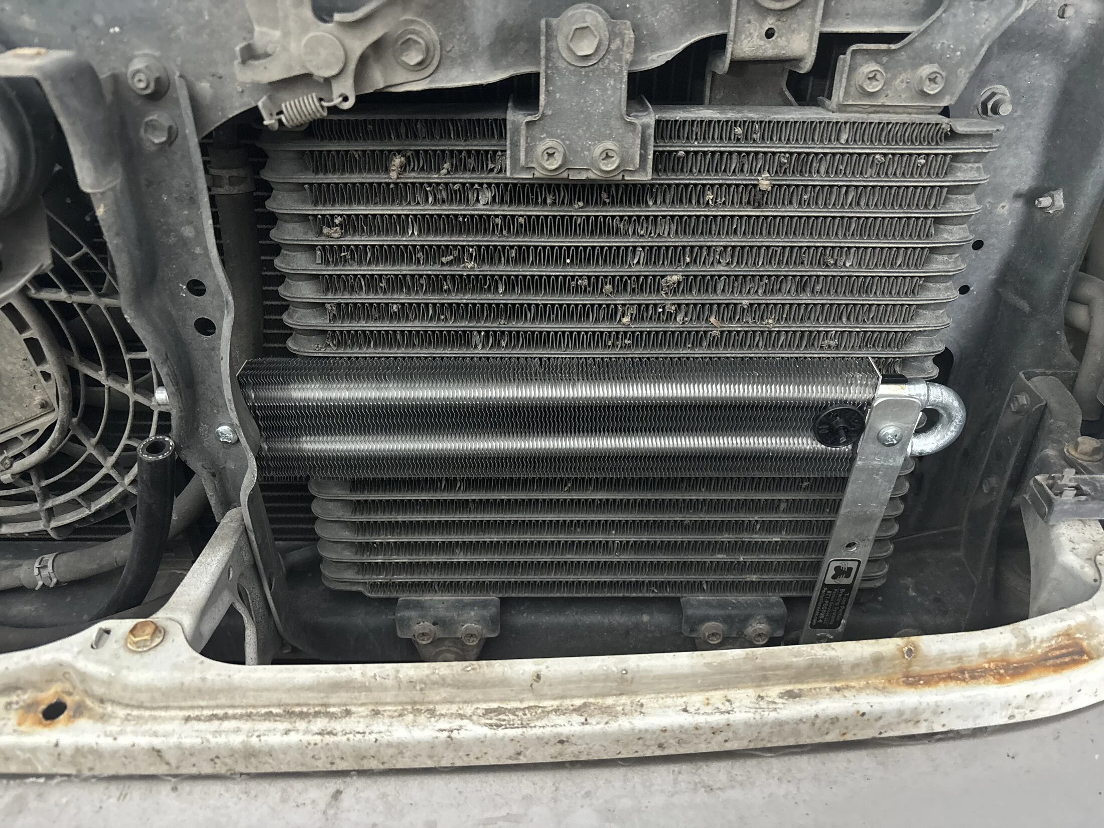

Pump has been cleaned and resealed. New reservoir installed. New hoses except for high pressure crimped hose. Added a power steering cooler. Not knowing history of this rig I'm suspicious this rack has been replaced before. Old rack was 5 threads off center to the right. Gonna center tie rod ends on new rack.

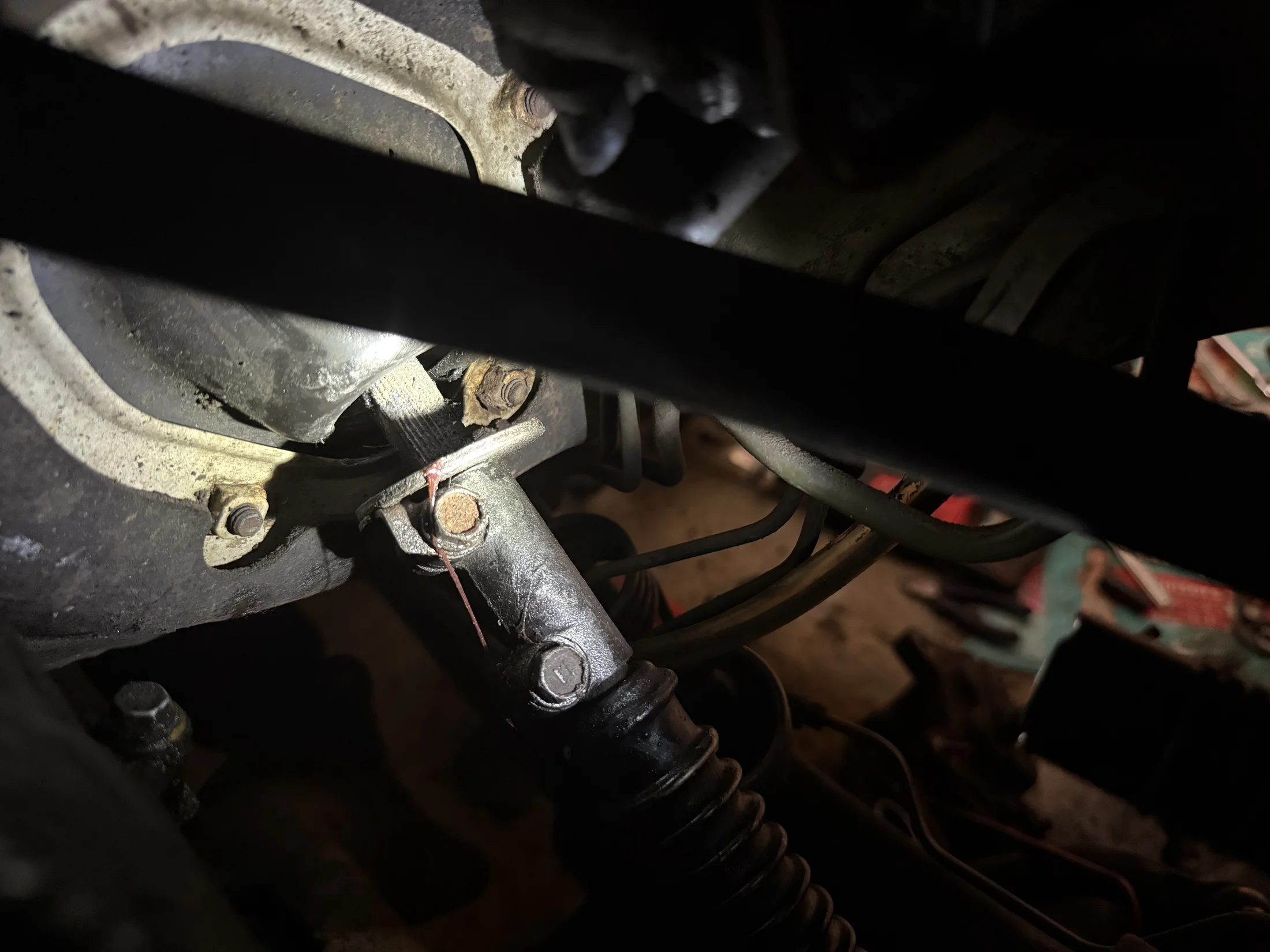

What was the original position of the steering shaft from the factory on a hundy? Haven't found it in the FSM yet. Going to dig again. Guessing my steering wheel was recentered at some point. Thank you.
Edit: Studying the FSM picture as I don't see anything specific written, the 2 bolt sliding yoke by the firewall should match the u-joint bolt that mates to the rack 90 degrees to the passenger side from center. There's a white dot on mine that points straight up in this position. I'm wondering if this is a factory mark. This looks to be where I need to land and then I can recenter the steering wheel and clock spring. This should get me back to factory.

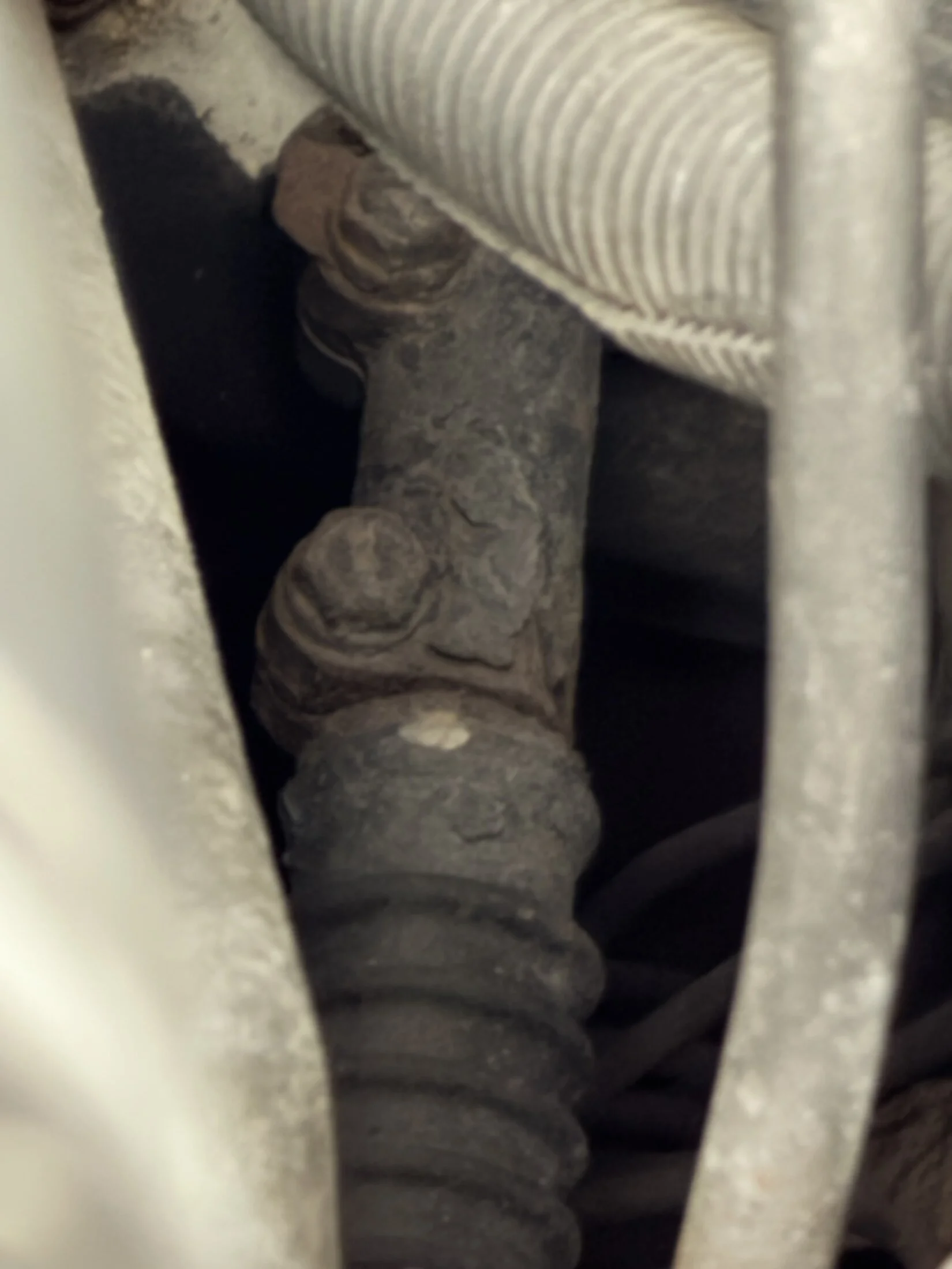

Here’s a picture of the alignment mark that I’m wondering if it’s factory. My old steering rack was out of adjustment by six threads on the tie rods and I think that equates to about two splines on the steering wheel. Trying to get back to stock with the new steering rack.
Finished installing everything today. Discovered that Toyota doesn’t center the rack like other manufacturers. Gonna try to set the toe in as best as can and then deal with centering the steering wheel. Pic of the cooler I added.
After looking at other trucks in the club of the same vintage that have not ever had their steering rack replaced I thought I’d follow up to anyone who is interested that the white dot on the upper intermediate shaft is factory. And the alignment is basically upright or slightly to the drivers side when built since it’s somewhat of an optical illusion at the angle it exits the firewall.

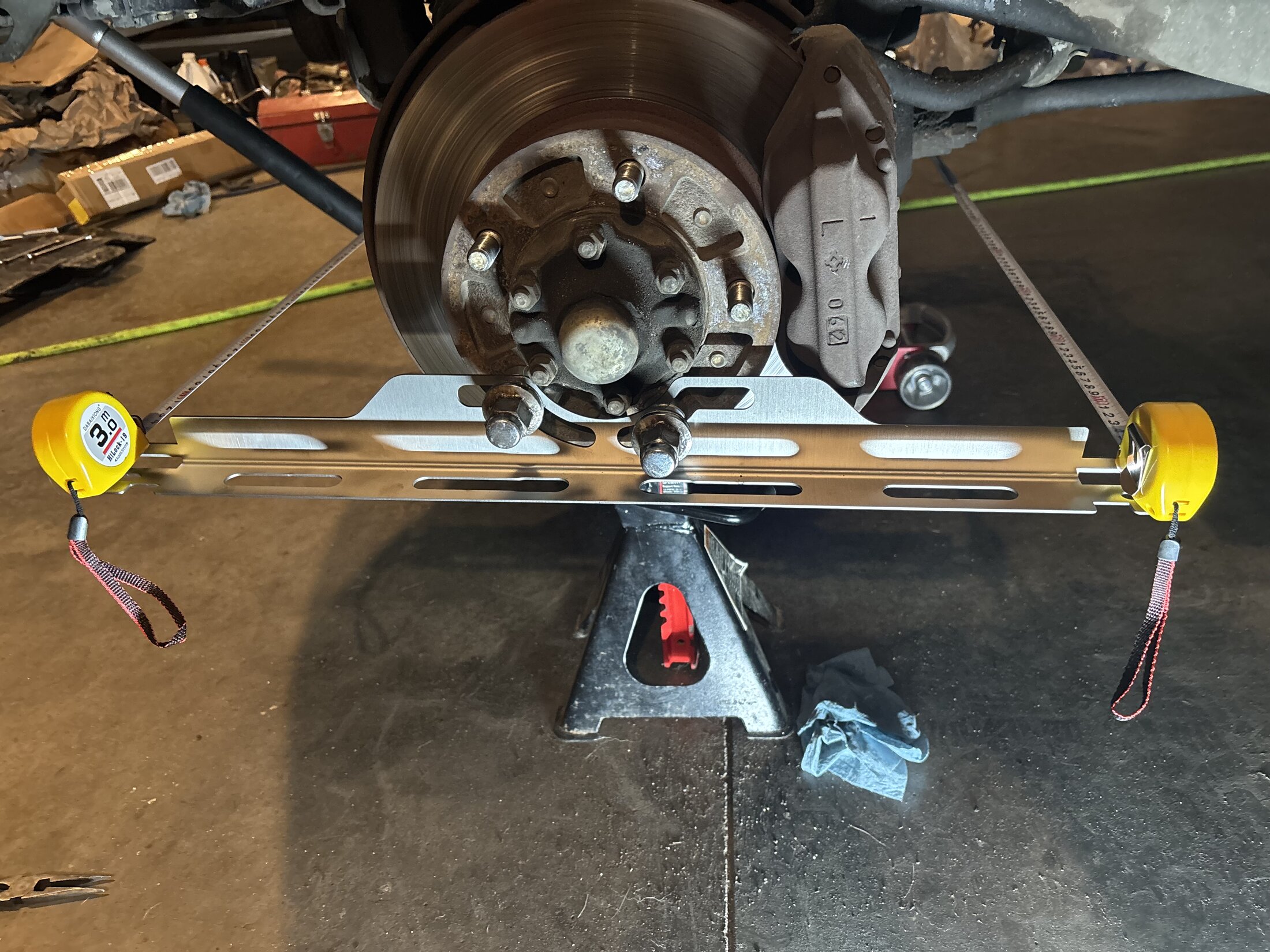

I purchased some toe in bars to set the toe as none of the other alignment was affected with the steering rack replacement and I can use these bars on all the other projects I have.
I'm curious how expensive those are. I ended up making some for myself out of 1.5" aluminum angle after doing my rack replacement. By simply counting rotations to get the old outer tie rods off (and re-installing the same) I ended up with something like 2.5 deg toe-in (assuming my math was right) and had to adjust something like 7-8 turns on the outers to get back to ~1 deg toe. Not sure if my count was off or if there was just that much difference between the new and old inner/outer tie rods and rack.
Amazon has some inexpensive ones. Mine came with an angle finder too but it no longer listed. Under $50.
Interestingly in talking with a couple of alignment techs, I have not gotten a clear answer about setting the toe in since the bars are shorter than the diameter of the tire, so I did some calculations on mine to set it within 1/8 inch of an inch for the tire diameter. I’m running larger 33’s
Yeah, I'm not sure how much toe-in would be expected to change between being loaded (static) and un-loaded (front end raised with wheels off), but can imagine that could be mitigated by using a pair of jacks to lift the front by the lower control arm, but that also seems like it could be a bit unsafe. Since I made the pieces to do my rough alignment I made sure they were long enough to run tape measures on each side of the tire with the truck sitting on the ground. Each tape measure slot was cut 16" from center, then I used half the difference between front and back measurement and basic geometry to calculate toe.
Conceptually, seems simple enough, but I'm sure there are real-world complications for a suspension that moves in 3-d space and trying to simplify this far.
Those will only give you total toe across the axle. Did you verify toe on each wheel with a string box after aligning the steering wheel? Less than or equal to 1/8" difference across those 16" gauges is perfectly fine. Your toe angle is half the difference in measurement, but that only really matters on a professional alignment setup. What were your total toe measurements? In theory you could have the passenger 1.5 degrees out and the driver 3 degrees in and the total toe would reflect 1.5 degrees toe in.
Here’s a picture of the alignment mark that I’m wondering if it’s factory. My old steering rack was out of adjustment by six threads on the tie rods and I think that equates to about two splines on the steering wheel. Trying to get back to stock with the new steering rack.View attachment 3840836
Secure the steering wheel in the straight-ahead position using a strap or rope to prevent it from turning and damaging the clockspring.
Remove the two pinch bolts at the upper coupler near the firewall. Slide the upper portion of the intermediate shaft upward toward the firewall to disengage it. Then remove the pinch bolt at the lower end where the shaft connects to the steering rack input.
Carefully pull the steering rack toward the firewall to free it from the shaft. If it’s stuck, loop a rope around the U-joint and pull upward for leverage. This avoids hammering on the shaft or coupler, which could cause damage.
To center the rack, measure the exposed length of the inner tie rods from the rack boots to the beginning of the threads. Use small pliers to make minor adjustments until both sides are within 3mm of each other.
With the rack centered and the steering wheel still fixed, slide the upper shaft into the coupler at the firewall first. This end has a groove that must align correctly. Once the top is seated, slide the lower end over the steering rack input. The lower end isn’t keyed, so alignment isn’t as critical.
Always fit the upper portion first. If you install the bottom first, you’ll likely need to rotate the shaft to align the upper slot, which can throw the steering rack out of center. Once both ends are in place, reinstall all three pinch bolts and torque them to spec. I like to use blue thread locker here.
Agreed. Since I made the adjustment on the ground I was also dealing with resistance of the tire against the driveway surface. Since everything was put together, after each adjustment I'd back up about 10' then drive back forward to ensure the truck was tracking straight (changing the calculated toe by 1 deg made a marked difference in how it steers, it was still pretty obvious if it was wanting to track straight or to one side or the other), then re-measure. It was rough and dirty until I get the rest of the modifications done and can get it on a laser alignment rack, but with a total calculated toe in of around 0.8 deg it seems to drive well and I've seen no signs of excess tire wear after about 60 miles of around-town driving.
In the past I have placed two pieces of parchment paper under the tires to reduce that friction. You can even put a little dap of butter or grease between them for extra slip. Sounds like you have it handled. They still do race setups with a string box for a reason.
After a lot of measurements, realizing our Toyota rack did not come centered and inspecting original racks on hundy's in the club was able to get it spot on and it's doing great. Highly recommend the aftermarket cooler.
