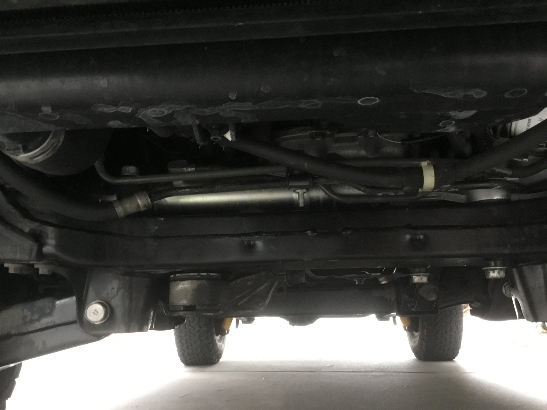

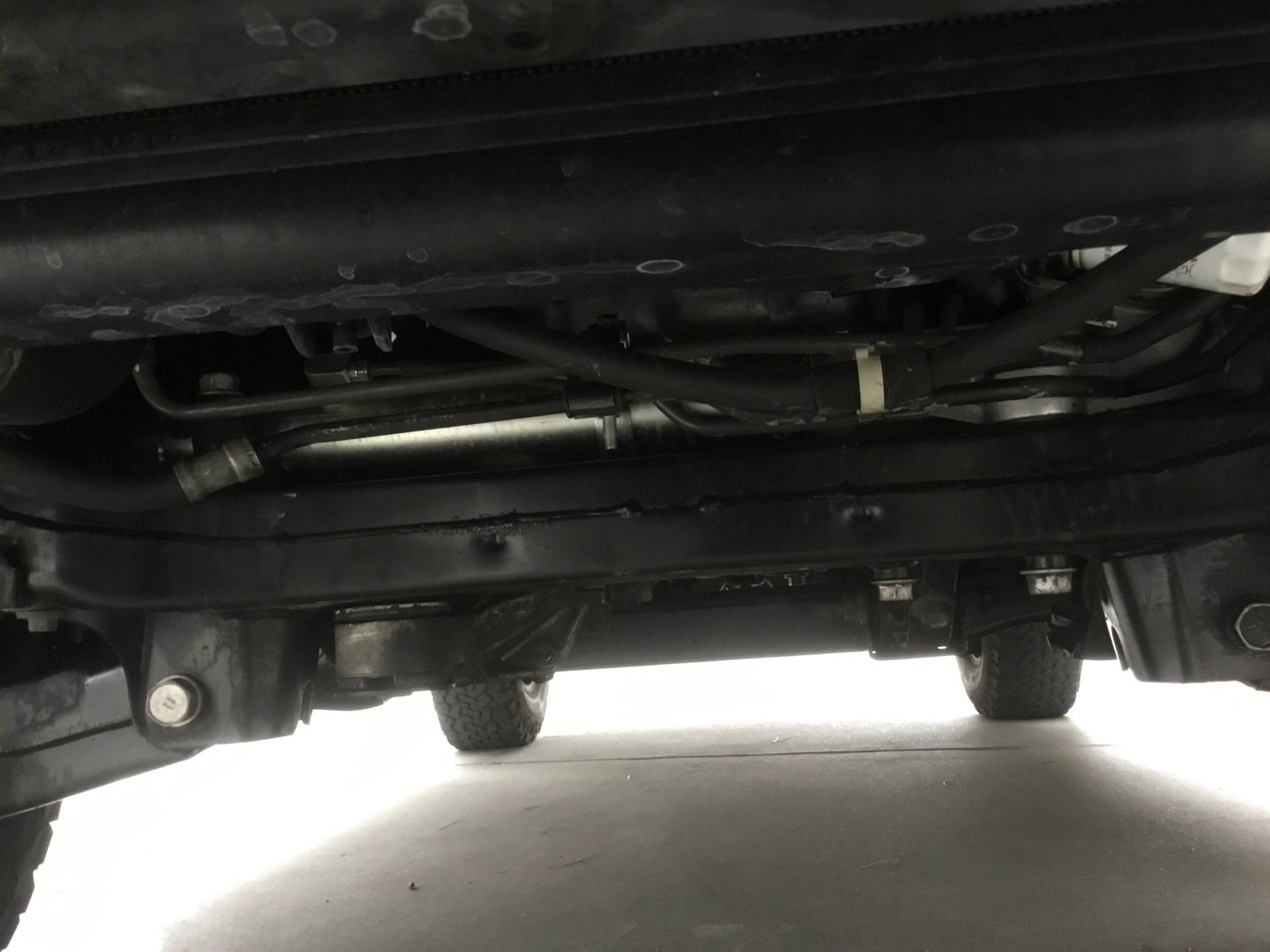

Got my rack installed by a professional. I read and read but didn’t feel comfortable installing it myself. And also didn’t want to spend two days installing it

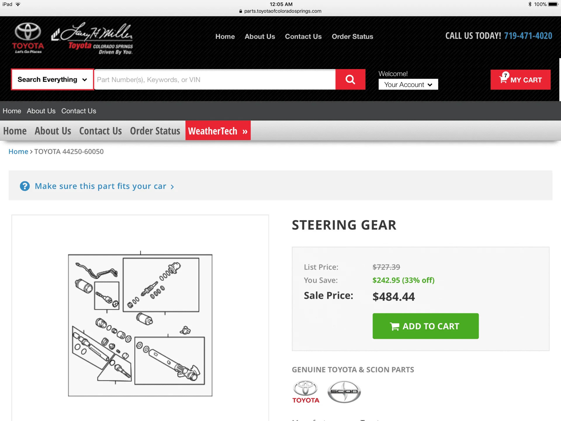

Got the OEM rack from groove Toyota on Broadway who price matched a online price. Bought the rack for $484 + $24 for a steering grommet
The Toyota specialist charged me $652 for labor, power steering conditioner flush and a alignment.
Drives a lot better with the new rack and suspension.
Some good guys over at Groove! Was that the remanufactured OEM steering rack (gear)?
It was brand spanking new. Originally they wanted $800+ for the rack. I showed them what Larry H miller Toyota in Colorado Springs was charging and they price matched it. Didn’t feel like driving 2hours round trip to pickup the rack.
Kuhyuan,

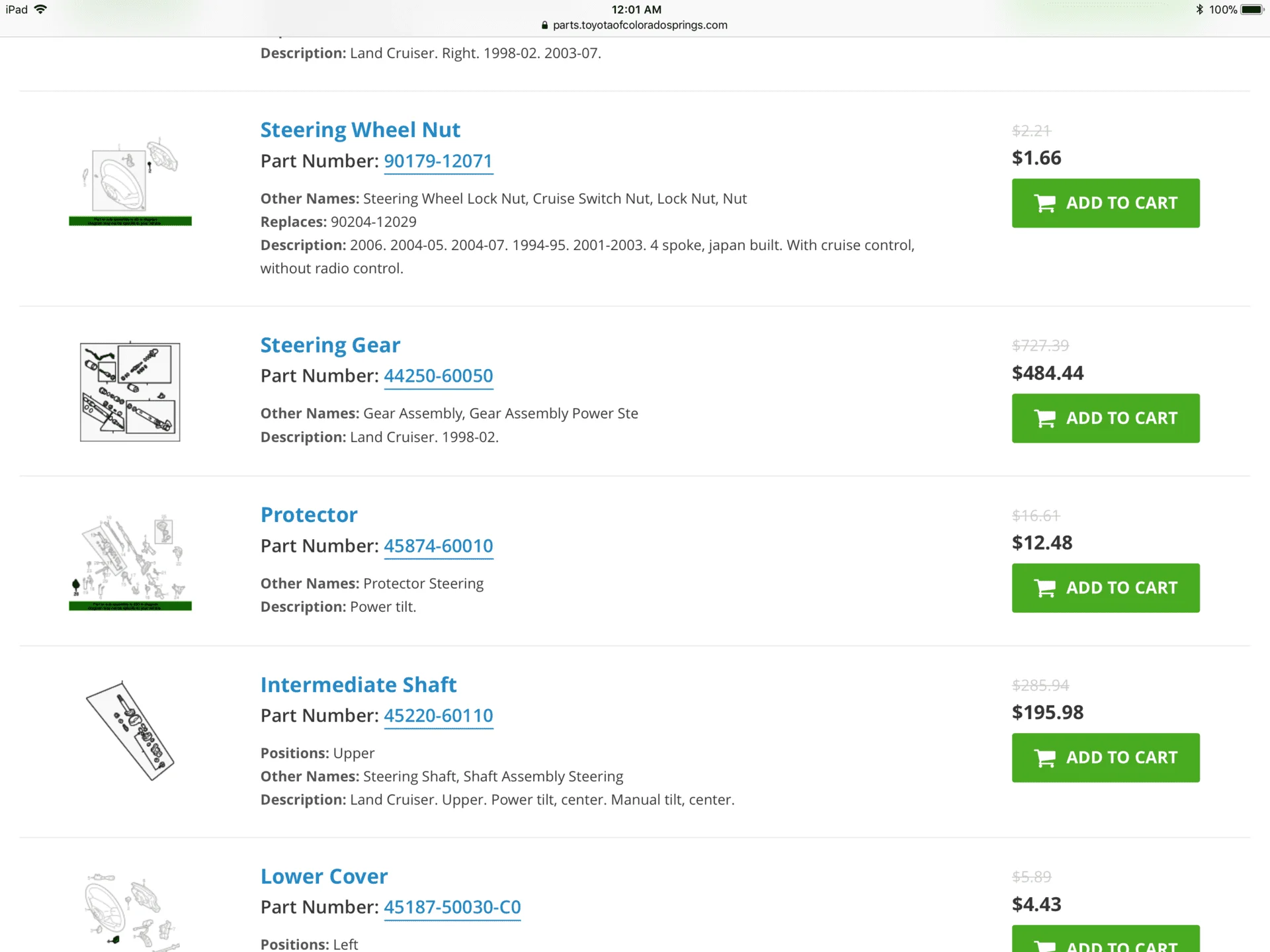

Man I'm showing 756 bucks for the steering rack from Larry Miller toyota..??
Any insight on the 484 dollar rack?
Love to score that deal.. Thanks for any insight...
