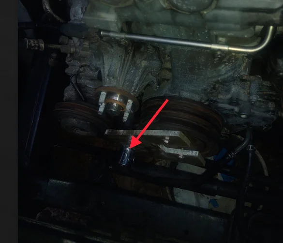

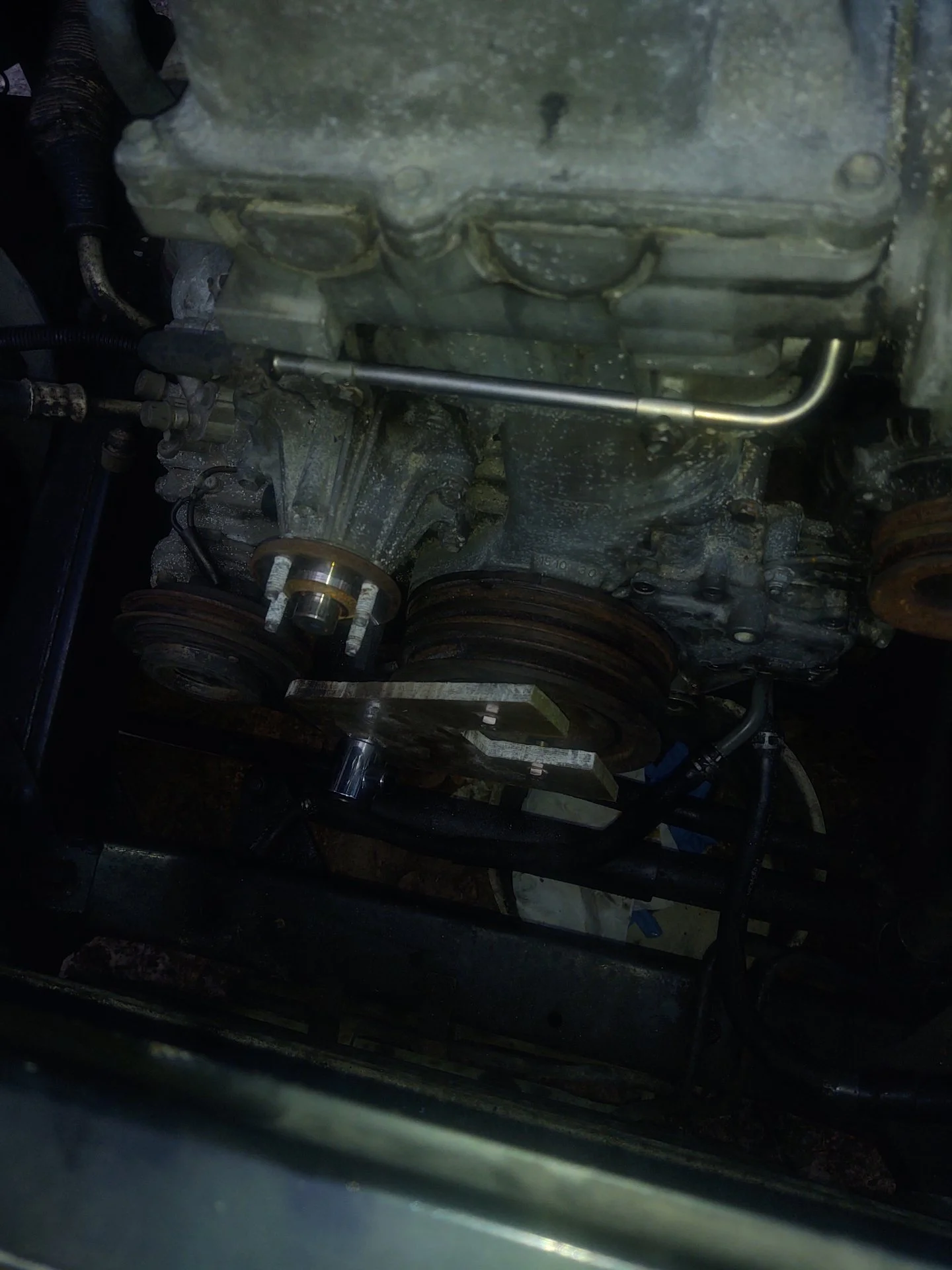

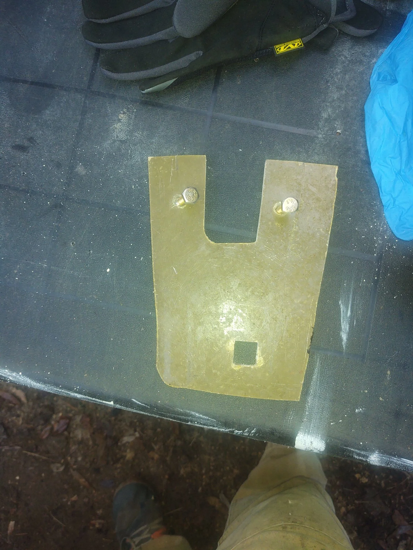

I just did mine today. I made a plate to hold the harmonic balancer out if a 1/2" sheet of fiberglass. Worked great.
Ingenious dude 👍

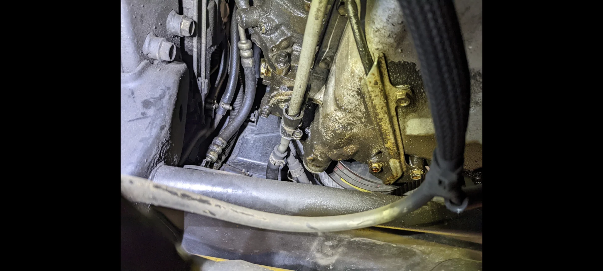

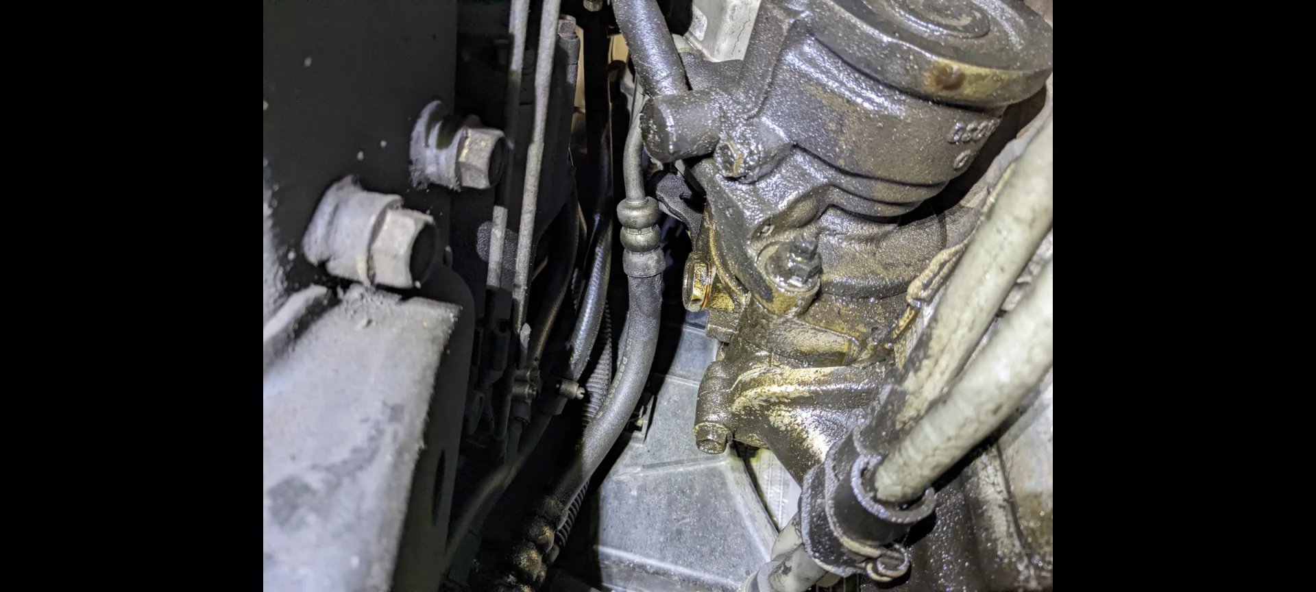

Last year I did all the normal oil leak stuff.
I am suspecting my timing chain cover and or upper oil pan front saddle.
I've read a few other threads. I'll plan to degrease and spray the sheen and dirt off, come back to it watching very carefully where it starts from again.
I also suspect the power steering pump o-ring to block seal. I have a spare seal once clean I might swap that out and then keep an eye on it.
The strange thing on this oil leak is that they're also seems to be oil over on my power steering high pressure line but my crankshaft pulley is dry so the main seal is not slinging grease around the engine bay.
Any ideas?

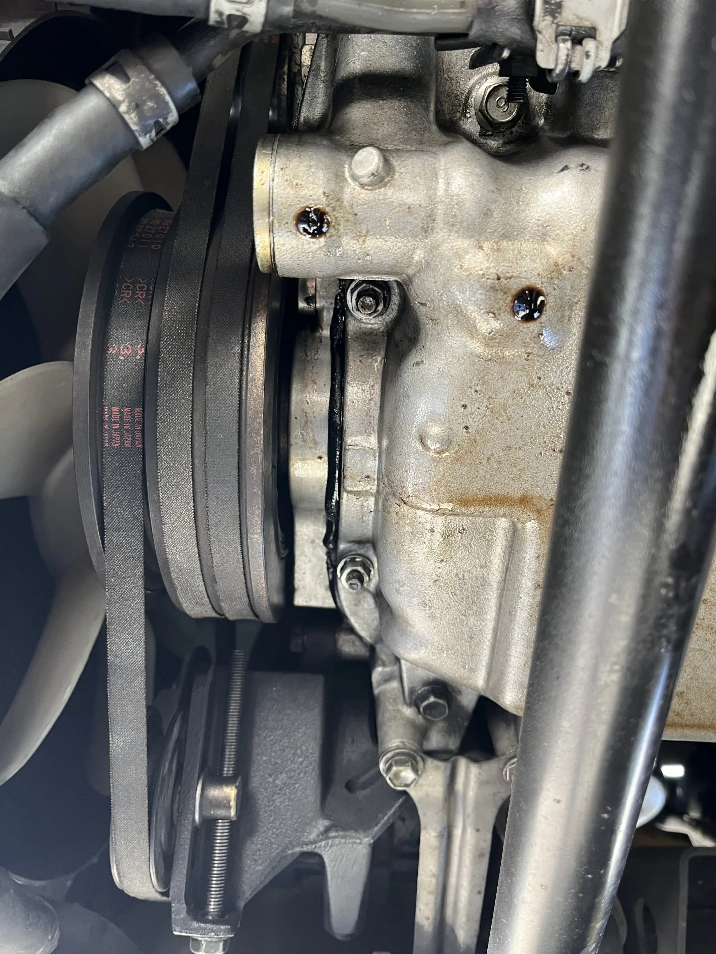

Hello, I still monitor this thread. You may want to check the seal around the crankshaft position sensor. It is located on the bottom front of the upper oil pan. Mine was leaking and I just replaced it this weekend. Haven’t uploaded the video yet, but it’s pretty straight forward and you won’t lose your oil if you pull that sensor out. Only issue is they do not sell the oring for the CPS by its self. I got a 19mm (measured on the ID) x 2.4MM thick oring from O’Reily’s Auto Parts and it fit the relief on the oil pan sealing surface nicely. You can stick it there while putting the sensor back in with some dabs of axle grease. 10 min job if you have the new oring.

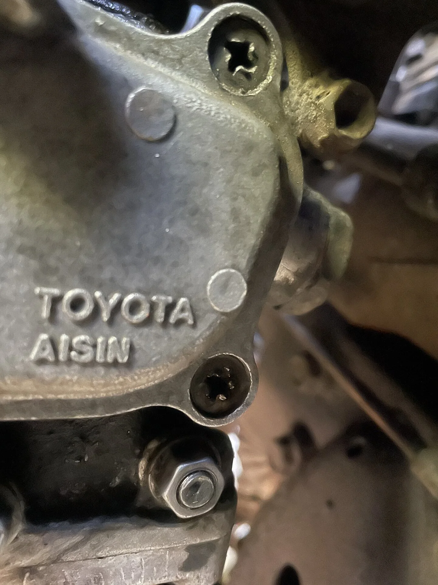

RTH on this one - I've got the balancer off no bother and the front main seal replaced just fine.

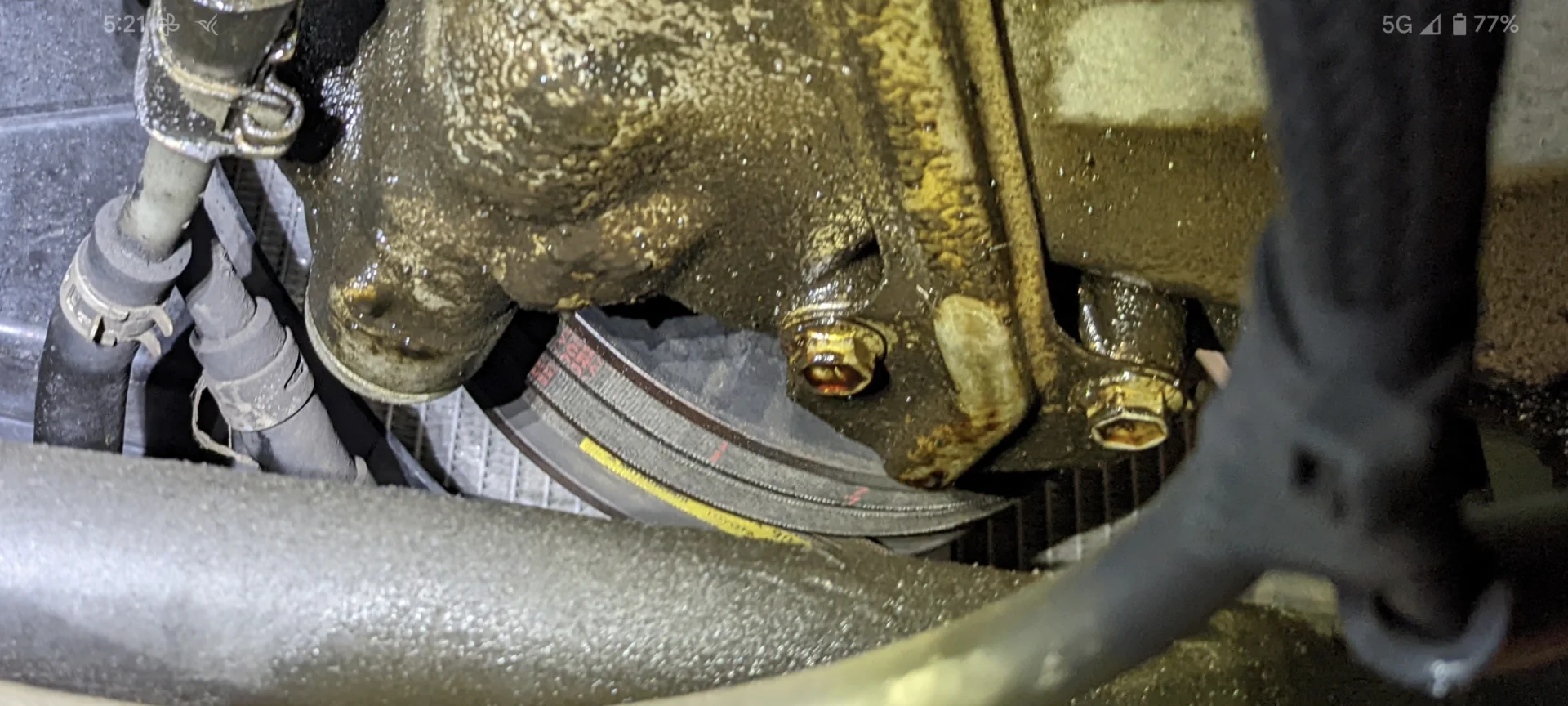

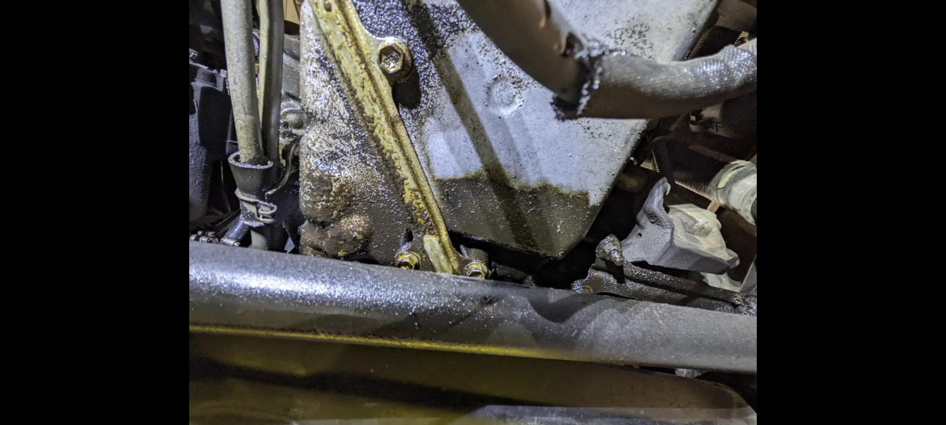

But the screws on the oil pump cover are stripping out - someone had been in there before me as 3/7 looks pretty roasted already and it feels like they may have used some heavy duty thread lock or torqued them up to ingersol rand torque spec - there is no sign of any of the 7 even budging. Most of the heads are mauled at this point. Not a single screw has come out despite being as careful as I could and tried all the usual hints - tapped in a #3 JIS bits etc and it still just cams out/ mauls the screw.
I've also tried drilling out one screw top left and using an easy out from the top with a 90 degree drill - but no joy - the bolt extractor won't bite at all - just spins in the screw.
They are holding hard enough I've actually checked to see if they were spot welded in place !
Anyone got any suggestions for next steps or is it pull the radiator and front facia for better access and get in from the front ?
I'd rather do 100 PHH jobs than try this one again - I need it back on the road by Monday morning.
Pics of the carnage below.
I guess the other option is put it all back together and pretend I didn't notice that it's leaking like the Exxon Valdez......
We have all be there, I would normally suggest Joey Wits End @NLXTACY jis bits but your pretty well done. I'll get these beds regardless to prevent future stripping of threads and heads down the road.
I did all this a few years ago and in hind sight I wish I would have pulled the head, oil pans, timing cover, radiator and just baselines doing it all at once.
I learned the hard way in and out in and out and got bit on a head gasket and had to do it all again anyway.
Anyway I don't know the history of your truck or the previous owner but yes pulling the radiator will give you more room, if you're not going to baseline the whole unit you can gently drill out or use easy outs with a little propane heat, careful now go slow.

Funny you could mention it - all sitting on the shelf waiting to go on if I can get the screws out :D
The second pic is the screw's I've not touched yet - all I did was give them a scrub with gunk degreaser.
I've had the truck 10 ish years - previous history completely unknown but the the owners partner was a "home mechanic" and I've found quite a few issues as I've worked through everything.
so with the head already mauled up- you may have to drill them out. Use a left hand drill bit, not the home depot drill bit sitting on your shelf. A TRUE LEFT HAND DRILL BIT AND SET THE DRILL TO SPIN TO THE LEFT.
not sure if you have access to a small welder but i would try to tack a bead next if the drilling out does work and try to get them out. take your time.
