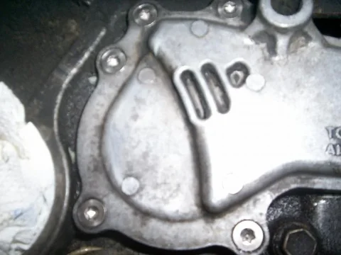

Hey guys, I am getting ready to tackle this mini job, just gots quick question. I just ordered all the gaskets/seals and was wondering if there was a o-ring or a gasket in this location. I have a pic I stoled from timer00 of the area I am talking about. It's on the # 1 oil pan:
It looks like oil is leaking from that large plug because the oil from the oil pump cover dribbles down and drips off from it. No gasket or O-ring to replace there.
x2. IIRC, there's an aluminum or copper crush washer behind the plug you're referring to.
Well I have driven 15-20 miles now and have been leak free as far as I can tell.. I cleaned off the residual that squeezed out initially and am driving the truck today so will be able to tell if there is any more seep. The oil galley plug looks to be leaking as Kernal said because the residual oil that squeezed out of the oil pump cover area covers that area in oil when its leaking and its hard to soak it up from the "groove" area where that plug is.

So, is there a gasket behind that large hex plug? I've got leaks from the same areas on both my 80's and want to order all the appropriate parts.
Wait and see....
I just did this job two weeks ago. This thread was CRUCIAL to my success. Thanks for all the info everybody put into this DIY GUIDE. My engine looked far worse than these pix. My suggestion is wait until after you replace your oil cover gasket and front main seal before you even think of opening that plug. You will most likely find that you have resolved your leaks without going deeper than you need to. My project was super smooth, but go into this with the expectation of stripping a cover screw. Be prepared and take your time.
