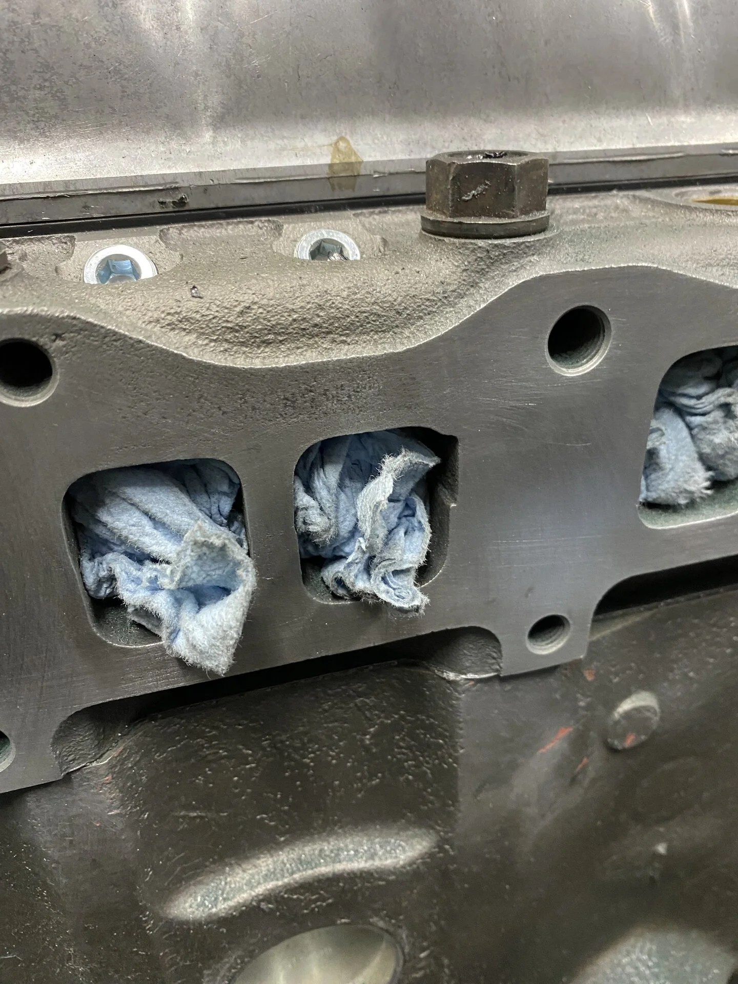

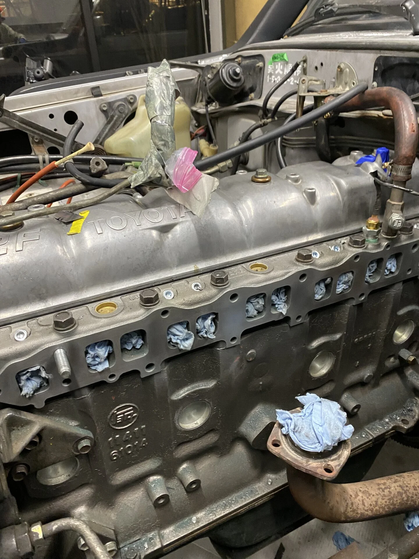

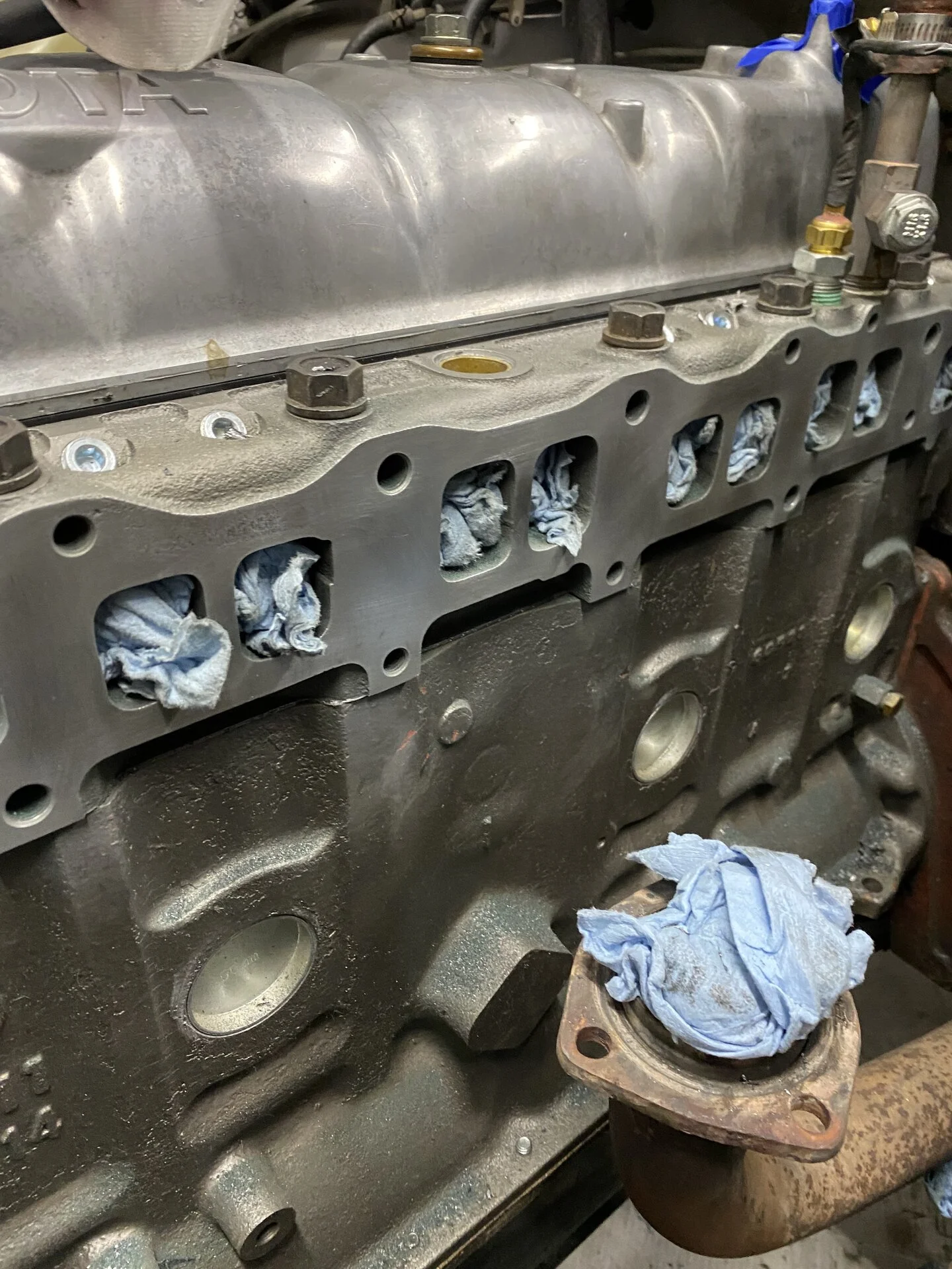

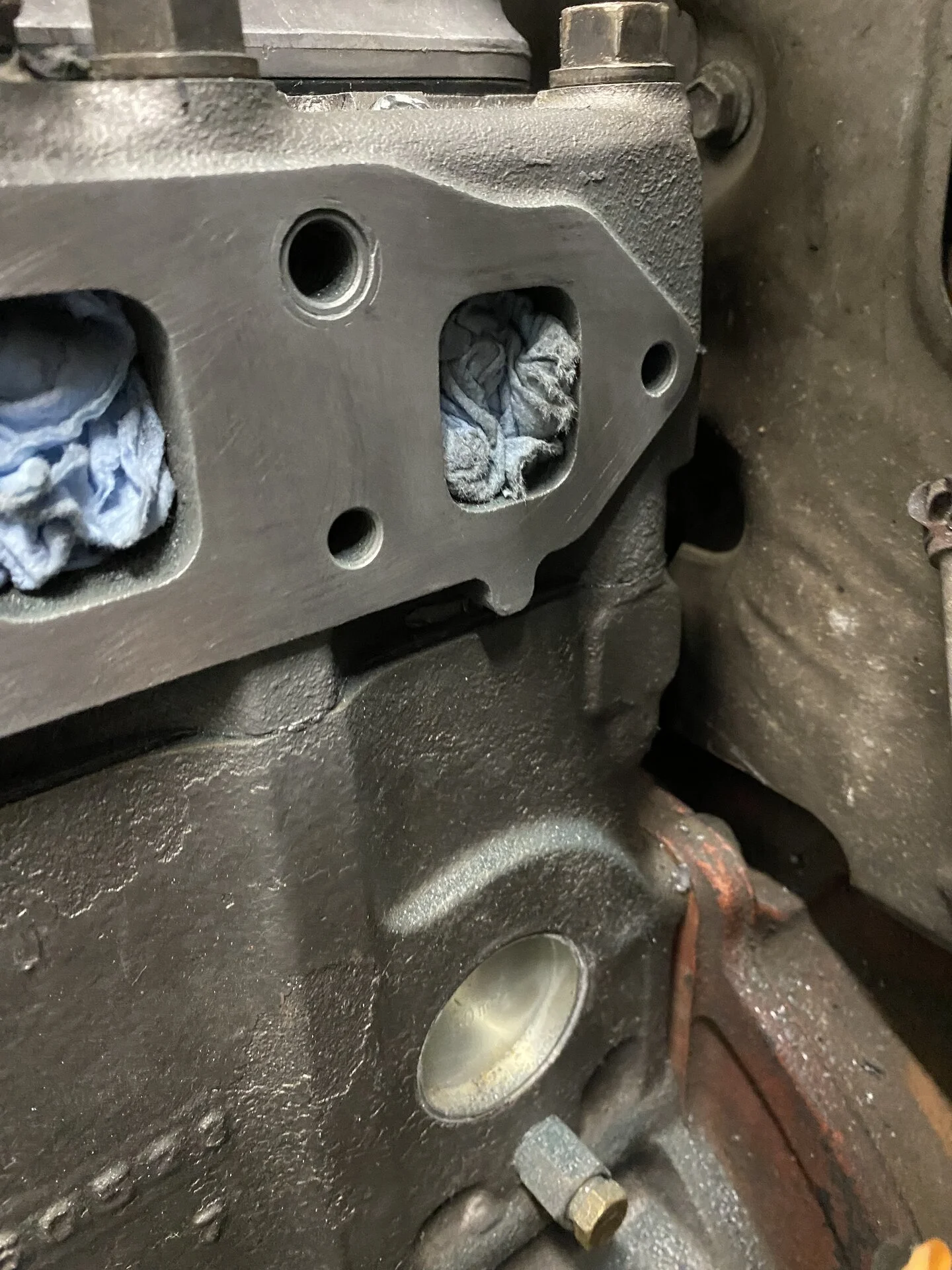

Did I go a little overboard? Starting to see some metal casting or something underneath (see first picture) it must’ve been like that post machine shop and I didn’t remember is a possibility as well.
So the question: how does it look?!

That is about 3x’s as clean as I’ve ever cleaned mine. Looks great. It’ll seal just fine. After I did the remflex I never had another leak at that location.
A bit of advice when tightening the manifold to exhaust pipe with the donut gasket; tighten them slowly and in succession. Don’t crank one fully tight and move onto the next. Try and get them tight evenly. That particular spot is a problem leaker on my truck and I’ve found that it’s very easy to damage the collapsible donut gasket and it’ll leak.
