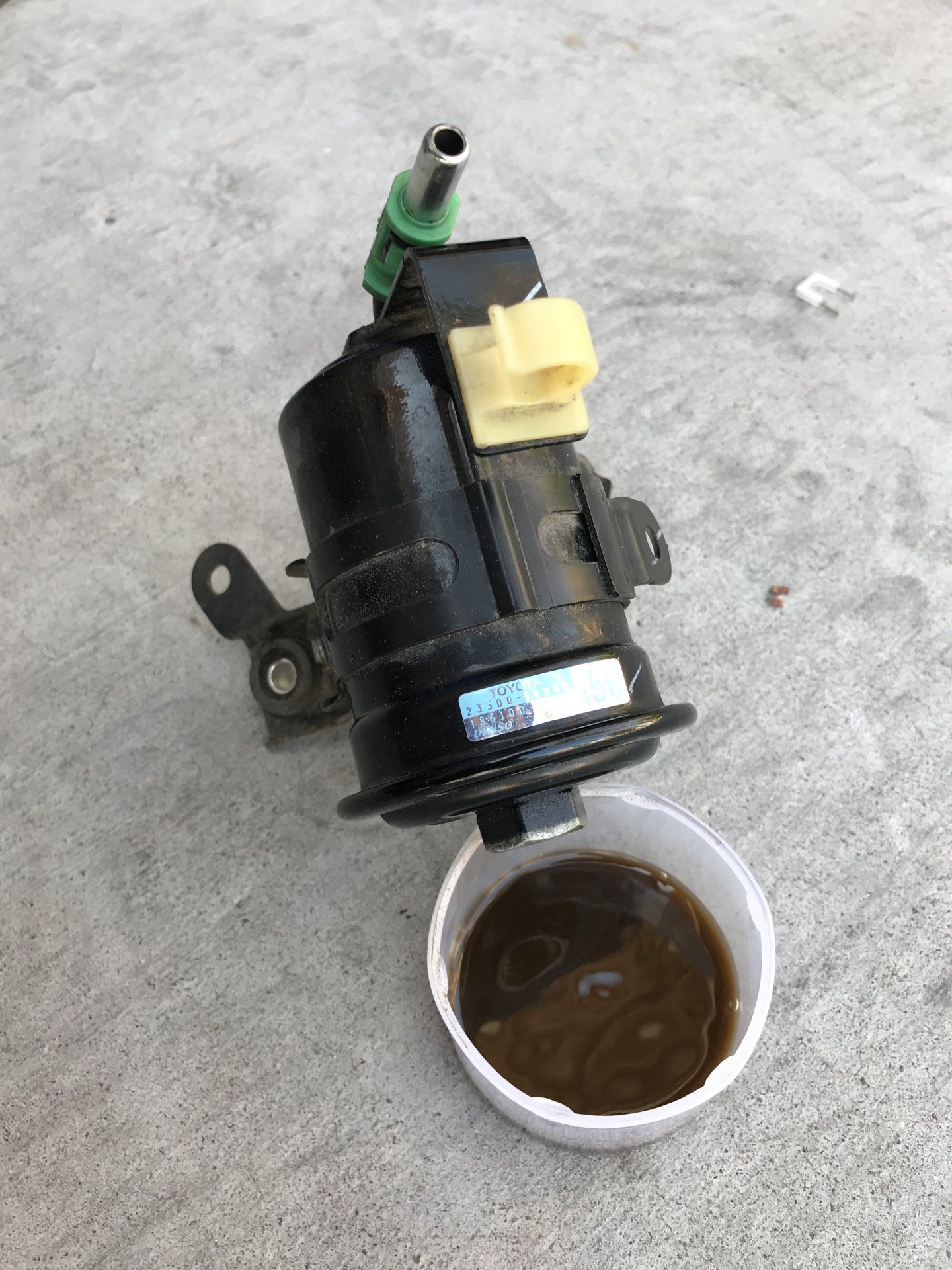

Just completed this fuel filter replacement project yesterday. Going in the appeal to me was that it such a low cost maintenance item ($35 or so - which is gold compared to most other jobs (06 LX)) and seemingly pretty easy for a novice. I considered responses that it is not a required item (and a mechanic that stated the same) but something about that didn't ring true to me. My rig has had a few prior owners and I have no idea if it's been done before, quality of gas used, etc...plus just curious and with more time on my hands these days during pandemic.
I am writing this post for fellow novice owners mechanics because my first attempt a couple of weeks ago ended in frustration as I failed to loosen the hard line nut and stopped as I was afraid of damaging it. Did not use a 14mm flare nut wrench (used a reg flat one) - wish I had, as I rounded the nut a bit. After reading this thread and regrouping, I re-attempted and it took about 30min all in. A couple of tips that I felt worked were (1) using a cloth tied around the exposed threat soaked w PB Blaster and letting it sit for a while, and (2) good pair of vise grips with a counter-balancing crescent wrench on the 19mm welded nut on the filter. As long as you go slow and purposefully, it's an easy project (with right tools and MUD advice stated above!). Definitely pack some rags underneath old filter as you remove it to catch spare fuel. Car restarted easily (after leaving it in the mid-cycle start for a bit to re-pressurize).
All in, glad I attempted it - below is a pic of the gas that left the old filter from the engine-end...brown color and plenty of bits that I would not want flowing through the system. I plan on giving the tank a "cold one" (Techron cleaner treatment) this week to celebrate the job.
