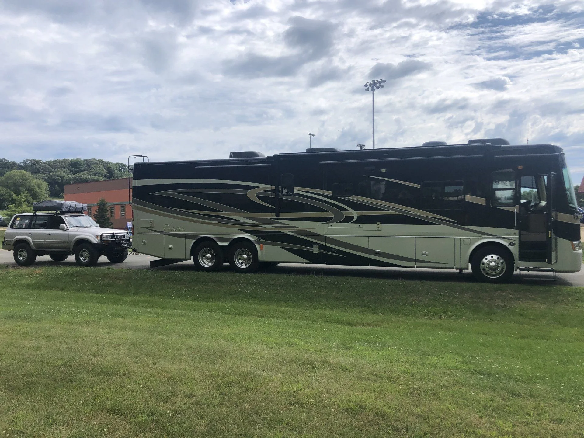

Update. SENECA sold, along with our house and the majority of our stuff. EXCEPTION, we kept 4 Landcruiser’s. We were able to get into a Tiffin Phaeton with Cummins. Seneca handled the LX pretty good... The new rig does even better. We are currently in OKC and will be spending December in Dallas. Then we tour the South West. KOH, Rubicon are on the list for 2021.... #****someday. We go now.

Not sure if I have posted this one or not, but it's maybe the 6 one I've flat-towed? I am a fulltimer, so I drive it this way weekly.
