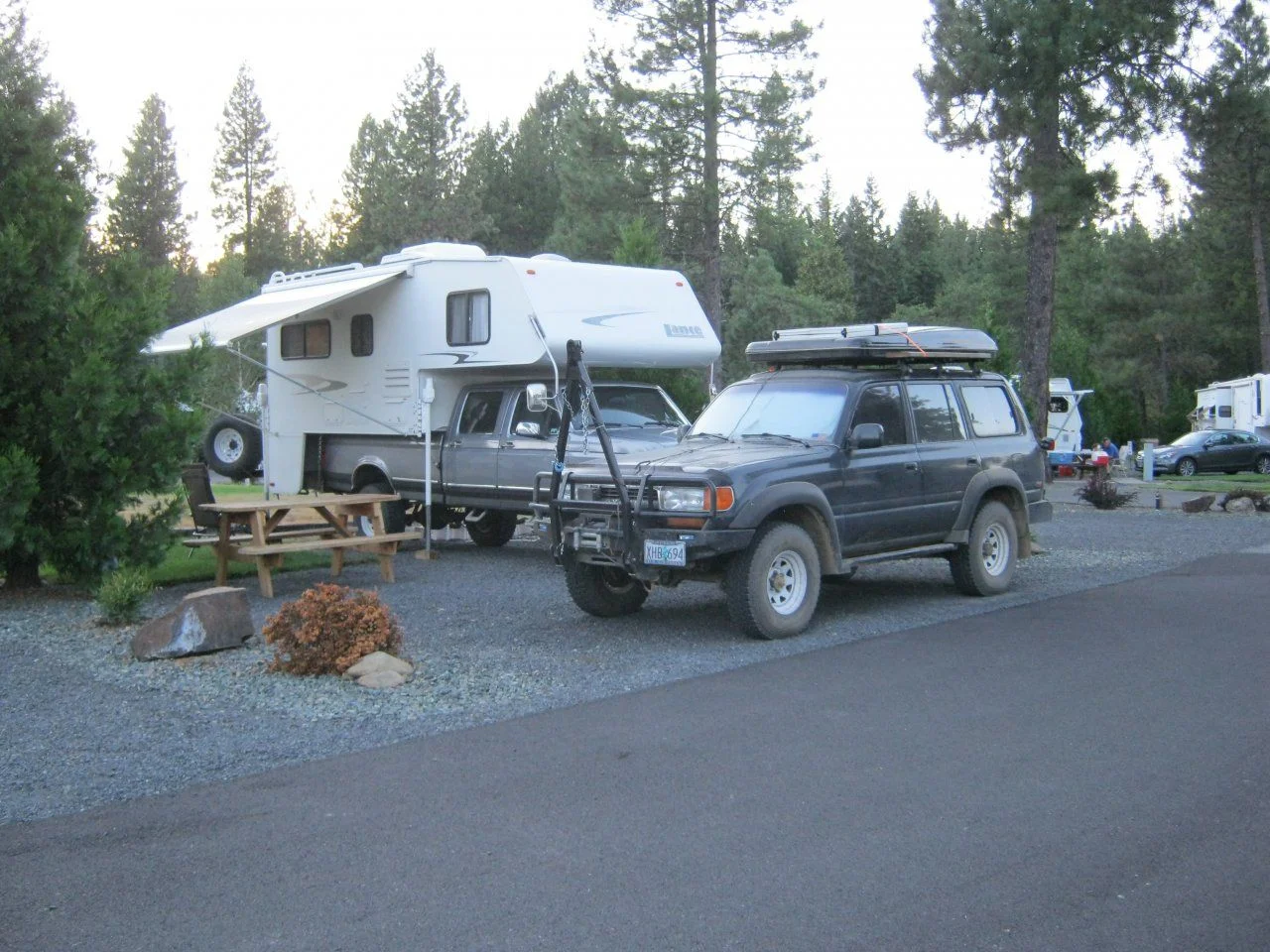

One note I'd like to add, make sure the towbar is long enough. I've had to put in a 8" extension for the receiver on. Each RV is different, and mine happens to not only have a tight (for 40') turning radius, but the hitch is somewhat inset as compared to the rear cap.

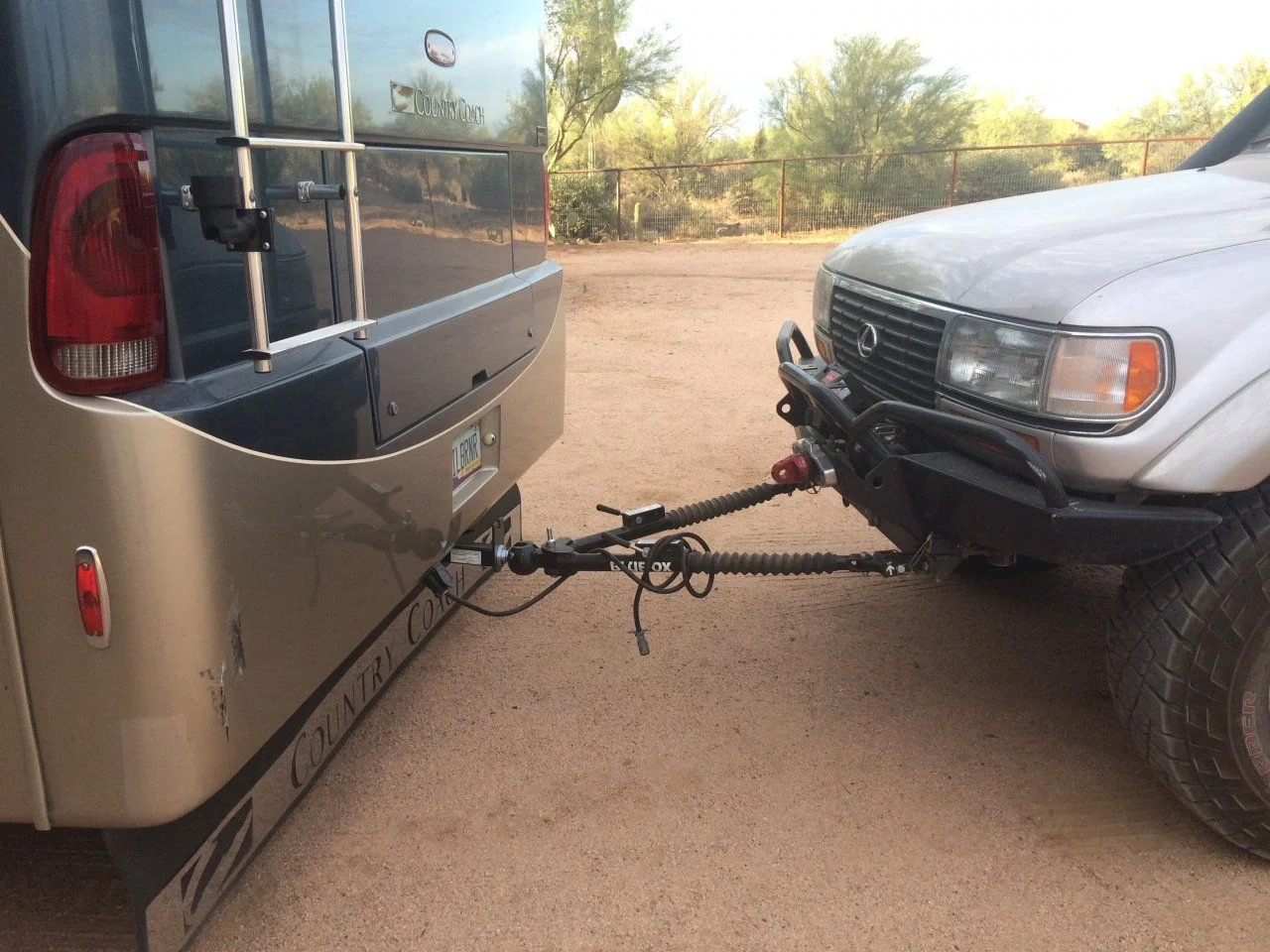

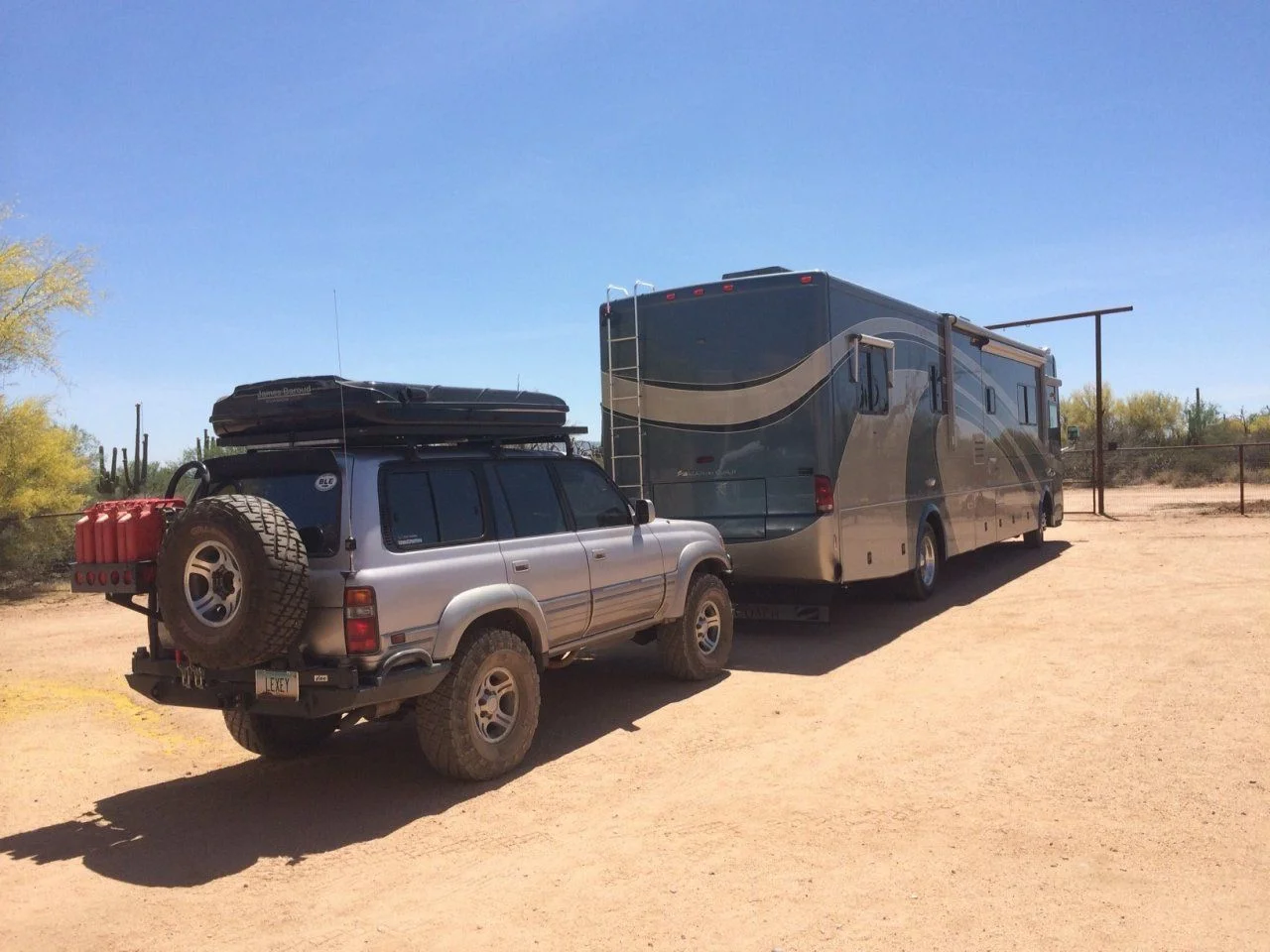

Wow your towbar looks short and also where it attaches makes it even shorter with your bumper overhang! Mine measures 57" from pins to ball. Pic of mine:

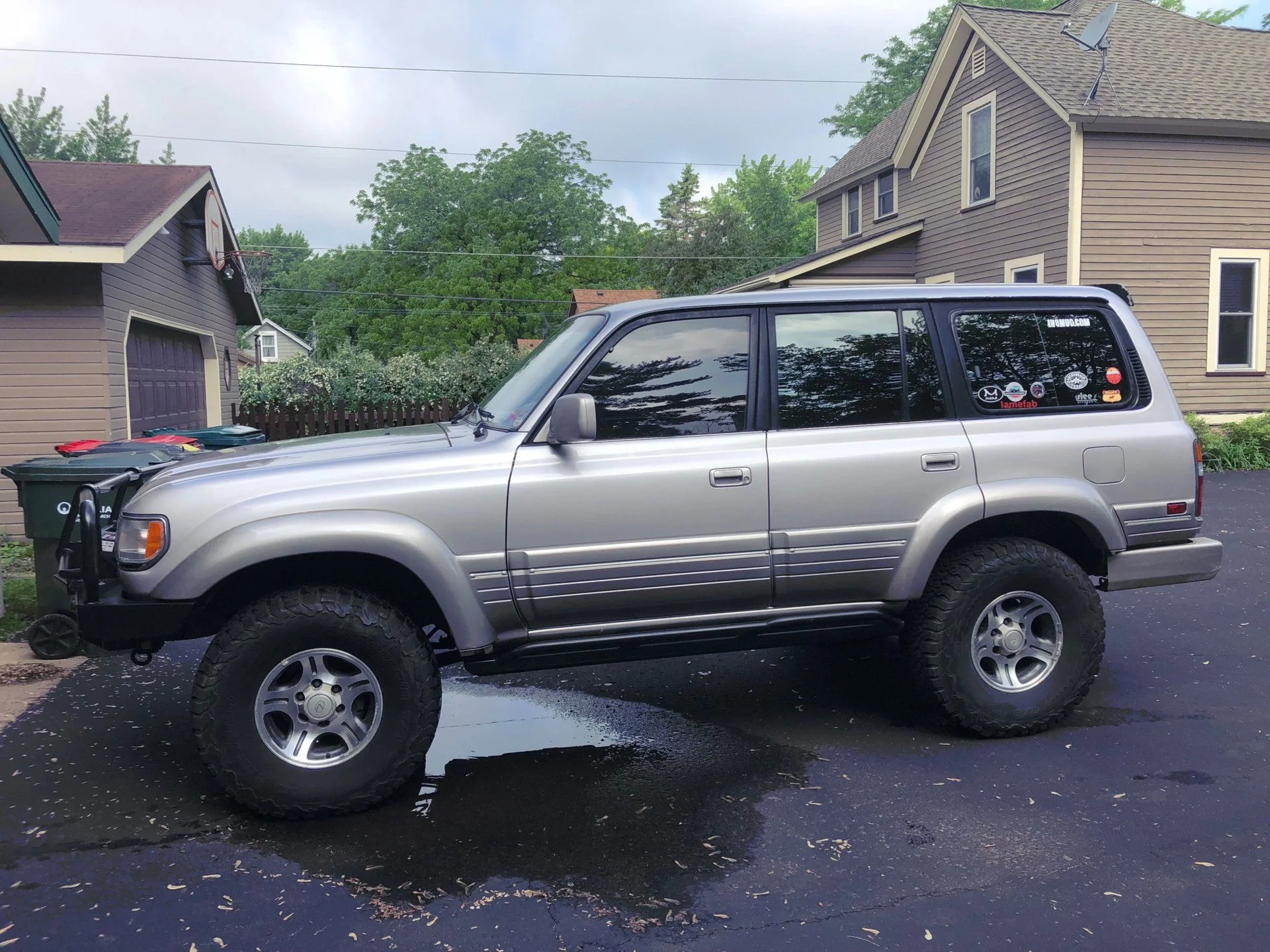

Great info here. So i took the plunge. I went with the InvisiBrake by Roadmaster, 10K Blue OX bar and ARB modified front bumper via LAME Fab. Took it out for a short 200 miles test drive this weekend. Love the setup, its hard to tell its back there.. I will add air sensors to the toad and thats about it. We have a trip up to Grand Marais Mn in a couple weeks and its nice to know i can leave the damn car trailer at home! Very happy with this setup.
Nice looking set-up! Safe travels!
Looks good. What year is that Kodiak?

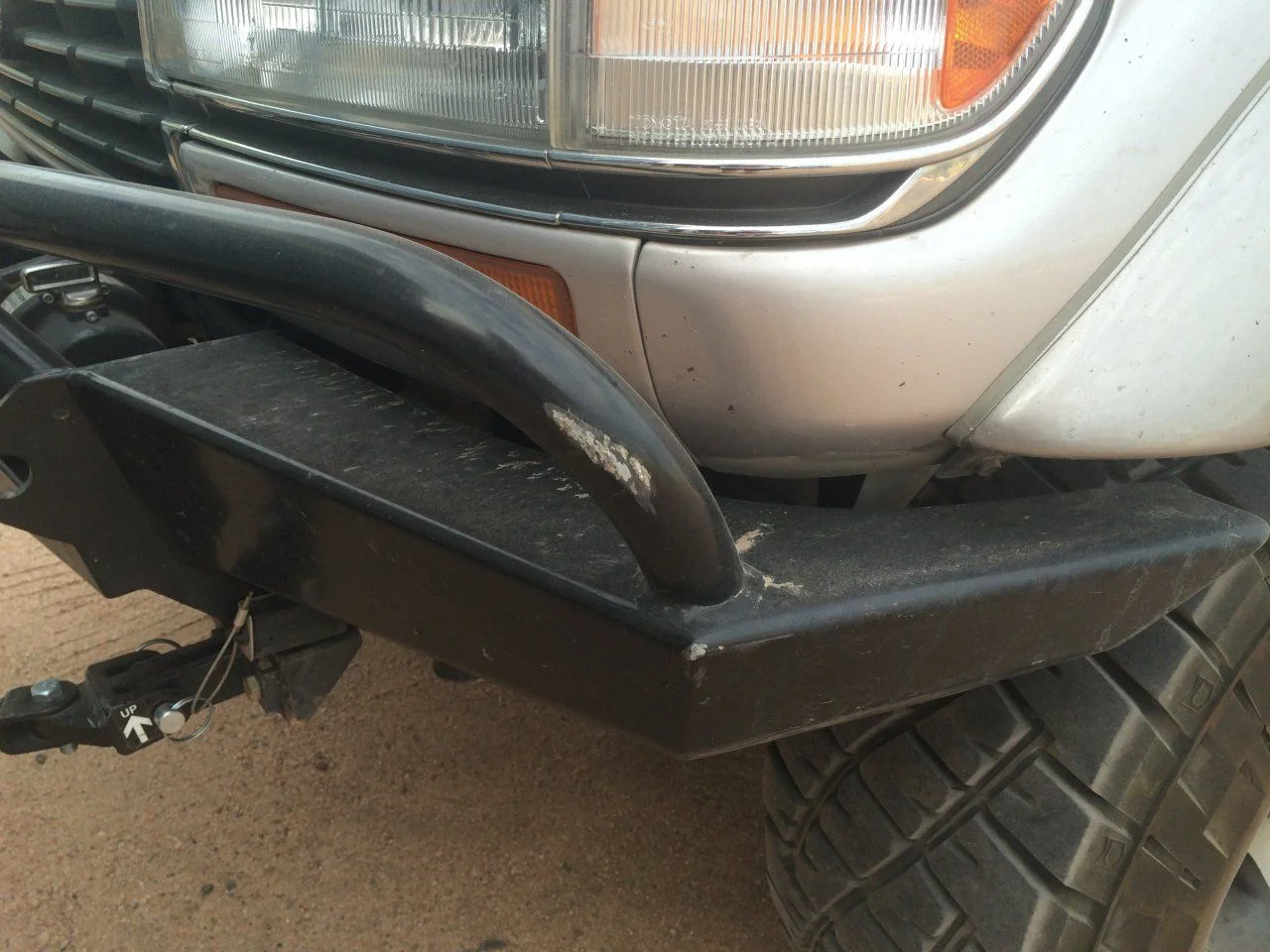

What mods on the ARB, or are you just using 7/8" bumper plate adapters on the stock ring mounts?

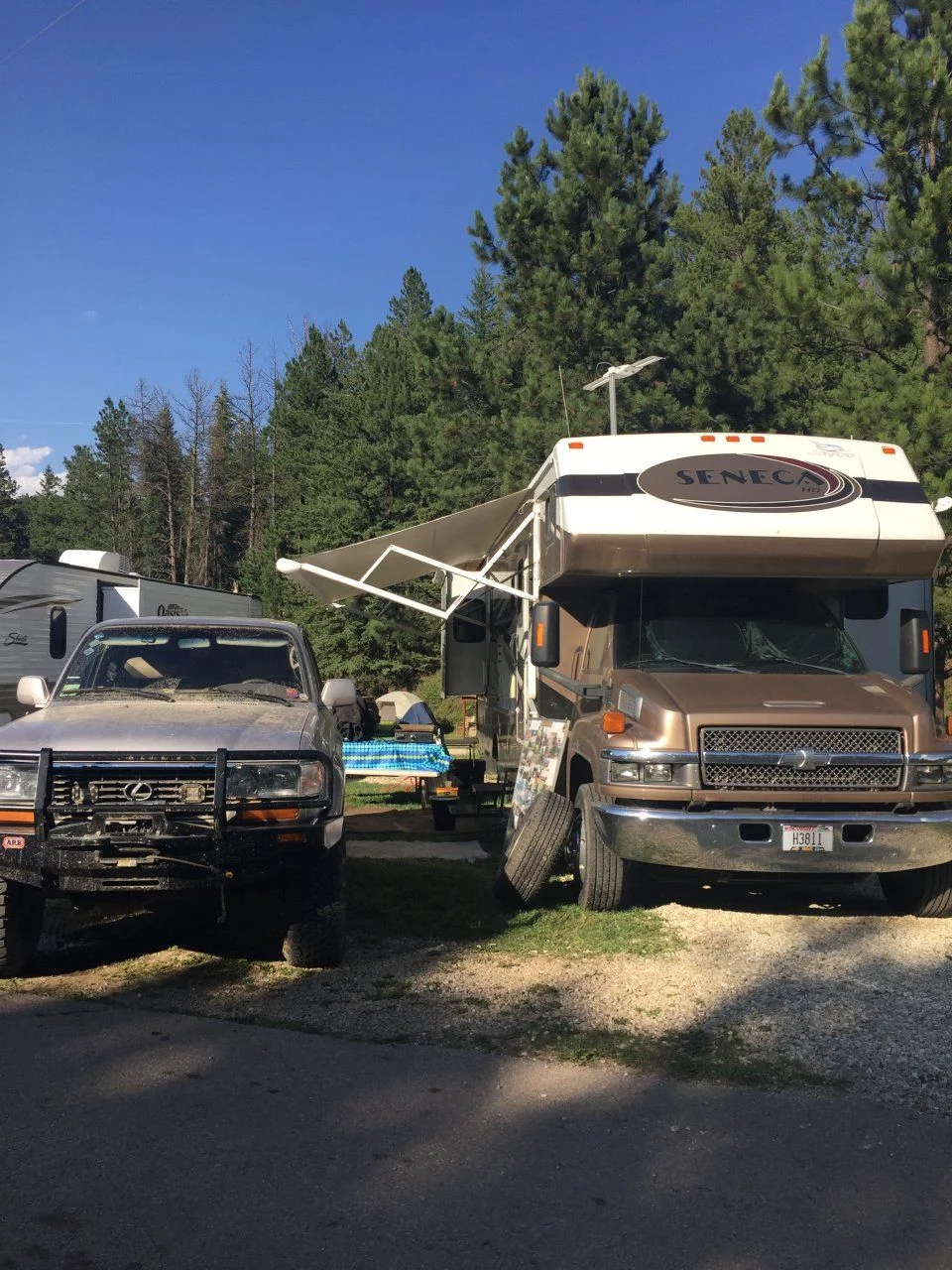

Thanks guys, sorry about the very delayed reply. I came back around to this thread to ask about MPG while flat towing the 80. Ill answer your questions first
The Seneca is a 2006, we are in our 3rd season with it and love it. We full time it in the Winters in Texas and travel the Midwest in the summer. Home base is Hudson Wi. Near St Paul. The only mod on the ARB is the pull points were modified to accept the Blue Ox pins.

Any chance you can take a close up picture of the pull tab and pins?

Yes, can do that today and post up.
Here is what i found on the Interwebs Blue OX tow bar pins - Yahoo Image Search Results

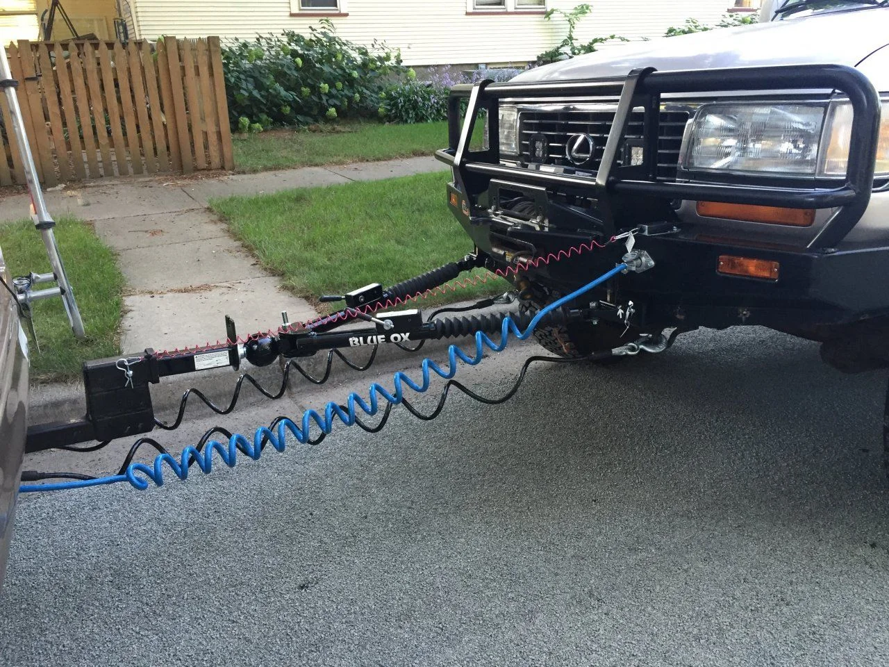

Last, I bent my receiver hitch last year on a nasty bump. I always thought it was too long.. I carry a spare so i was able to keep rolling. I had the bent one shortened and i like it much better now. I can update the pic the next time i flat tow. Looking at the pic it reminded me how long that damn thing was...
Here are a couple shots of the modified ARB. And one gratuitous glam shot. I had the bumper sand blasted and re powder coated last year. the pull points need some touch up. That said ive put 8K miles on with that new powder coat, so its held well i think,
@SHREG Do you have any pics of the invisibrake installation or installed? Curious where you mounted the air cylinder and how you routed the cable. Also wondering what you did for the pulley mount. Did you encounter any problems that needed to be addressed?

Sorry, its been some time since i have looked back at this. Let me know if you still need info on this. Setup is still going strong. Zero issues.
