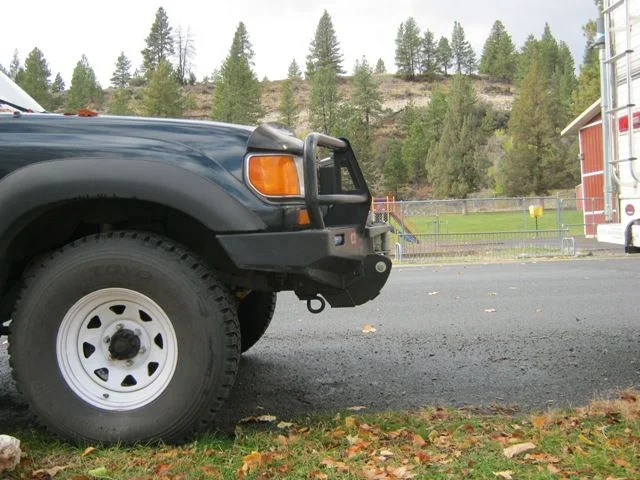

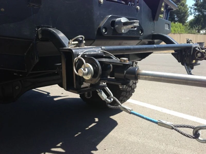

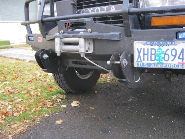

Just found this thread today. Good reading and thanks for keeping it updated. Wish I'd seen it earlier. Started flat towing my 80 with my RV setup, F250 with slide in camper. Had my local welding shop fab a tow bar and mounts for my ARB. Believing I needed to disco drive shafts, I've made one 600 mile+ round trip doing just that. Re-attach them at destination to use the 80, then disco for the tow home and re-attach again at home. The T/C neutral trick will save a bunch of inconvenience. Just for grins here's some pics of my ARB tow bar mount. It's made so I can just push up the tow bar and tie it to ARB for convenience if wanted. They look kind of awkward IMO, but I realized that they provide some protection for the winch fairlead :rolleyes: Not to mention, an excellent point to use my Hi-Lift jack, if necessary on the trail.

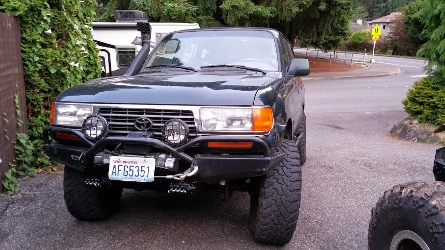

flat-towed my latest 80 tonight! The trick is making sure castor is dialed in...

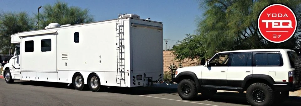

Just found this thread today. Good reading and thanks for keeping it updated. Wish I'd seen it earlier. Started flat towing my 80 with my RV setup, F250 with slide in camper. Had my local welding shop fab a tow bar and mounts for my ARB. Believing I needed to disco drive shafts, I've made one 600 mile+ round trip doing just that. Re-attach them at destination to use the 80, then disco for the tow home and re-attach again at home. The T/C neutral trick will save a bunch of inconvenience. Just for grins here's some pics of my ARB tow bar mount. It's made so I can just push up the tow bar and tie it to ARB for convenience if wanted. They look kind of awkward IMO, but I realized that they provide some protection for the winch fairlead :rolleyes: And, of course, a pic of the rear of my tow rig.
Where is your hitch? is the Base Plate location on your 80 lower than the hitch or higher. If Higher, you risk the 80 launching up into your camper if you hit something or brake really hard. Also what are you using to assist with braking?

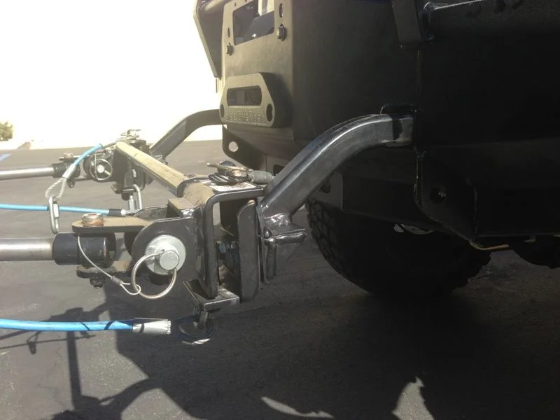

Just had this done a couple of weeks ago here in Phoenix. Also Air Force One installed. Tows great.
The shop that did it has an extensive history making all sorts of custom towing configuration and is a Blue Ox dealer. One the installer looked at the Short Bus, he said it was an easy fab. The wiring and brake system took way more time than the baseplate.
I was worried about a possible height issue between the coach and the plate. I have a 2.5" OME and 315's, but as luck would have it, things where perfect.
The baseplate would be easy to reproduce for the Slee SB and would only need three new holes in the underside leading edge. The remaining four bolts utilize the factory frame rail holes that the SB uses.

Sorry, I just saw your post! I'm on my way to CM checking mud at Green River, UT Shady Acres CG. The 80 tow bar is almost perfectly level when hooked up. I'm using a Brake Buddy to assist with braking. Works rather well, however you'll want an aux battery to run it (I'm glad I have one for my winch & Nat. Luna reefer/freezer). The BB works with an air compressor and uses the "juice" to do the braking. Hope to see you at CM!

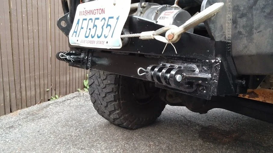

It cost quite a bit more to get the 10,000lb baseplates. I took them down to the local hitch place here and they welded a piece of angle to the bumper, then welded the base plates to that. It really came out pretty good. Going to test it out here in a week. We are moving 2000 miles away from Seattle and will flat tow the 80 (loaded full of boxes).
Towed the lifted 80 2000 miles to my new house without issue! Love being able to flat tow these bad boys. Video coming soon!
pictures of the 10,000lb base plates (overkill)

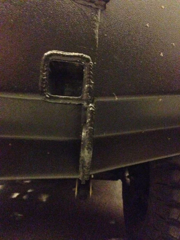

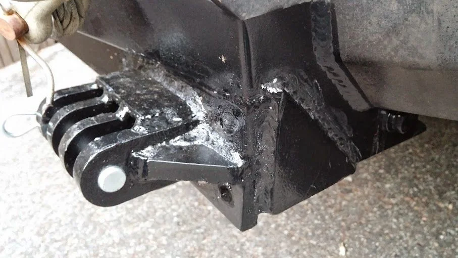

So I guess I owe you a thank you and Señor Christo (I called him, I need to hear it for myself especially how everyone was telling me it couldn't be done) and then the search was on for parts. I was lucky and found a RoadMaster Blackhawk 10,000LBS towbar on Craigslist ($170) complete with draw bars. After that it was time to get out the plasma and start cutting. As you can see by the photos I made 2 cut outs in the front and welded square tubing to the bumper. Since I use synthetic winch line I cut off the supports used for the roller fairlead and had the bumper re-powder coated in my black wrinkle finish.
Super happy with the setup, Thanks again
