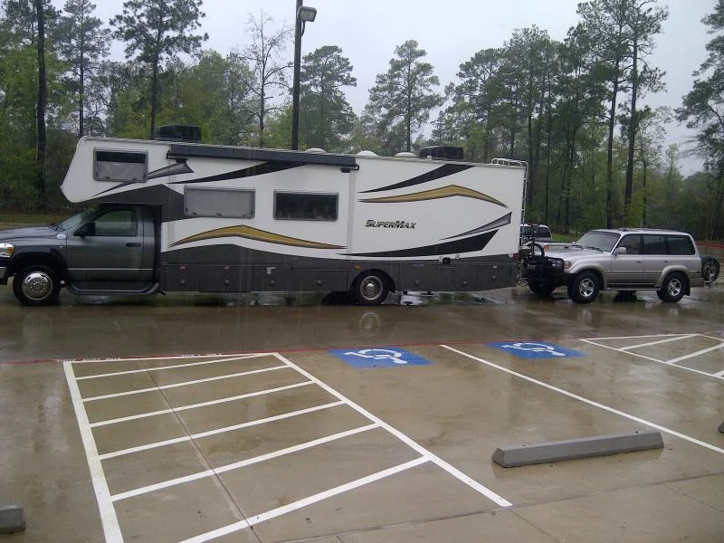

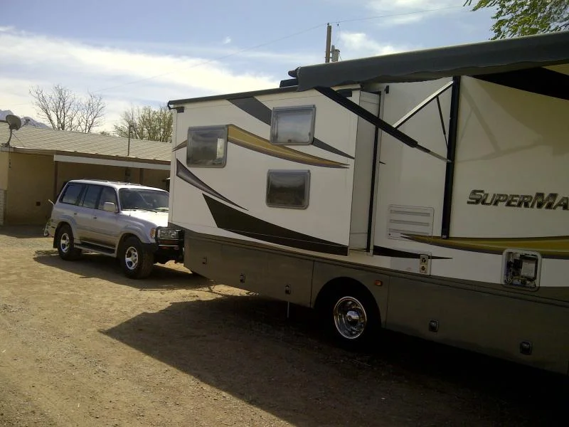

We have now gone 6,000 miles. Charlotte, NC (I think, can't keep up). We stopped at a sketchy walmart last night didn't sleep well..... only fear was someone unbolting the bumper making my rig untowable. I need to find someone with a welder along the way that can spotweld it to the bumper. I'll bring the beer... hit me up. We are headed to Chatnoooooga TN next, after greensville?... then down to Atlanta. PM me or post if you can hook me up with some spots!
All towing points are really holding up. Torqued the 15k hitch bolts down, they weren't loose, but I torqued them 3lbs over just to make sure, checked the pin's rusty, chrome stripped off.... the tow points, no wear. Having lights out back is really really nice!

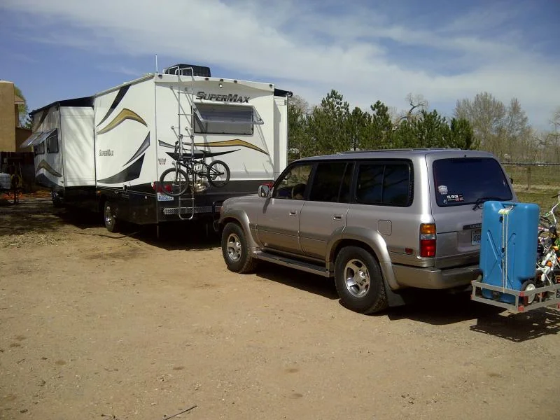

Here is a view from our Land Cruiser as it is pulled behind our Motorhome. You can see the reflection of the rig in the Solar Heater I built and stored on the rear bumper.

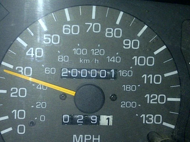

We are at 8,000 miles now. No issues. Our cruiser is stock and is at 192,000 miles now. No tranny change. Just a brief update!

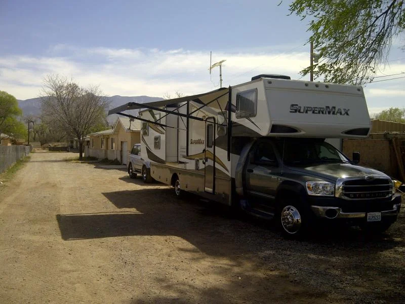

Finally Washed the Set.... We are leaving Abq. NM and heading for Flagstaff tonight, staying at a campground in the south rim of the Grand Canyon over the weekend. Everything is still working flawlessly on the 80. 192248 miles on the clock.

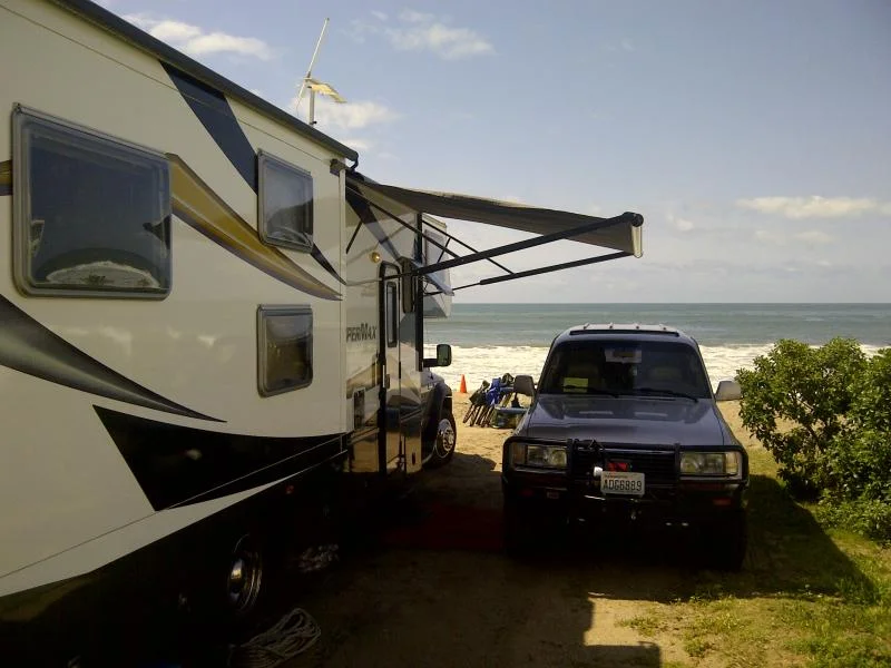

Greetings from San Clemente, San Onofre. We will be hangin out in Cali for a few more weeks!

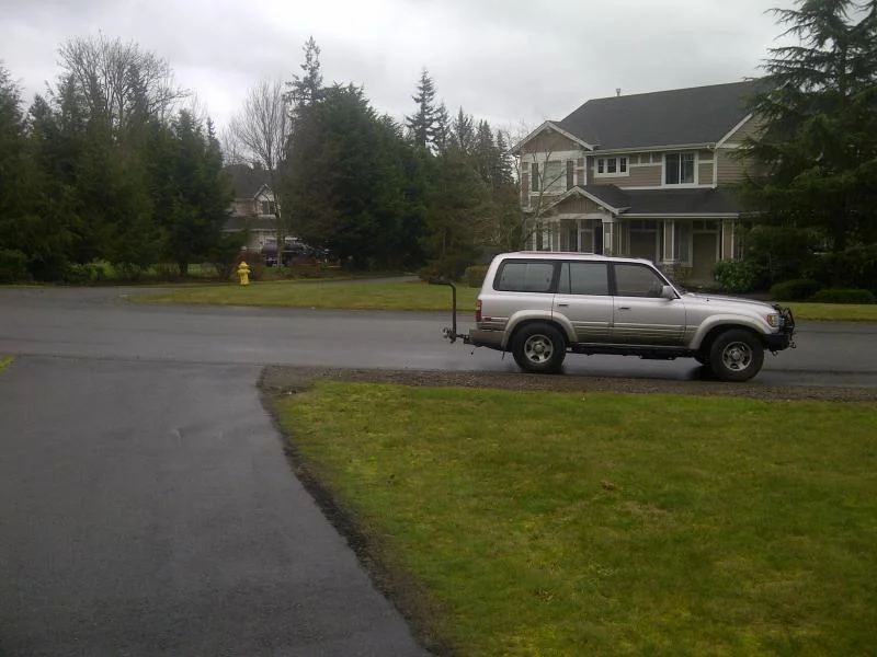

Flat towed to flat towing
When first researching the Flat tow before our lengthy trip, a gent pm'd me and said he used a tow bar and connected directly to his front bumper tow loops.
He said he ground down the loops so that the tow bar would connect.
Today I tested this and while he did it for 10k miles, I don't recommend this after testing today.
I pulled a 6,400lb rig with a 7200lb rig (check the GRVW on the door tag) after grinding down the loops about 1/7" on each side so the tow bar would fit, however you only utilize 2 of the 3 tow bar connecting points. There is also play.
I was able to get it up to 60 mph and it tracked good, but there was lots of slop unlike the 3 point connection.
Ideally, I'd suggest making a 2 pt receiver and removing the loops and attaching to that same location for better control.
I don't advise anyone try this and if you do, do it at your own risk and only for short distances and in emergencies. It does work, however by grinding the loops, you lose some of the strength of the loop. The arb or a connecting point at this location would be ideal... not the loops.

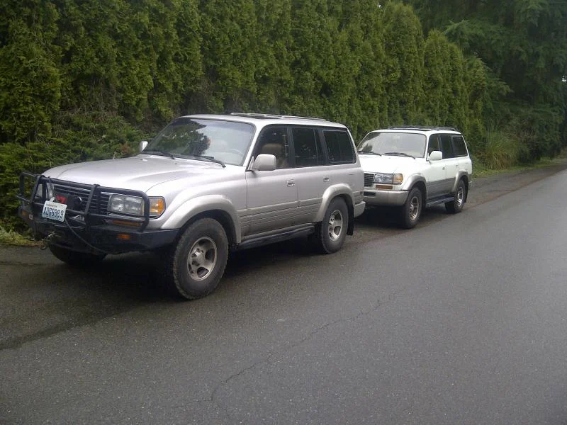

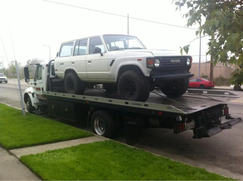

After flat-towing Lorena BobIt with the Tundra... it's now time for me to flat-tow Number 6 with Cramalot!
Here it is on an impromtu uhaul trailer since my tow-bar isn't yet setup.
I plan on setting up the towbar with the same equipment I used for Lorena a few years ago. Let's hope this stock suspension tracks good and needs no castor correction!

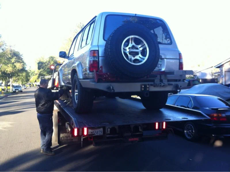

You guys are doing it wrong. Here's the only way I've managed to flat tow my LX. It works so well I've decided it's how to tow the 60 as well :flipoff2:
NLX- You're still doing it wrong! Put a base plate on that tow truck and you can flat tow 2 if your tow vehicle has the balls for it.
