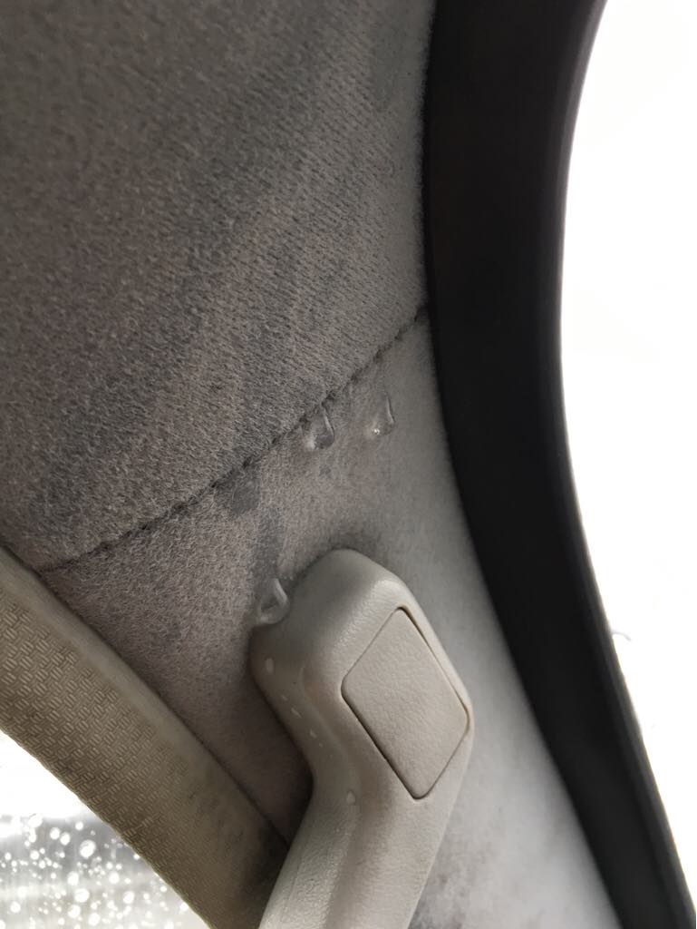

So I am trying this method with my 98 100 series. I've tried the flowable silicon just like OP and that didn't work for crap. I got the exact stuff op said and did it. Mine leaks from upper driver side corner. I've taken about the inside and ran water to see where it leaks. It actually leaks when water flows from roof down to right over where the driver side visor is, then pools in the corner. When it rains you can see a wet spot in the corner. It then flows down the A post and soaks the driver side carpet. When I'm driving in the rain I can feel the occasional drip on my left foot. So I am really hoping this works. I will find out Friday night as we are forecasted for 100% chance of rain!!

Well it didn't work for me. I had the exact product put it on yesterday and it rained this evening and the driver side upper corner is soaked and leaking down to the drivers floor. I'll take a look tomorrow in the daytime see if I missed a spot or something. I know where the leak is, I've troubleshot it and found where the water comes in. I sealed that spot and it didn't hold. Maybe it didn't have enough time to cure, not sure. Back to the drawing board.
Unfortunately I don't have the luxury of a garage that will fit the LC. Oh well we'll see what happen tomorrow. Maybe I'll have to pull the entire glass off and go from there. Never done it before but might as well learn.
