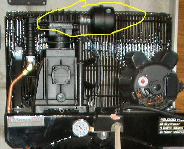

Seems like it would have come with this, but I got the compressor right off the showroom floor...
There's the problem right there! The display model simply didn't have it installed because they didn't figure it would ever actually run, and they just lost the filter in the process.
That said, I don't remember having to do any assembly of the filter on the compressor we bought... But it is a little bit that would be easily damaged, so probably best left off the compressor for shipping anyhow.
Dan
Mine has this screw in housing that holds a replaceable element...
Should be able to find this somewhere. Guessing it's a standard pipe thread?
when i bought my speedaire compressor my filter wasn't attached and it was cracked they had to give me a new one they tried to say i broke it . a replacement was also kinda pricey ,they also told me that it should of been attached to the motor from the manufacturer not just chucked in the box broken:doh:

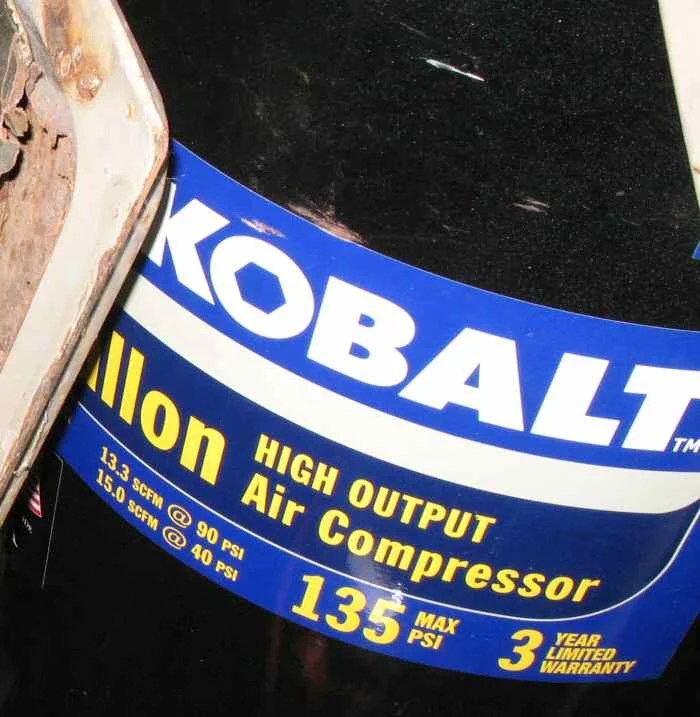

2 years ago the original price was $499 but they were having a grand opening at a new store and had it priced for $369. Spent another $100 on hoses/fittings and electrical stuff to install it.
I love it. I can run a sand blaster all day and it just chugs along. ;) With the 80 gallon tank it takes about 6 minutes to fill it to 130 PSI from zero.
thanks for the info . heres my specs ,i was gonna try a sand blaster on mine ,not sure if my tank is big enough ? 20 gallon ,mine is portable i don't no why they made one portable and on 220 .who has 220 outlets just laying around there yard.
do ya think it could run a blaster?
thanks for the info . here's my specs ,i was gonna try a sand blaster on mine ,not sure if my tank is big enough ? 20 gallon ,mine is portable i don't no why they made one portable and on 220 .who has 220 outlets just laying around there yard.
Yes that will run a sand blaster. The small tank will of course make it cycle more. I ran my pot blaster off of a small oil-less Craftsman compressor with a 25 gallon tank for quite a while and it had nowhere near your output specs.
