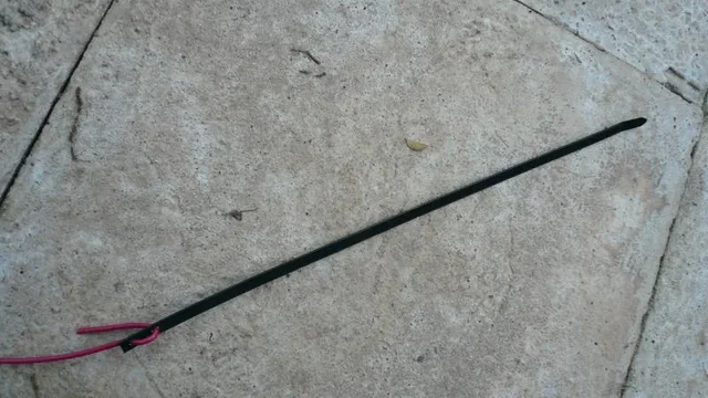

here is an old trick we used to do at the car stereo shop for running wires through rubber tubes/grommets. take a large zip tie cut the end off drill two holes in it put the wire in as shown then use the tip of the zip tie to feed through the grommet, when it reaches the other side just pull it through. a little vaseline helps too
