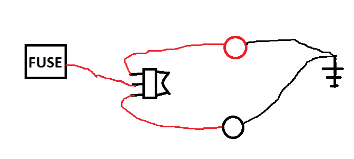

There are two lights being operated by the one switch. If all three post of the switch are hot, what tells the light to switch from off to red or white if there is always +12VDC applied to the light and both the ground wires from the light are run to the chasis or back to the fuse block?
Showing what I dont know... I thought the red +12VDC would run from the fuse panel to the middle post of the rocker switch then from the center post of the rocker switch to each light (red wire). Then the post from the rocker switch ON1 would run to the red light on each light and the post for ON2 would run the white light on each light.
What am I missing or not understanding?
this is how I see it
is you fuse box grounded to the chassis? If so, just chassis ground, if not, run it back to the block.
so when the switch is in the middle position, the circuit is open and there is no current flow. when you flip the switch lets say to the white lights, then the current is routed from the fuse box, through the circuit you just completed by flipping the switch, to the light, then to the ground.
This is correct for a single light. Just duplicate this for each light, so you will have to wires coming off each side of the switch...

These are the parts I have. It seems like there is something missing based on what I am getting from you guys. I run a red (positive) cable from the fuse block to the middle post of the switch. Do I need some relays between the switch and the lights? Just making sure you guys understand that the lights have both red and white in the same light. They can be switched separately so you it only lights the red or only the white. I want to be able to operate both off the same switch.
I hate electrical... Why does it always have to be so complicated.....LOL! Thanks for the help guys! I can also email you a Photoshop file or pdf if it will help of the above sketch.

Yeah.... no. A soon as switch over to Photoshop, I cant make the diagram work. With there only being (1) positive wire (hot wire) for the light... I dont get how to switch between white and red.
Oh.. That being the case, run a hot wire from the fuse box to each red wire on each light. Then, run a ground wire to the center switch. Then run the grounds from each light to each side of the switch x 2...
You have ground activated lights not positive activated. We all thought you were triggering via the positive.
Your switch will get a ground in the center pin. Then each light will get their ground from the switches output. The positives will go directly to the lamps from your fuse block.
Sent from my iPad 2 using IH8MUD
looks like you will use ground for switching and wire the 12v straight to the light. run ground to center term on switch and then run 1 side of switch to the 2 white light inputs and the other side of the switch to the 2 red lights. middle position of switch would be off(no ground to lights). oh robred already said it.
