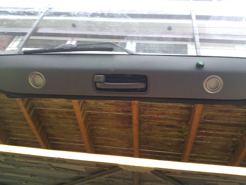

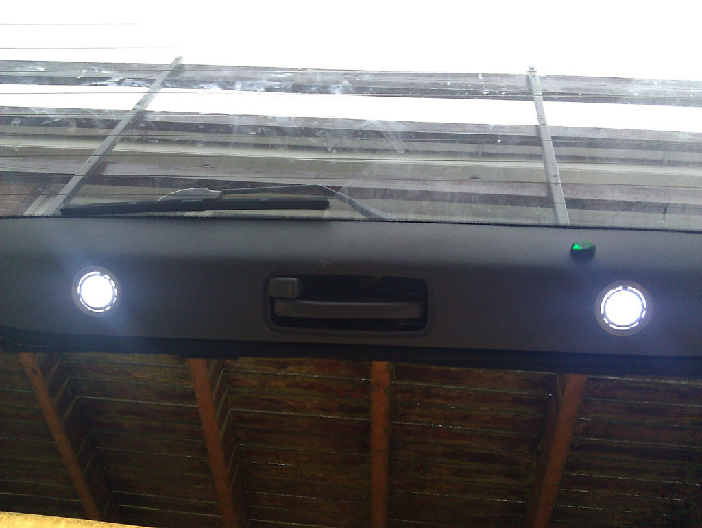

How to: adding 100 series hatch/camping/work lights
nice Wildsmith very clean might have to rip off your idea .Right now I just have a few Hella map lights plugged in around the truck.
Glad I found this thread. I have exact needs. Cant wait to see more ideas. Really like wilsmith's solution.
I wish wildsmith would have posted that solution earlier, I could have had a better install:(

Where did you source the lights you used, wildsmith?
A friend got them from a caravan place here in the UK some years ago, I don't have exact details. MudStuff.co.uk do some nice interior led lights but they're in the UK.
