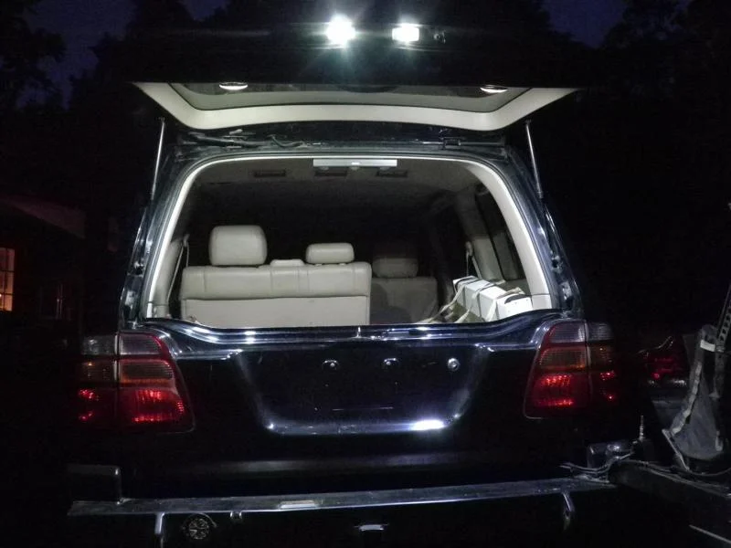

Another pic of mine in use down in Baja.....
Nice to see people using the camping lights! I used mine at the dunes this weekend as well! Three day camping trip with the coworkers and family to relieve some stress from the past two months or so...
