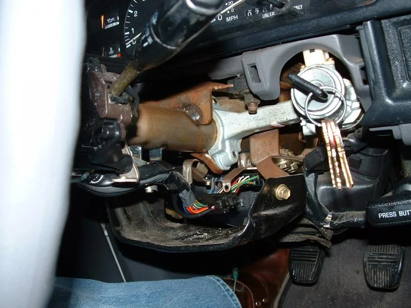

Next you need to remove the lower plastic panel below the steering column. 4-5 screws and 1 10mm. If you plan on doing the mod in one sweep, you can leave the hood latch on. You need to do this to gain access to 2 hidden, steering column screws.
You also need to remove the ignition switch cover plate (just snaps off).
PLEASE NOTE: do not force the cover off. Gently pry it away from the AC control/Center console covers.
See pic and the bottom two-these are obscured by the lower panel.

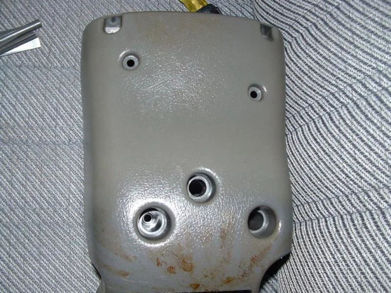

Remove the 3 screws that hold the 2 steering colum cover halfs together and then the two screws that attach the steering column cover to the column. Remove the steering column cover from the column. Should look like this.

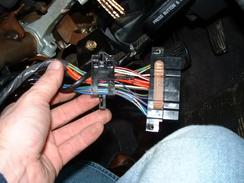

Removing the harness is straight forward and simple. There are two screws that attach the harness to the column. It is hard to take a pic of it but it will be obvious.
Remove the two screws, drop the connector down and detach harness. Pull switch/light harness out and it should look like this:

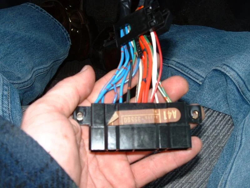

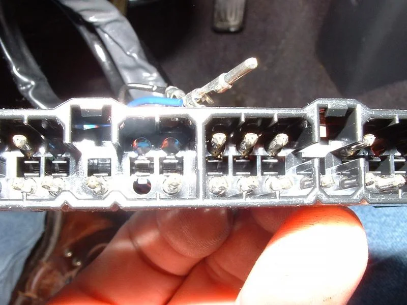

Now, you need to remove the wiper switch wires from the harness. Very simple BUT you have to be gentle with the release tabs. You do NOT want to break the harness.
Just to QC the original research, I made sure that the wiring was accurate against the FSM links I posted. Dead on. As well, you need to get the orientation of the pinout so you know how Toyota references the wiring i.e. where A2 is for example.
The ONLY thing I noticed is that the HORN wire (Green with Red Stripe) was NOT listed on the pinout. It goes to A5. Just make a mental note.

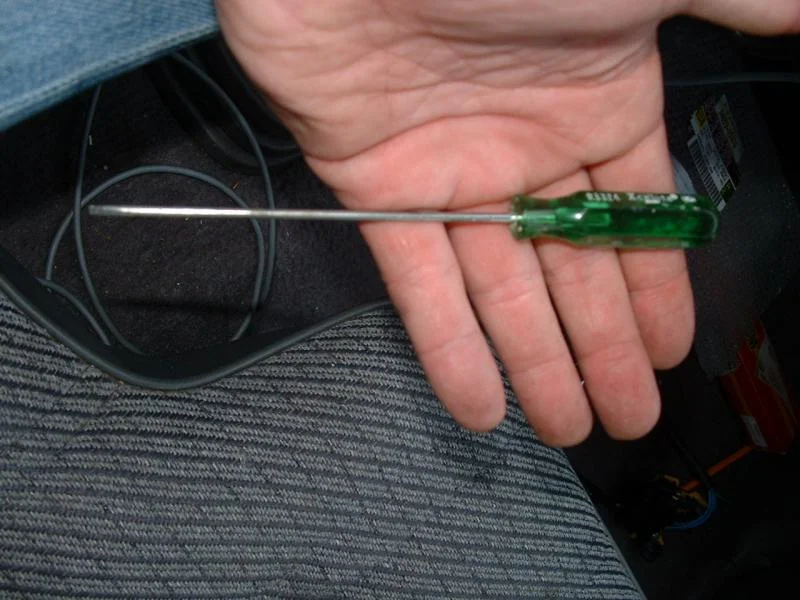

Here is a pic of the inside of the harness. You need a small, flat screwdriver to push down the tab and keep it held. Then push the wire in a little and then pull pack. They come right out. See below:

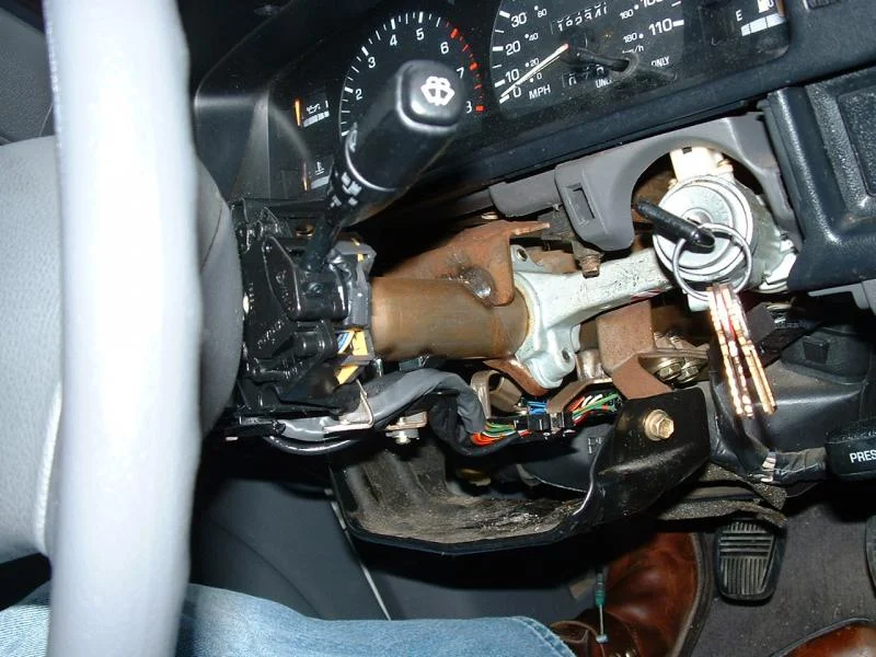

At this point, you need to go ahead and remove the steering wheel.
Remove the one screw that attaches the horn. Remove horn and wire.

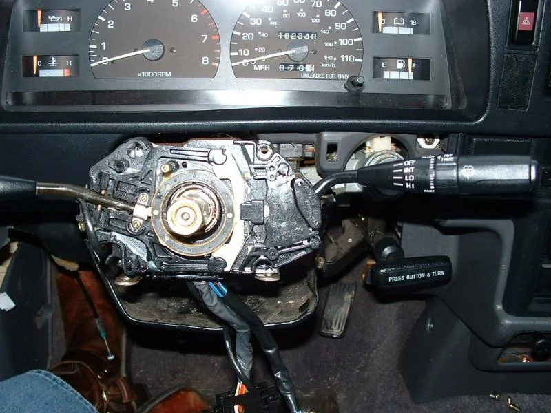

Remove the 19mm Steering Wheel bolt. (Make sure your wheels are straight). Wiggle the steering wheel back and forth and it should come right off. Mine did with little effort.

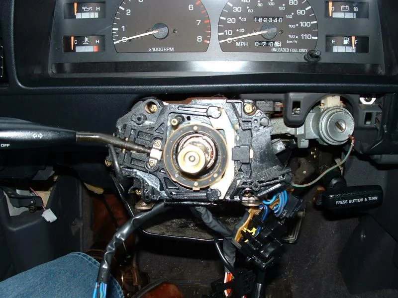

This leaves you looking at the switch housing.
At this point, remove the 4 screws that attach the switch housing to the column. Then pull off the switch housing.

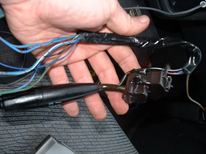

Now, you should have a light switch that is attached to the housing AND harness and a wiper switch that is ONLY attached to the housing.
Remove the wiper switch by removing the twp screws that hold it to the housing.
If you have not already done so, you need to remove the horn wire from the spring connector.
End up with this:
Next, attach the NEW intermittent switch to the housing using the same two screws as the old switch.
You might have to pad/route the wiring down a bit to get a good tight fit against the housing.
Attach the housing to the column. You get this.
Now you need to attach the new switch wires to the harness. They just slide in and clip to the harness tabs.
