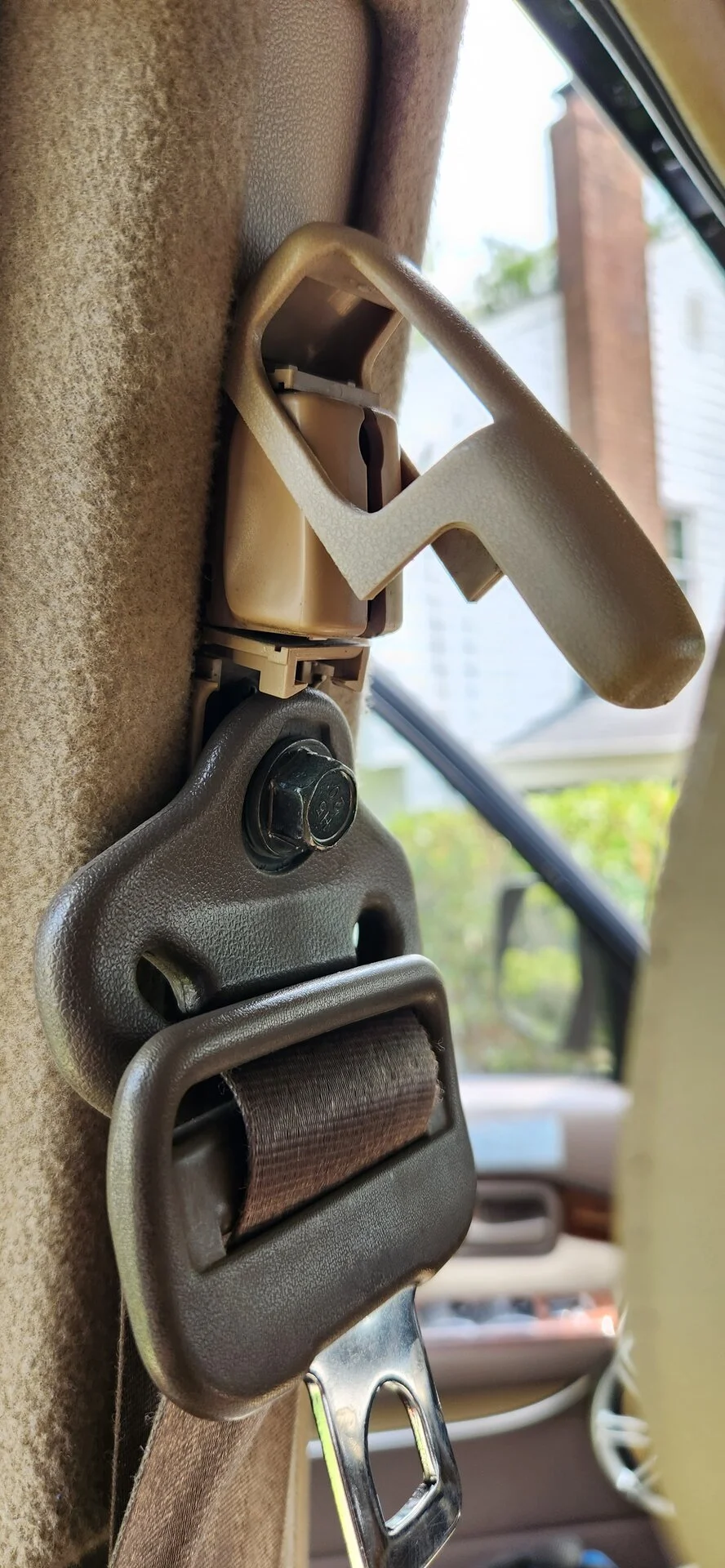

So I'm trying to remove my driver's side seat belt on my 1995 to send out for re-webbing and the bottom of the belt is no problem, everything's right under the lower garnish and easy to get at. My issue is I can't figure out how the upper mount with the slidey-bit is supposed to come apart so the bolt can be removed? I figured I'd ask here first before I started prying on plastic things that can't be replaced if I break them.
Every video on the Tube and searching here is only giving me the early rigs that just have a solid cover over the bolt. Mine is a rubber or plastic covered slider with a squeeze-button system to move the slider up and down, and it's really not obvious how it's supposed to come apart. The 1996 FSM is also (surprisingly) not detailed as to how this is supposed to be disassembled.

There's no clamshell on my truck, it's a slider with a one piece plastic cover on it. Can't figure out how it's supposed to come off. When I get home I'll post a pic of it, I'm pretty sure the earlier ones have a cover that opens.
This is the most frustrating part on this whole truck. I broke mine getting it off, because my overproductive engineer's mind created all sorts of complicated ways it was held on.
Then I went to a salvage yard to get a replacement and the light came on. It comes off without tools, once the upper bolt is out (@YMT). It just slides off.
Be really careful with it, it's fragile for no apparent reason. I have a spare (from a 1995) for a brown interior, if you need it. Both sides are the same part.
My apologies, I was thinking about the earlier ones. I've parted a few now. I forgot the 95 plus have the slider.
So there's a bolt under the upper garnish somewhere that needs to be removed first? I'll strip it off tonight and check that out. Looks like both door moldings can be pulled off and the upper garnish just slides off? Any clips that you can recall? Mine has a brown interior so I'll keep you in mind (thanks for that) but hopefully I can get this apart without breaking anything. I knew folks had done it before but I just couldn't find anything about it. Maybe I'll take some pictures and do a how-to thread for the next guy!
Took me 30 seconds to remember. Squeeze the height adjusters and lift the plastic.
Damn, I never would have guessed that! Thanks so much!

I got it open! I had to do some careful prying around the lower edge of the opening to clear the tabs, but nothing broke. Happy Dance!:cheers:
