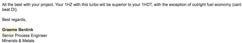

Here is a screen shot of an email Graeme sent me.
attachment.php
Now that's a serious mis-read and mis-quote by you. Graeme is talking 1HZ with one of his turbos compared to stock HD-T.
Notice what Graeme said in the same email about fuel economy.
Yeah, lets bring marketing claims into it also. Now you've provided more graphs with no direct comparison. Even if you did find 2wd 80 series dyno charts (majority of HD-T's are full-time 4wd), dyno variability will make the results useless for direct comparison.
So far, it's just been denial from your end. You want to be told it'll be awesome, better than a 1HD-T etc and can't handle being told anything else.
Why do you think there is no 1HZ performance data out there? Could it possibly be completely unsuited to being a performance engine?
It's like a MPG discussion with Wayne.
