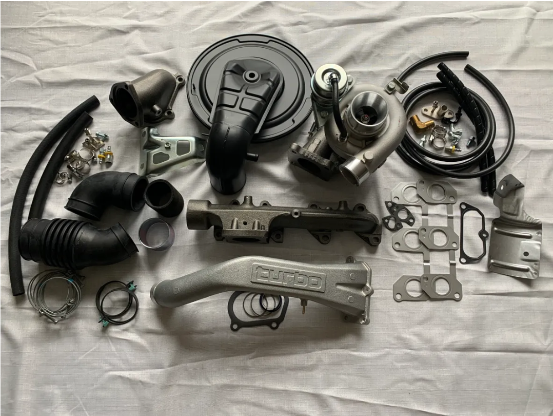

just noticed back40 imports has a hz turbo 'kit', gives you a good idea of the parts involved
if you want a stock setup
Thanks fellas.
Truth be told... I actually have all the bits to perform such blasphemy already sitting on a shelf in my garage. The only thing missing is a boost gauge and a hole in my sump... I even have a length of 3 inch dump with the right flange on it to bolt up. 😎
post pics when its installed 😁
