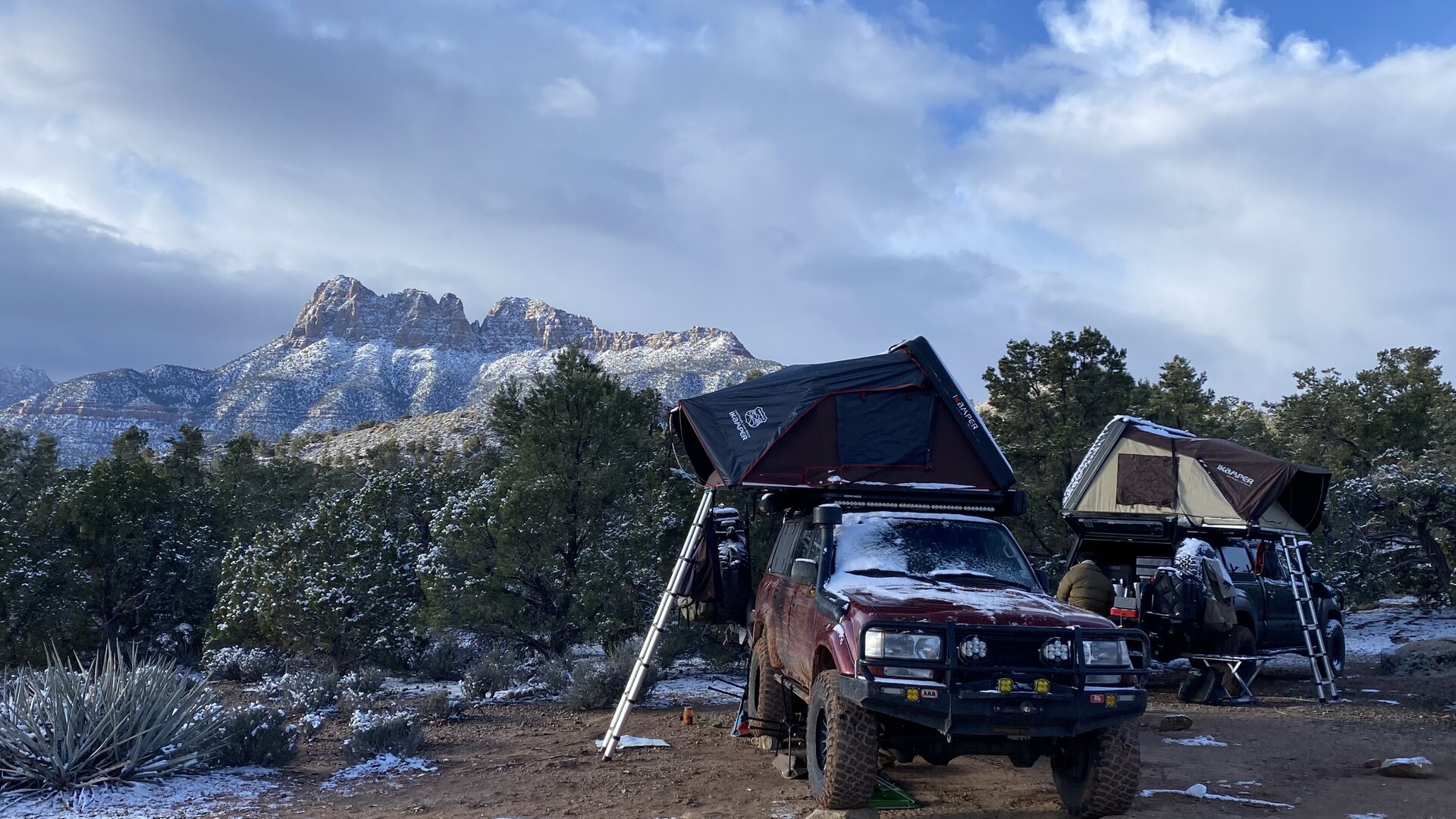

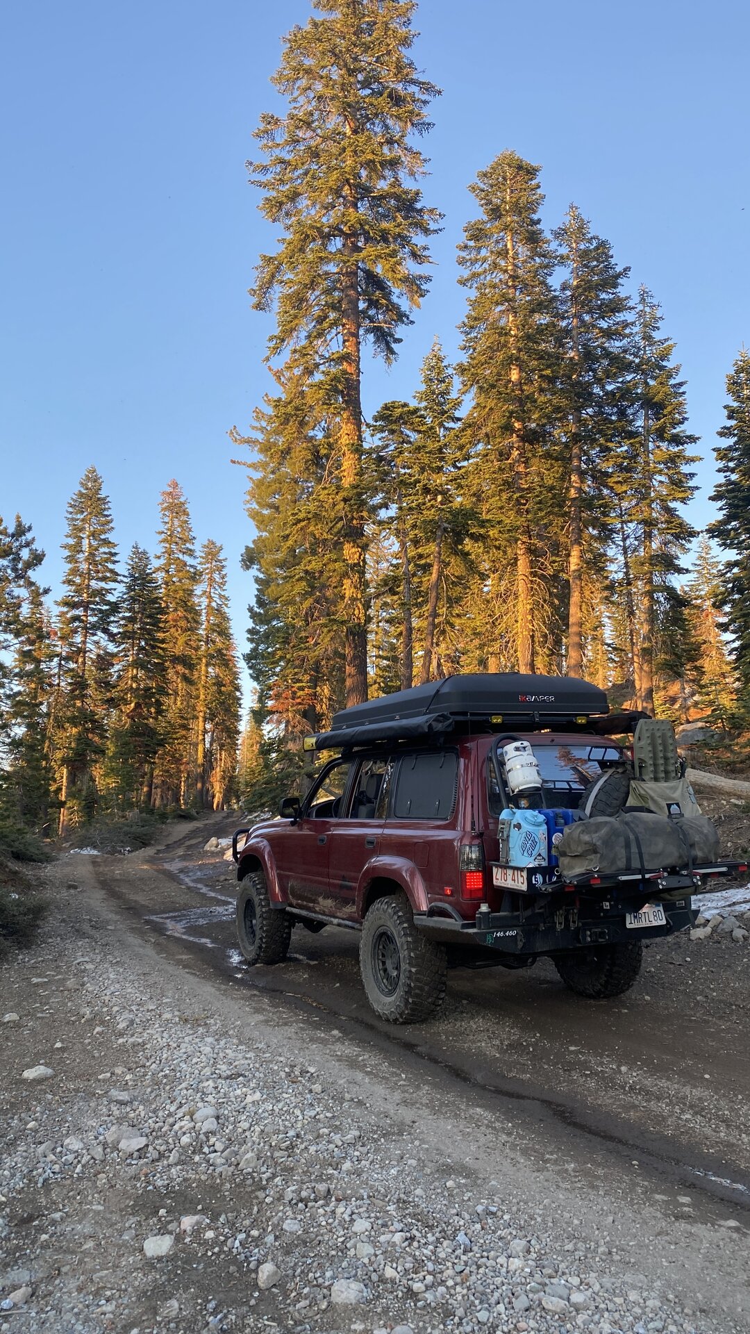

Fully loaded trip weight around 8500# including family. Around town weight about 7300#. Full armor, gear, drawers, aux tank, 80L water, RTT, awn all the stuff. To handle the load I’ve upgraded suspension, control arms, axles, need to do a BBK next.

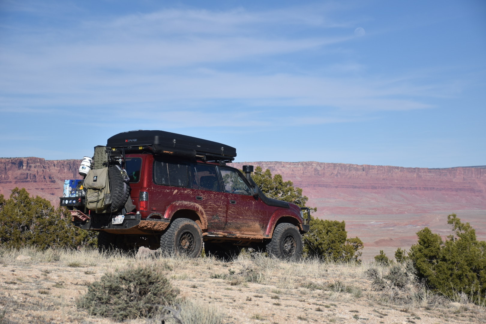

I ran Slee Heavies for a while but they only are about a 330# coil or so. I swapped those out for Dobinsons 319 coils that I’ve had in there for 50K+ miles and love them. They are taller and the highest spring rate I could find at 375#. I’ve actually added a 30mm spacer to those too to give me 4-4.5” lift.
I’d love to upgrade the rear axle but no, it’s original with RCV inner axles. I think the housing is slightly bent or bowed from the load and use.

I’m around 8.500lbs. Most of my weight is at the back since I chopped my 80.

Yeah the 319s are spec’d to give 6” of lift with 220# of load over stock weight. 375# spring x 2 is 750#, so the truck will lower an inch every additional 750# of load. If you compute that you will get a 4” lift with 1720# of load over stock or a 3” lift with 2470# of load over stock.
I still like to wheel my truck and take it on challenging terrain so airbags were never considered. Being undersprung with too low a spring rate on a heavy truck sucks, as bottoming out is likely and often, and the ride gets bouncy and loose, even with good shocks.
These coils have the highest spring rate I could find and I can say they feel really good on highway, mountains, washboard/high speed dirt and rocky crawling situations. Of course that all isn’t acheived just by coils. I’ve upgraded shocks and added upgraded bump stops, control arms, axles and swaybars.
I’ve also regeared to 4.88 with underdrive. My temps are good. Cooling system overhaul was done years ago and upgraded fan clutch with a leak free system.
