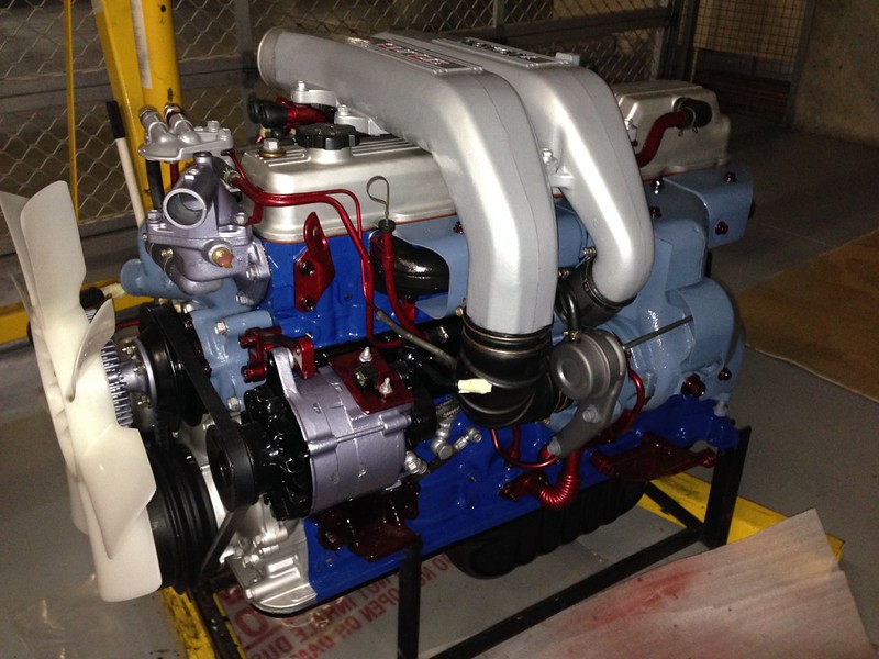

Australia is your best source for a 12HT, the wreckers here in Brisbane, Queensland have them for around $5k -$6k AUD, that's around $4k US, they will ship to US etc, or source one from Japan.
I finished one just last Xmas and building my second one now?
All your 12HT parts will most likely come from Oz, with good availability and reasonable shipping costs. If you do all the work yourself, no prob, but otherwise you need a mechanic willing to climb the learning curve.

Good info. I'll have to think on it some more. That is a clean engine, looks great!
