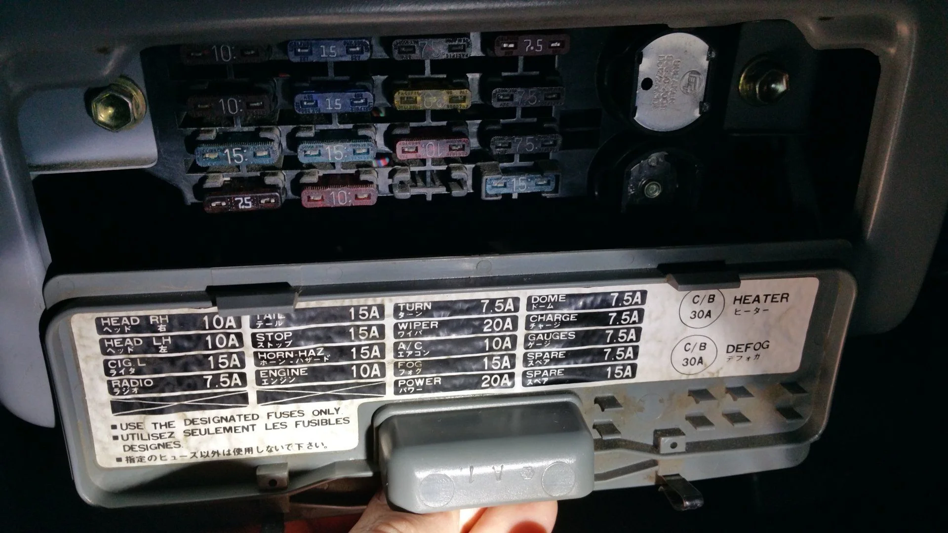

My rig came without a working horn. I bet this is it. I'm about to order parts, do i need a steering wheel puller or will it just come off once unbolted? Also i cannot seem to figure out why the POWER fuse is missing and am reluctant to put one in as everything works but the horn? I assume it is the power antenna fuse? That 2 does not work as it is broken off at the base.

If you’re talking about an FJ60 they didn’t come with power antenna. I’m not familiar with the fuse you’re speaking of off the top of my head, but it probably does something. I don’t recall there being an open fuse slot that is labeled like something should be there.

That's great info, thanks @gman. I am still unsure of what the (empty when i bought it) POWER fuse slot pictured is for? yes i have a 60 and its 1984.
I'm wondering if they were in the process of designing the accommodation for power windows and/or door locks back in 84 and had already allocated a location in the fuse panel for that. I'll check the decal on my fuse panel cover in my 62 tomorrow and see which one that fuse is for mine.

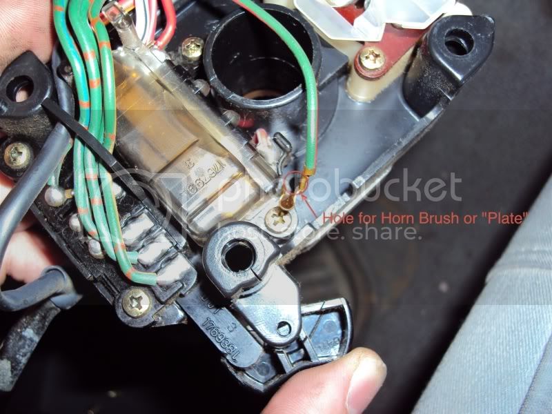

Ordered a new Horn Pin. Toyota calls it a "Plate." SOR calls it a "Horn Brush."
The part consisted of the pin, a spring, and a little c-clip (not pictured)
This is how far apart I took it to fix this thing. My dash looks blue, camera flash is responsible.
Backside of where the pin goes through. My thumb is on the Hazard switch.
I think it was worth replacing wouldn't you say?
Final Product
Never seen a photo of a new pin next to an old one so I wanted to share my findings.
And the Horn works perfectly now :)
Ready for some butt-heads that cut me off in traffic ;)

Question on pulling out the headlight and turn signal switch assembly - does it clear the steering column without unplugging the big connector from the bottom? In your pic it looks like you were able to do so without disconnecting but just releasing the cables/harness from the retainer clamps, is this correct? I want to try this in order to have better control and access for installing the c-clip which I lost today after it went flying (just like this forum warned me it would!)
I don’t believe I had to disconnect the harness. Just got it loose to get enough slack on it. This was some time ago but I don’t see why I’d leave it hanging like that for a photo otherwise. HTH

Does the old pin pull straight out or is there a trick?
Once the wire is disconnected and the c-clip is removed, yes.
