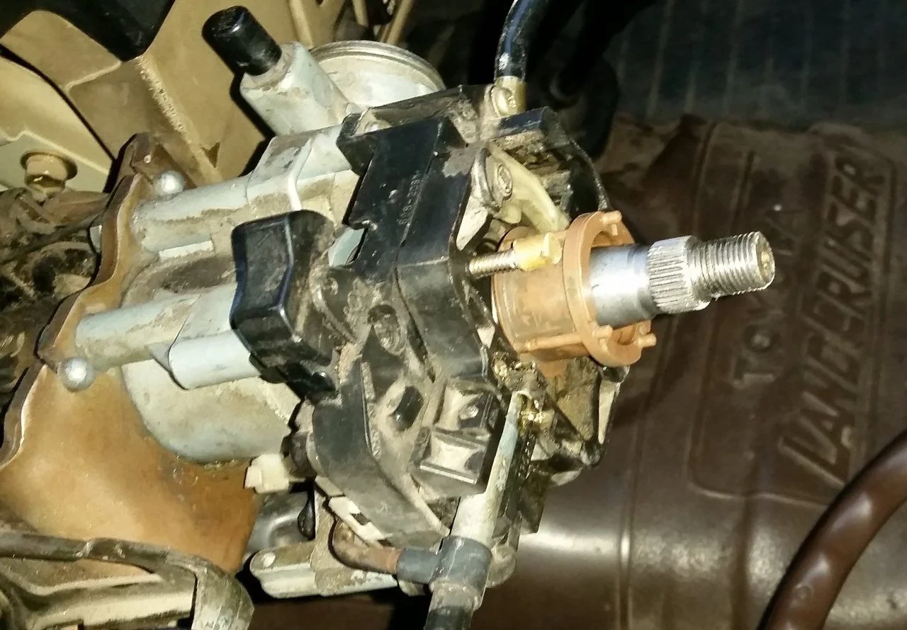

Ordered a new Horn Pin. Toyota calls it a "Plate." SOR calls it a "Horn Brush."
The part consisted of the pin, a spring, and a little c-clip (not pictured)
This is how far apart I took it to fix this thing. My dash looks blue, camera flash is responsible.
Backside of where the pin goes through. My thumb is on the Hazard switch.

Thanks for the pics. I didn't have to remove my turn signal switch to replace my plate (pin), but it was a little dicey trying to get the uber-small snap ring on the end of the pin, without losing it.

Yeah no problem, After I saw that tiny c-clip I started to disassemble because there was no way I was gonna be able to get that sucker on there. I lost the little clip inside the black turn signal/ wiper control a few times and had to unscrew those to find it.

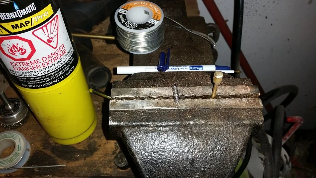

This pin that I replaced actually ended up wearing down again. I had to put a .22 casing on it. And now I think that is even worn out.
Best thing to do here is buy both the pin and plate that screws to the steering wheel. The surface of the piece screwed to the steering wheel must be too far gone. I'll probably do this in the future.

My horn went out on an extended trip, far away from any hope of getting an OEM replacement for several months. So I fixed the worn horn pin using a brass female threaded hex standoff... that for some reason I had in my bolts container. If the pin is carefully filed down to remove the remaining stub, the end of the pin can then be cram-threaded into the standoff.
The end result is a brass wiper that has more than 2X?, 3X? the material than the OEM little pin. It works great, is silent and is not wearing much at all... last time I checked, 5 years after I installed it. Might be wearing the metal ring on the wheel more, but I can't tell if that is so. I think it will last for the remaining life of the car.
You just use needlenose for the clip @dkyuss ? I need cheaters for my cheaters to see this thing!
I took the whole turn signal assembly apart (I was ultimately going in there to clean the relay contacts for headlights and found the horn pin just flopping in the hole, no spring or 'nob on the end'). IIRC the clip is easily accessible, and yes, just a leatherman for needle nose pliers. Its super tiny. Plan for it to spring off while installing and shield/cover the area to catch the randomly flying, super tiny, pain in the ass if I loose it c-clip. I got it on by the second try. Good luck!
