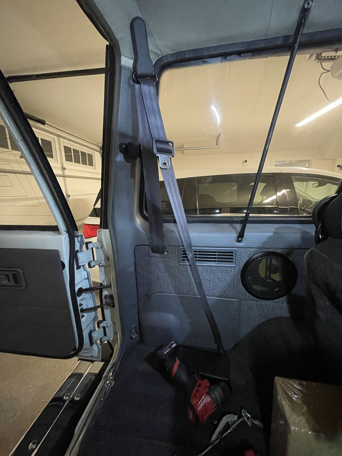

I did this in my 77 when I added a 3rd row. I bought a full set of seatbelts from a wrecked 77 off Yahoo Auctions Japan.
The 77 was made with an option for rear seats in one variation (I think the Prado). Mine did not come with factory seatbelts in the very back, like yours. There were a few holes for seatbelts. But it was like the factory stopped halfway. Holes with no threads, missing holes, no holes. Very strange.
I ended up customizing and heavily overbuilding for safety. Here's some photos.

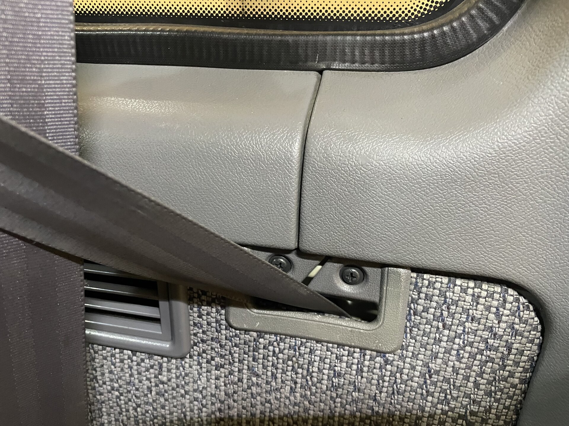

Factory seatbelt was supposed to go here. Just a hole with no threads and no access to the backside. I didn't want to use a rivnut on a safety component, so I scrapped this location.

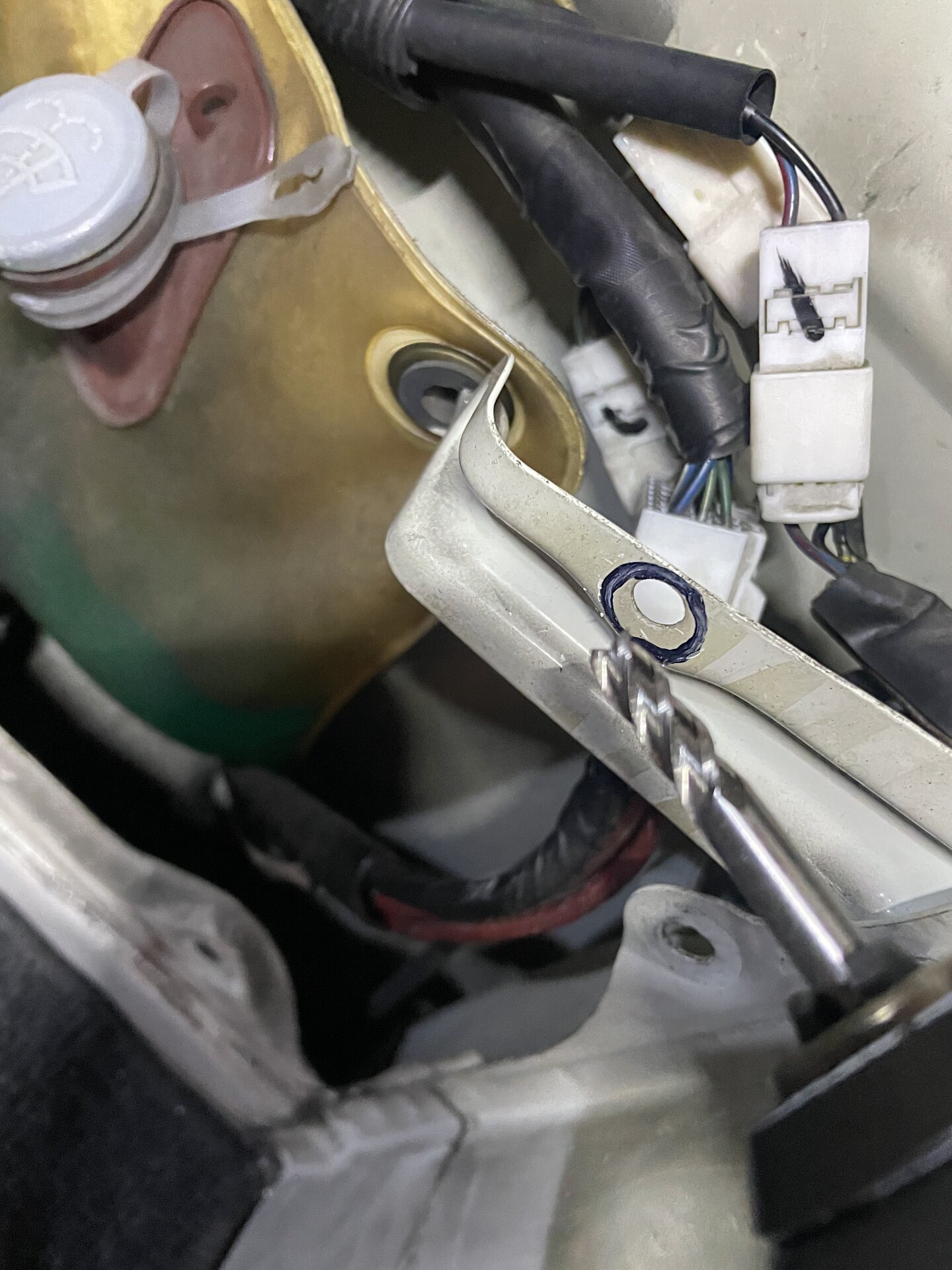

I ended up installing the seatbelt in the corner and bending a wrench to fit back in there to torque it down.
The LH side at the bottom mounted right in like it was made for it. Threads and all. The RH side did not. I had to fabricate there at the bottom.
This is really cool. Thanks for the detailed response. How did you fasten the nut on the top left? I tdoesn't look like there's any access from the other side for a nut...

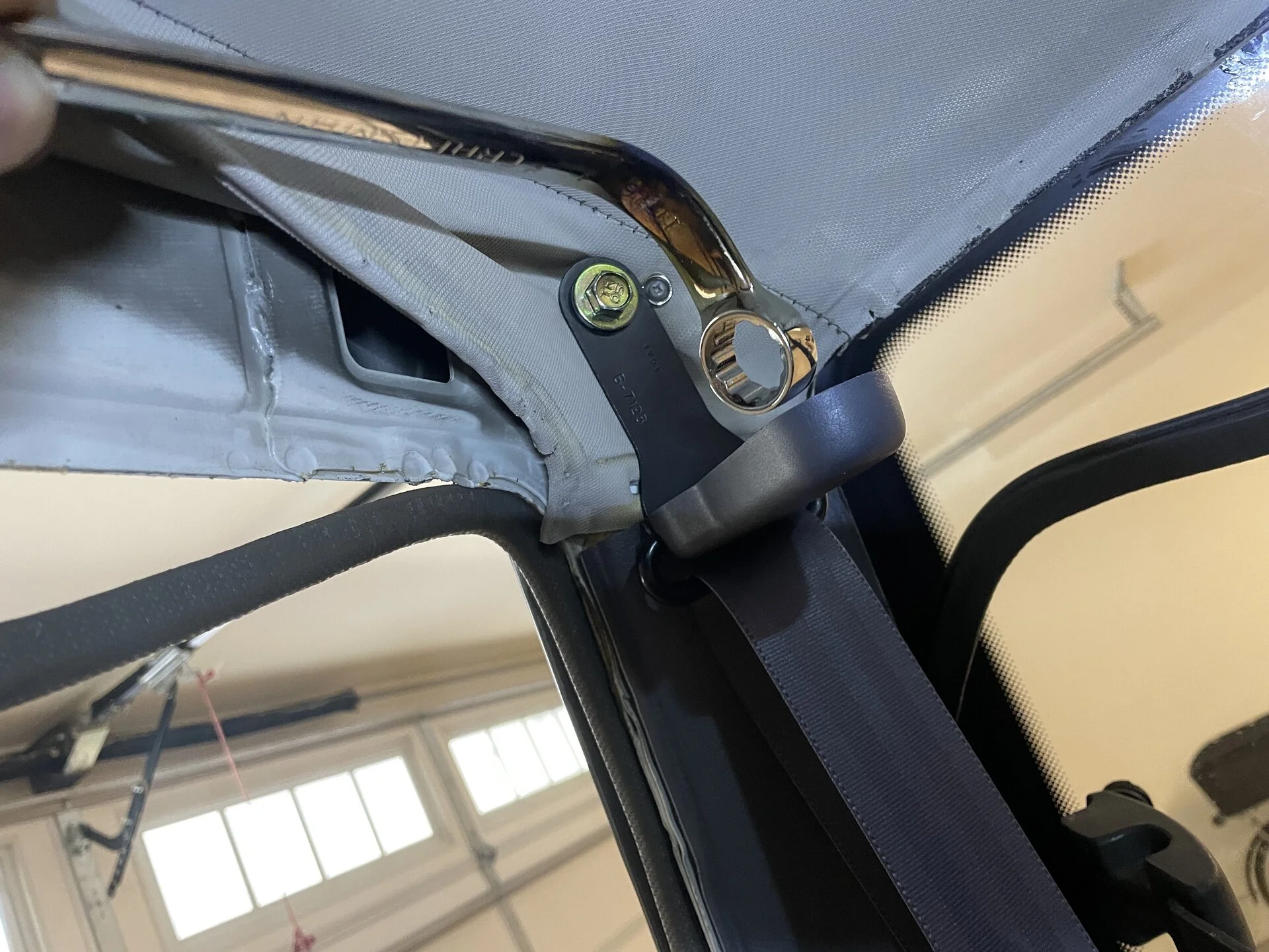

I was thinking I'd just do lap belts, but after looking at your setup, shoulder belts don't look that much harder. Was the spot for the seatbelt reel already there (last picture)?
And finally, what seatbelts did you use? Just the same ones as the middle seats?
Please see the second picture where it shows exactly how I did this with a bent wrench.
Yes and no. Per my post: "The LH side at the bottom mounted right in like it was made for it. Threads and all. The RH side did not. I had to fabricate there at the bottom."
"I bought a full set of seatbelts from a wrecked 77 off Yahoo Auctions Japan." You can use either the middle seat belts or the front seat belts. I believe one is a bit longer than the other. Not sure why.
