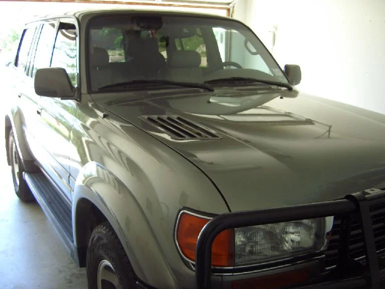

    I just got my vent back from the body shop where it was painted to match my Sage 40th. Installed this morning.

    Looks really nice... whats the vent from/off of?

    from a Chevy Lumina Z34

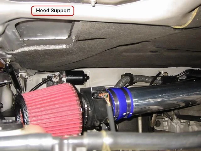

    Did you need to cut the hood frame at all? I can't see putting those vents in without doing that. Do you have an underhood shot, or would that reveal too much carnage?:eek:

    Same question did you cut the hood support (hood frame)? :eek: hope not.

    Sumtoy was right in his previous post, there is no way to install this without cutting into a portion of the hood brace. I positioned the vent in the center to where I had to cut a small amount from a top crossing brace and small piece of the bottom crossing brace. That was the best position I could find to avoid cutting a big chunk out. My body guy should be able to fab a support brace if needed to correct any issues...
    Vent sits above and slightly behind the air filter.
