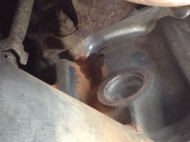

Installed new radiator and lost some tranny fluid in process - refilled - all good on atf fluid level but now appear to have a pretty significant leak....any thought on where this is coming from?
Higher up
Uh oh.....is my head gasket gone....
Is it coolant I'm seeing and not tranny fluid...?
Unfortunately...Yep

Dang it - not seeing anything in the radiator - no drop in engine performance as far as I can tell....$@&&$?

cleaned things up and dried off underneath to see if i could track down leak some more.....
appears to be coming from the seam
but then a little bit later - leak seems to have migrated to rear of block - could have been just down to me driving around.
With regards to the cooling system - everything is new - all hoses etc - except this mystery hose which apparently runs under the throttle body - couldnt get to it....
local garage says a hydrocarbon test will be definitive proof..doing that tomorrow morning - under 100 bucks.
