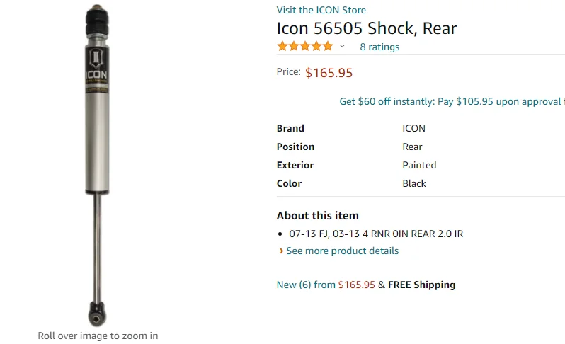

Are you aware of any difference between a ICON 56550 and a Icon 56505? I am trying to source the same rear shocks that you have used on your build but Metaltech doesn't have them in stock.
Will being doing as you did, rear airbag trick for a short while, then converting to springs.
Based on my notes when I did the research a while back, the main difference between the ICON 56550 and 56505 is the length of the shock.
56550 = Extended Travel
Compressed length = 17"
Extended length = 28.5"
56505 = Standard Travel
Compressed length = 15"
Extended length = 24.5"

Im having a very hard time source these shocks online. Would you know of comparable shock?
Everything has long lead times currently...Icon and Bilstein are backordered globally. Metaltech @helocat is your best bet for Icon and if they don't have it no one will. For a comparable shock, only Bilstein and Icon have shocks with digressive damping so Bilstein 5100s would be your best bet for an in stock rear shock with this damping. If you want long travel OME and Dobinsons also make them.

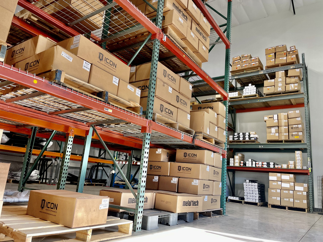

@sshevela not SOL with Metal-tech 4x4. We have 11 complete sets of ICON Stage 2 suspension systems in stock ready to ship. Free shipping too.
Fore rack all ICON and the rack on the back wall almost all ICON, in stock in Newberg, Oregon at Metal-tech 4x4. We ordered this almost 6 months ago, why we actually have it. www.metaltech4x4.com

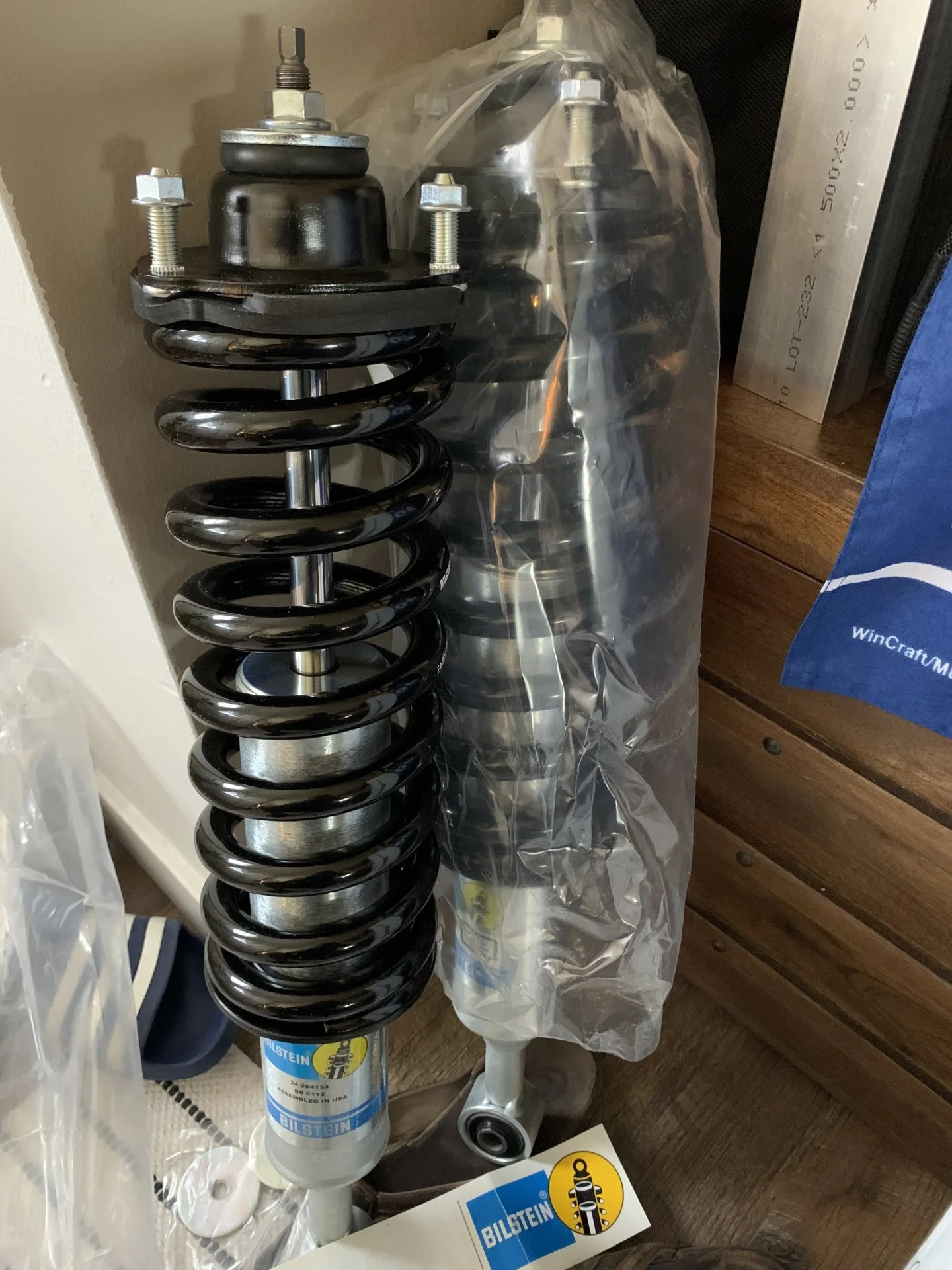

Look what arrived just now! No mention of the spring rate and Bilstein USA has not responded to my inquiry regarding spring rate.
Bilstein USA recommends the 5160s shock 25-227611 to go with these heavy duty front coilovers

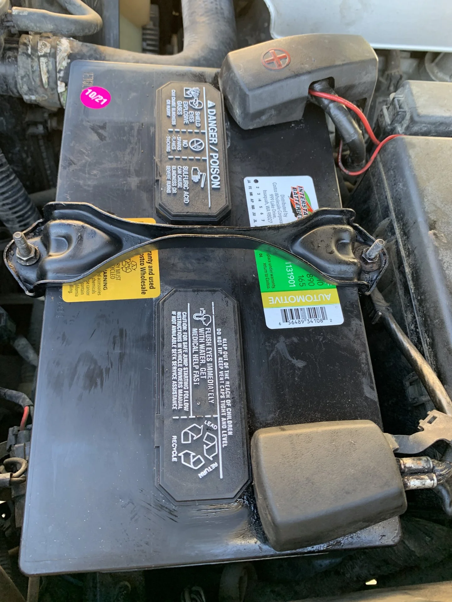

Replaced battery and took opportunity to clean the battery holding bracket. The nut was stuck and was squeezing old battery at an angle.

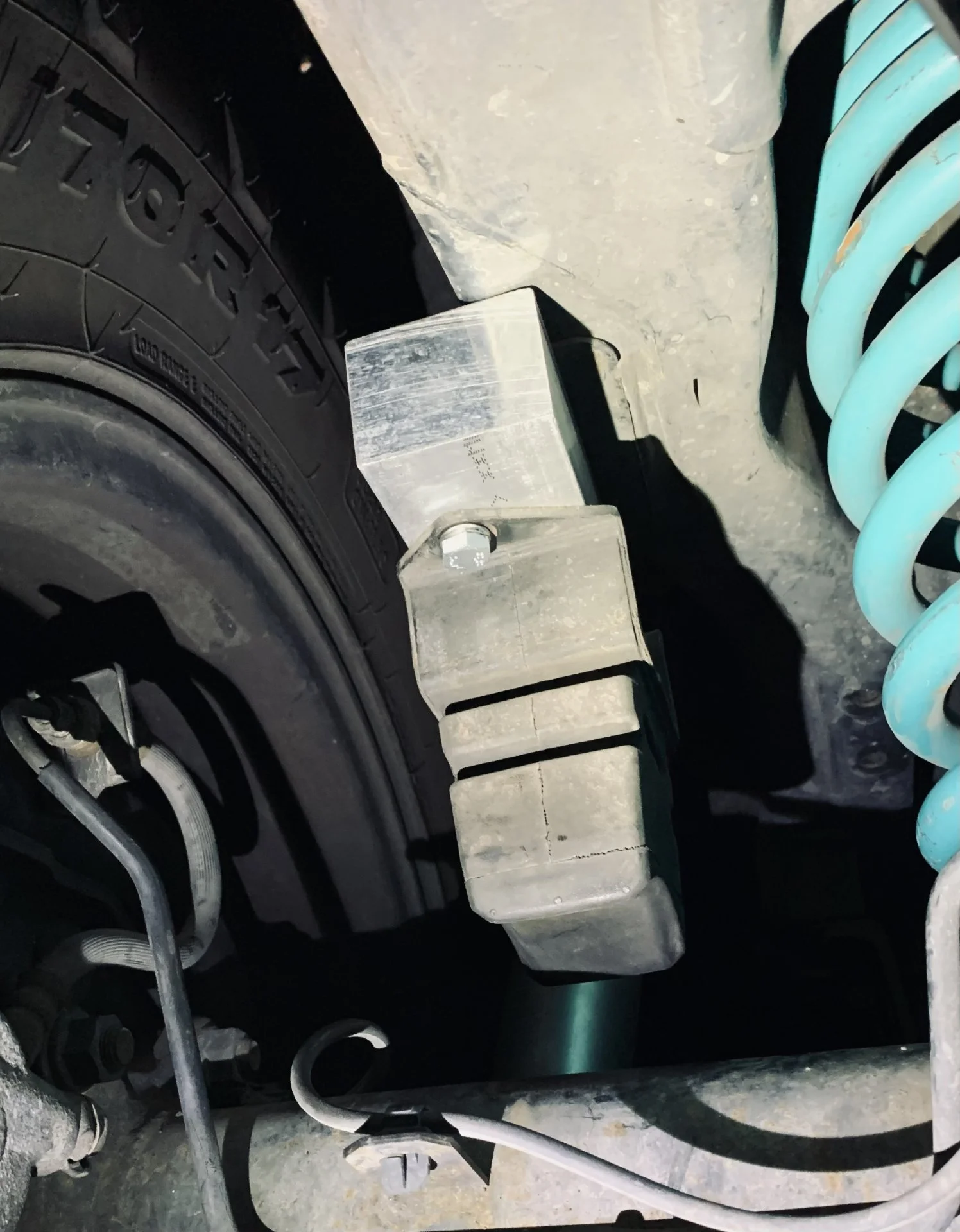

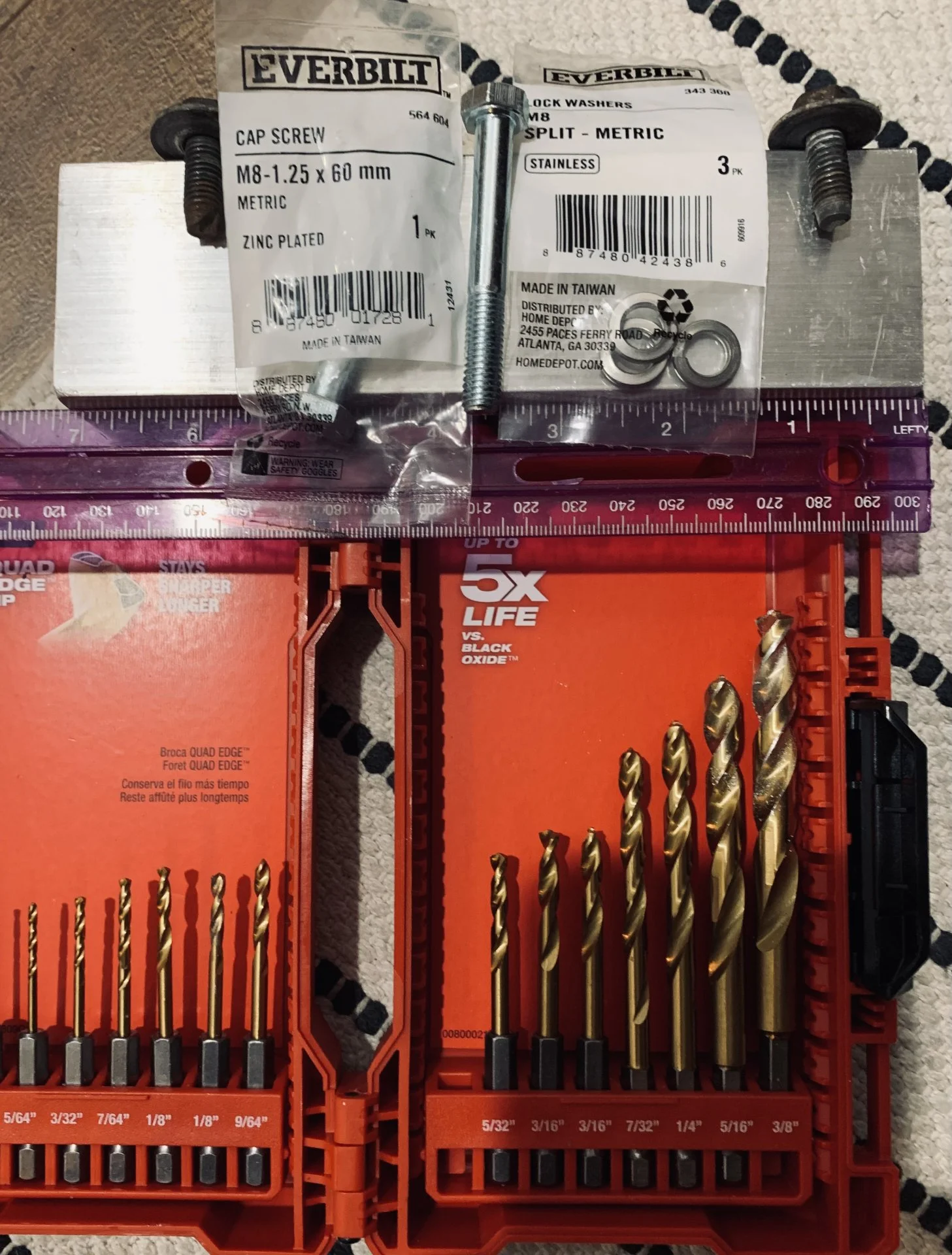

I also drilled 3/8” holes into an aluminum bar 1.5” thick by 2” wide by 7” long to serve as bump stop spacers for the rear.
I had purchased these aluminum bars a while back for like $25/pair plus another $8 in bolts and washers.
I added this homemade bumpstop spacer 1.5” to the drivers side only, but now the oem bumpstop is only about 2.5” from the axle. Seems too close. I’ll test it out but I have a feeling I don’t need spacers for the oem bumpstops.
I’m hoping to re-use these spacers for when I get the timbren ones.
