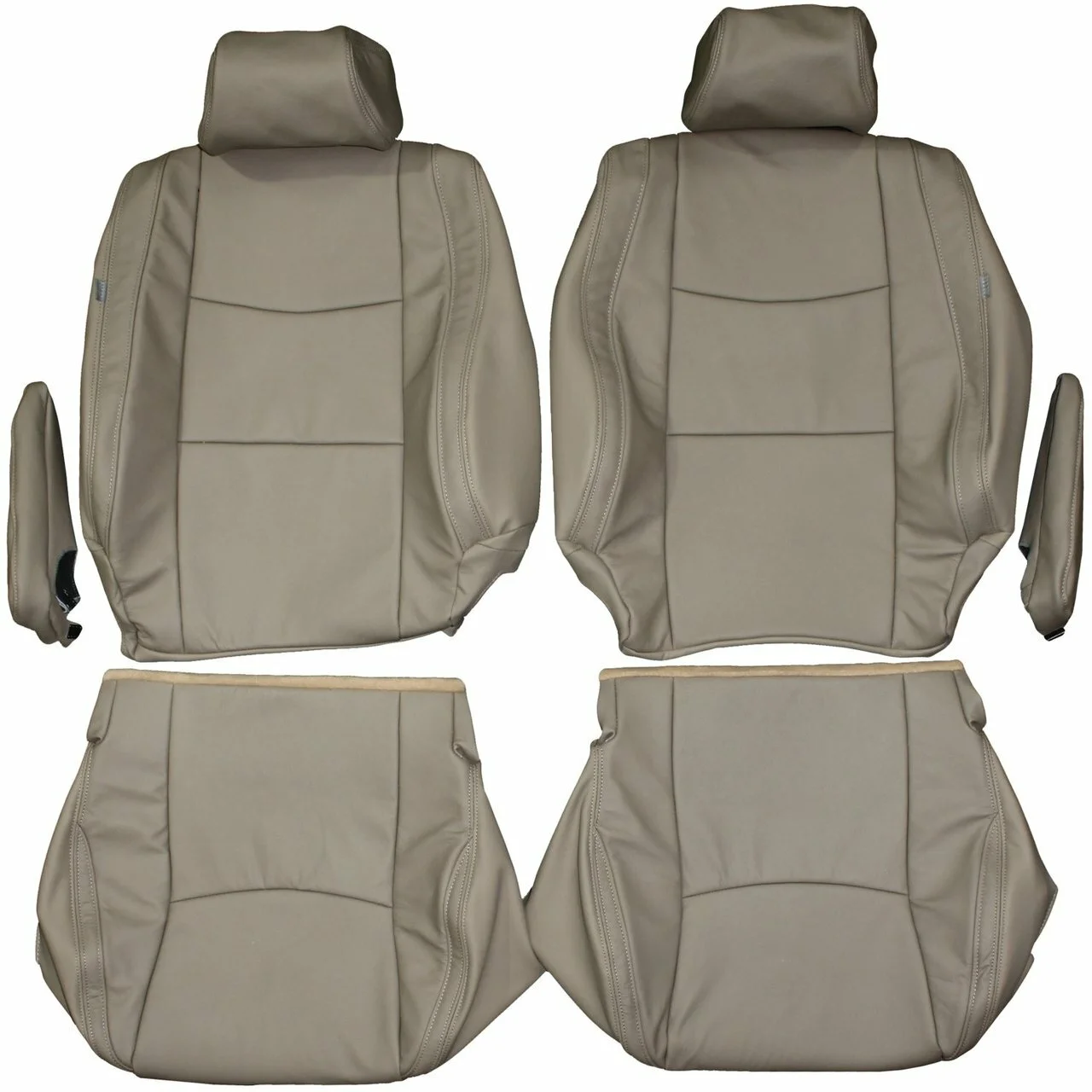

Was that price for 1 or 2? My GX will probably be needing them in the next couple of years.

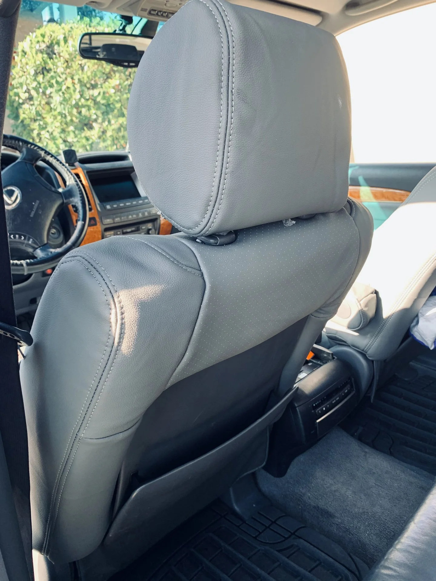

Add some leather conditioner once a year and it will do wonders. I applied some griots conditioner and the leather and seats went from a hard and shiny surface to soft and pliable. Massive difference and it smells nice
Lseat.com sells them in pairs for front or rear. I don’t remember seeing individual pieces for sale at LSeat.com
There are other vendors that sell individual pieces like only the front bottom by itself, but the prices were kinda high compared to Lseat.com.
I might have to give this a try on the new leather seat covers

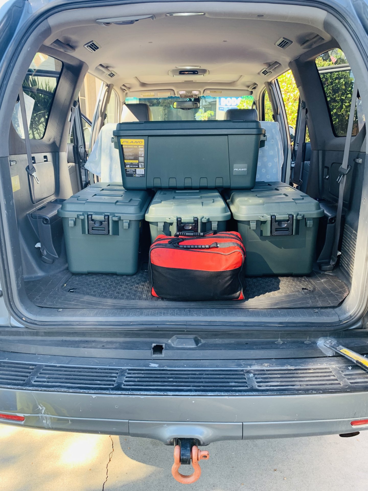

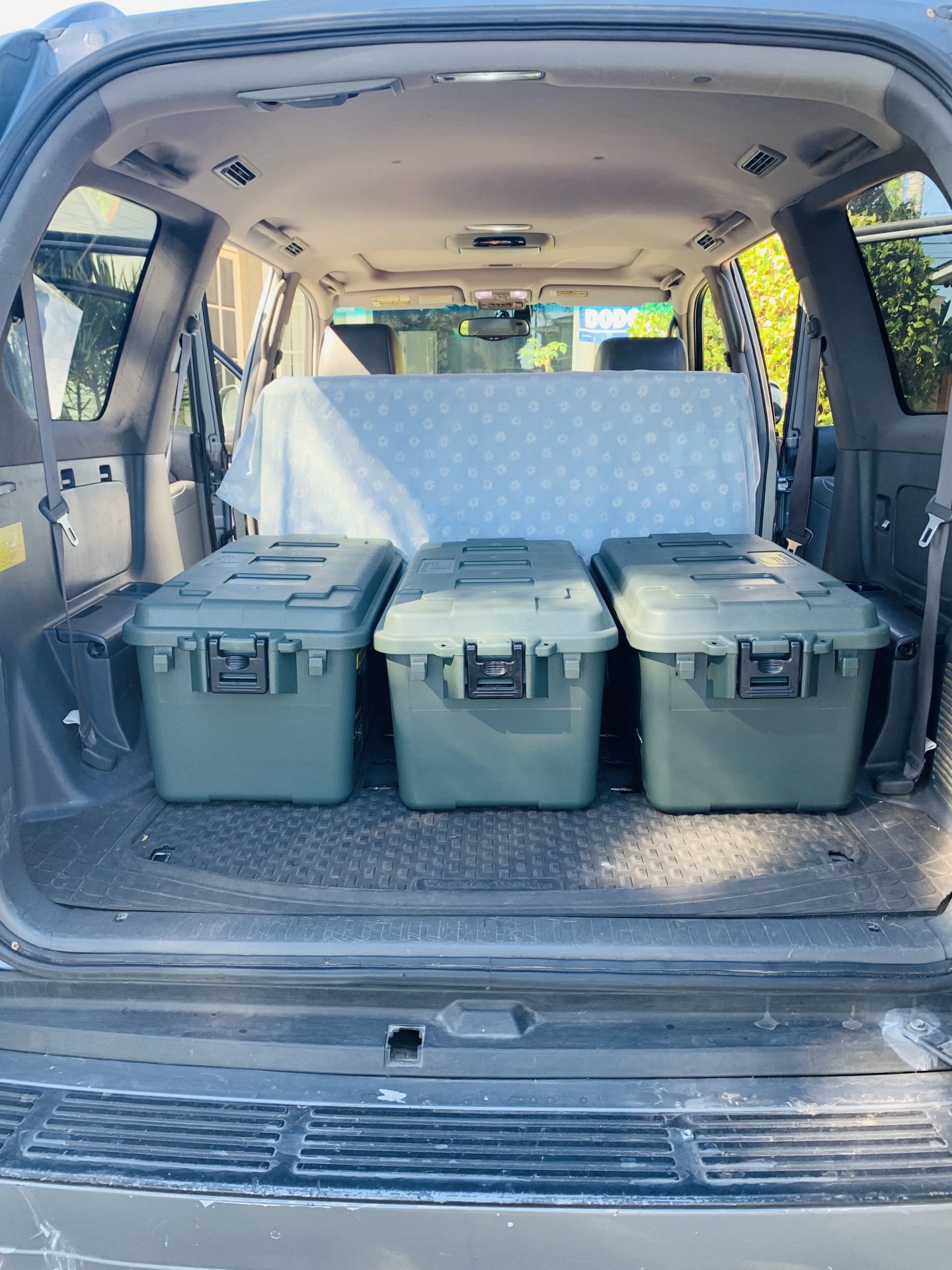

In these pictures of the Plano Sportsman 68 qt 1719-00 storage bins, I left the middle row folded. I usually remove the second row to fully extend the foldable twin foam mattress for sleeping.
So, I usually get another 10” of floor space, so i can fit other bulky items (like my cooler, 5-gal water jug, and eventually my small solar power station) near the barn door for easy access
Those are a great size.
Yeah I'd meant the vertical sides of containers. You can loos.so much space with thick walled or tapered sides (like tuff totes and Rubbermaid stuff)...
Ah, got it. You were referring to the shape of the storage bins themselves
Wow, labor to install the front leather seat covers is pricey. One shop quoted $350 for both and another quoted $475.
I thought it was going to be around $200! Yikes. I’ll keep looking.
DIY!
I thought seat fabric removal was daunting then a buddy walked me through pulling seat fabric off my Subaru seats when we added seat heaters. I just replaced them with zip ties instead of the hog ties that holds them on factory. It's not so.bad (well with Subaru seats at.least ;)
And with those roo seats,.I took them.to the car wash and power washed them..they dried looking great!!
The pros are asking me to leave the car there all day, so this is not a two hour diy job. I found a place that quoted me $250 cash. I’m gonna visit them on Tuesday morning.

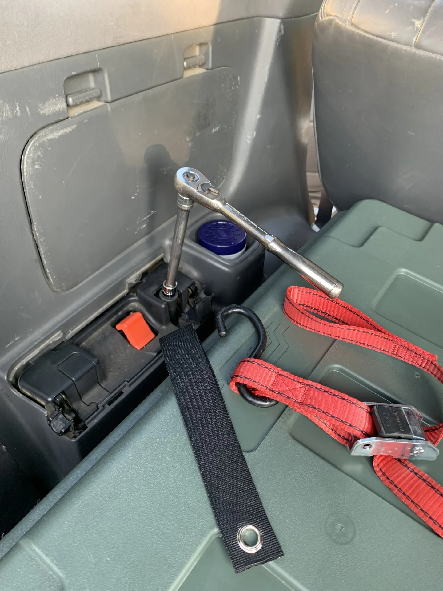

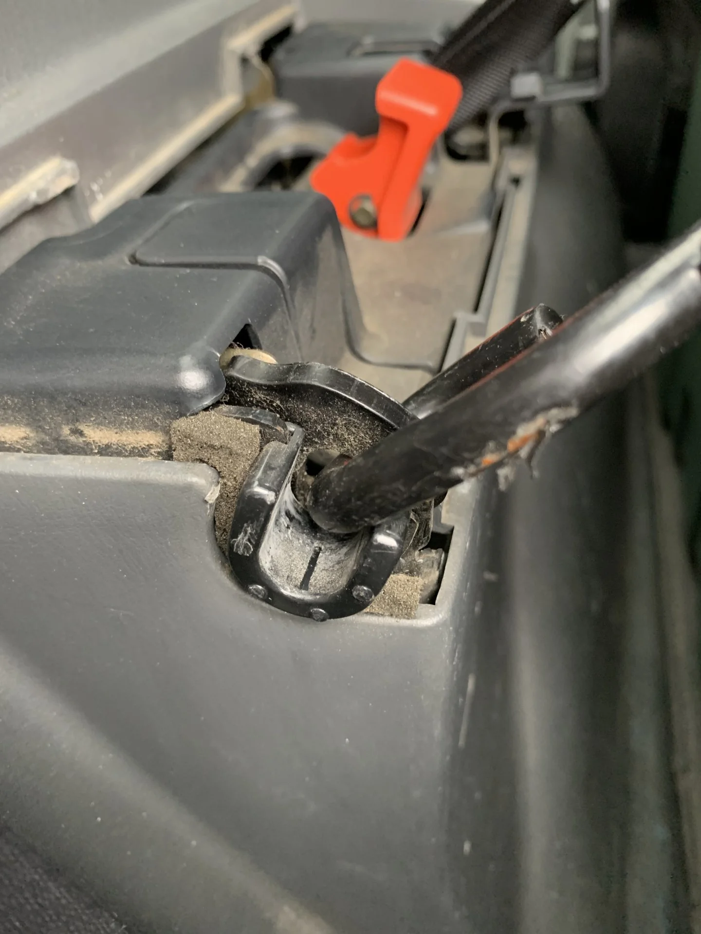

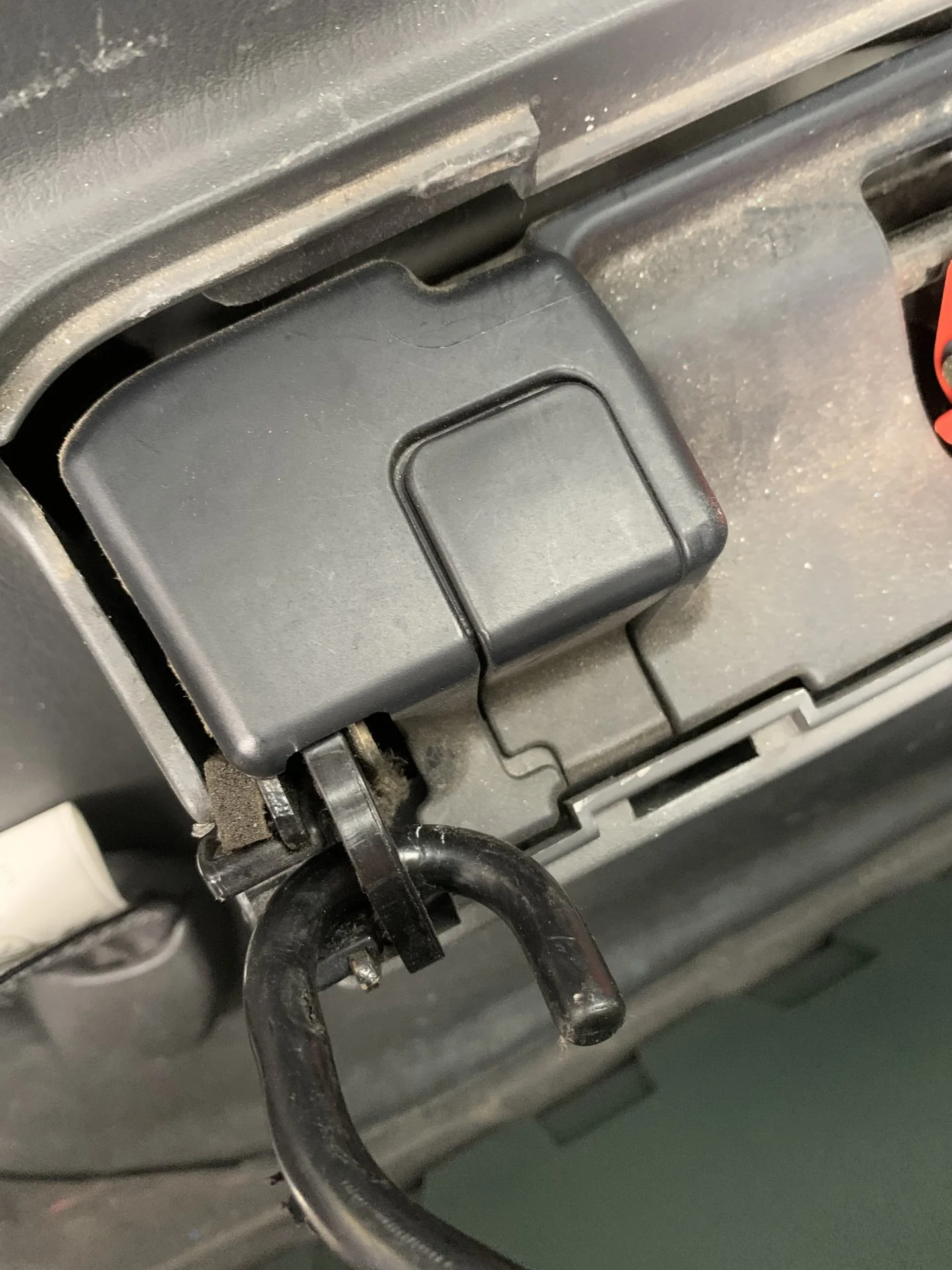

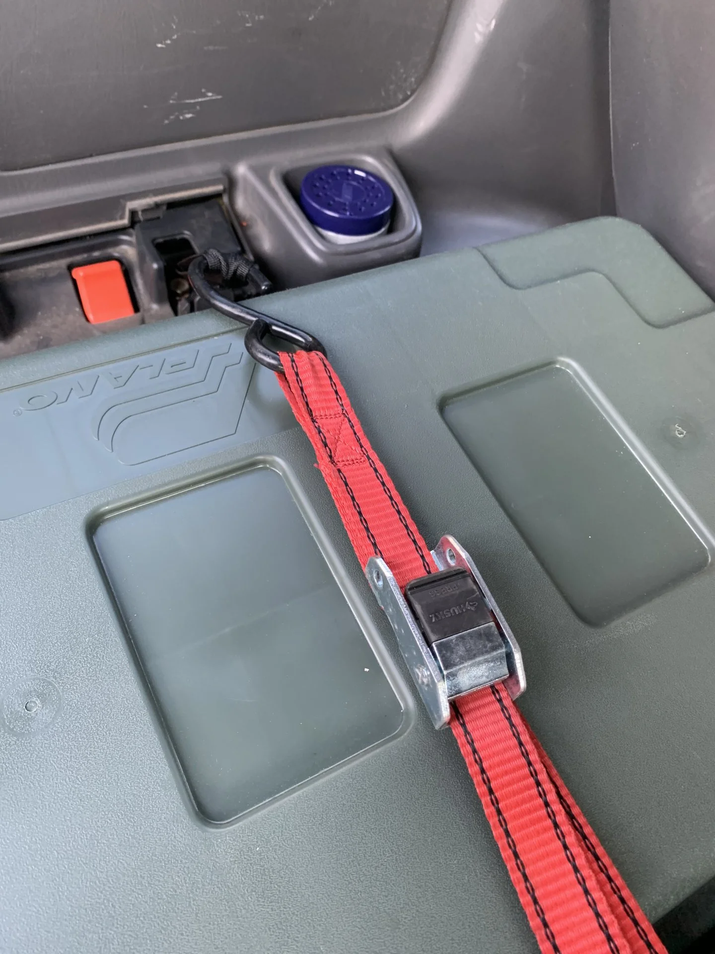

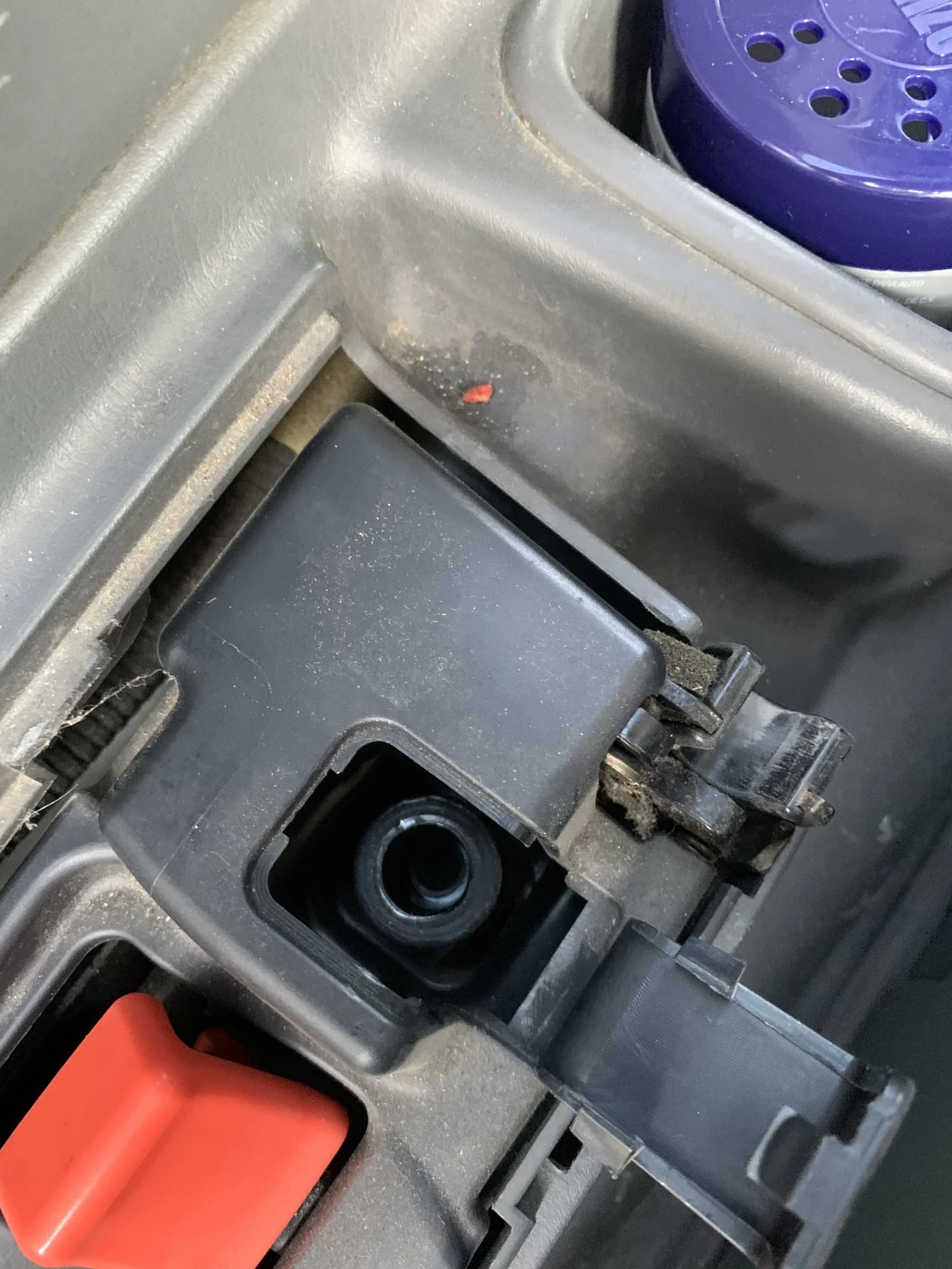

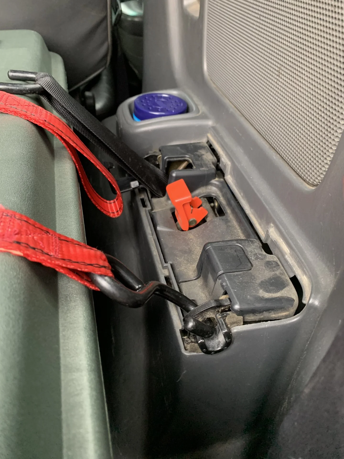

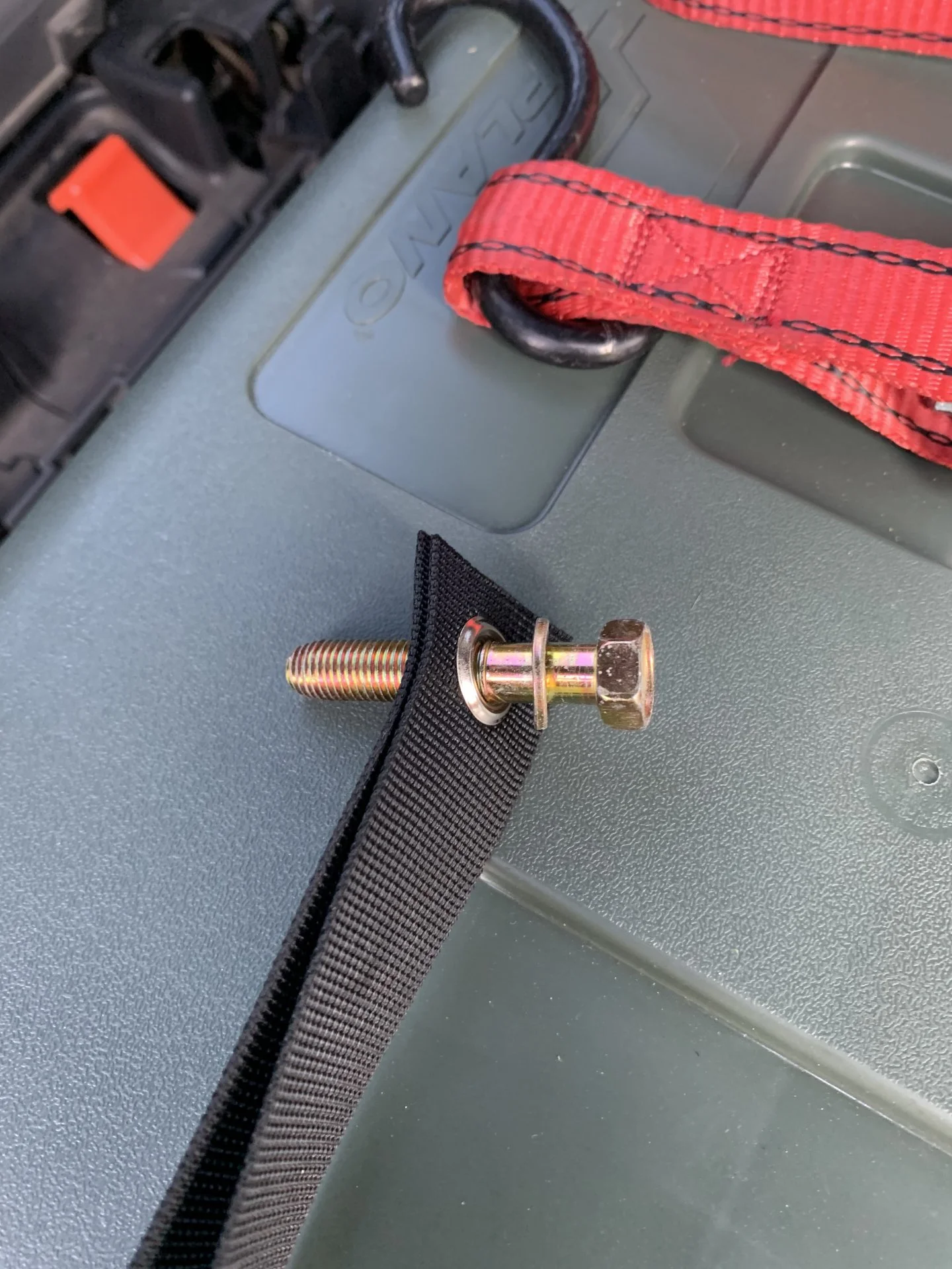

While I fret over my shocks…I added these bolt on straps where the 3rd row seat attaches. I can now run a strap across the bins.
Can you just.clip the hook into the clasp that holds the seat's bar? 🤔
Interested in shock.report..
Oh darn, wasted $16

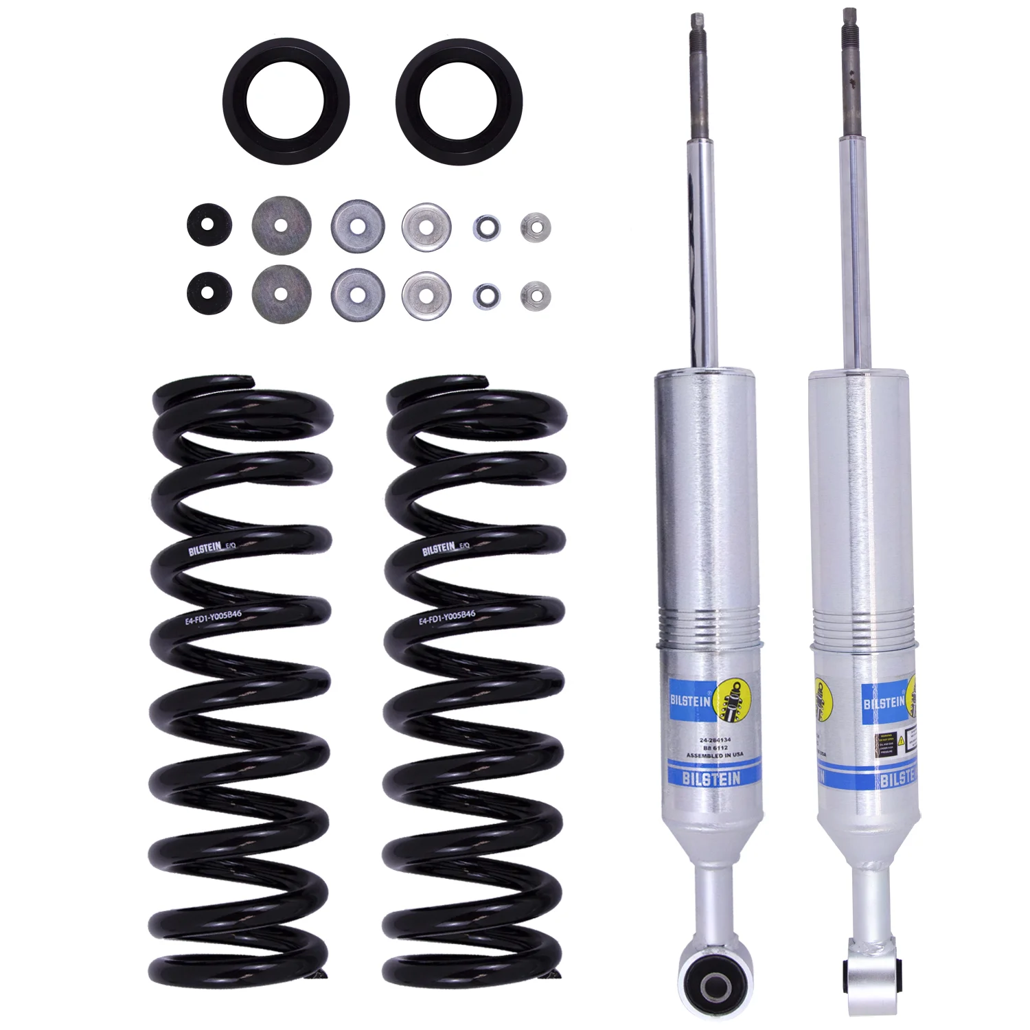

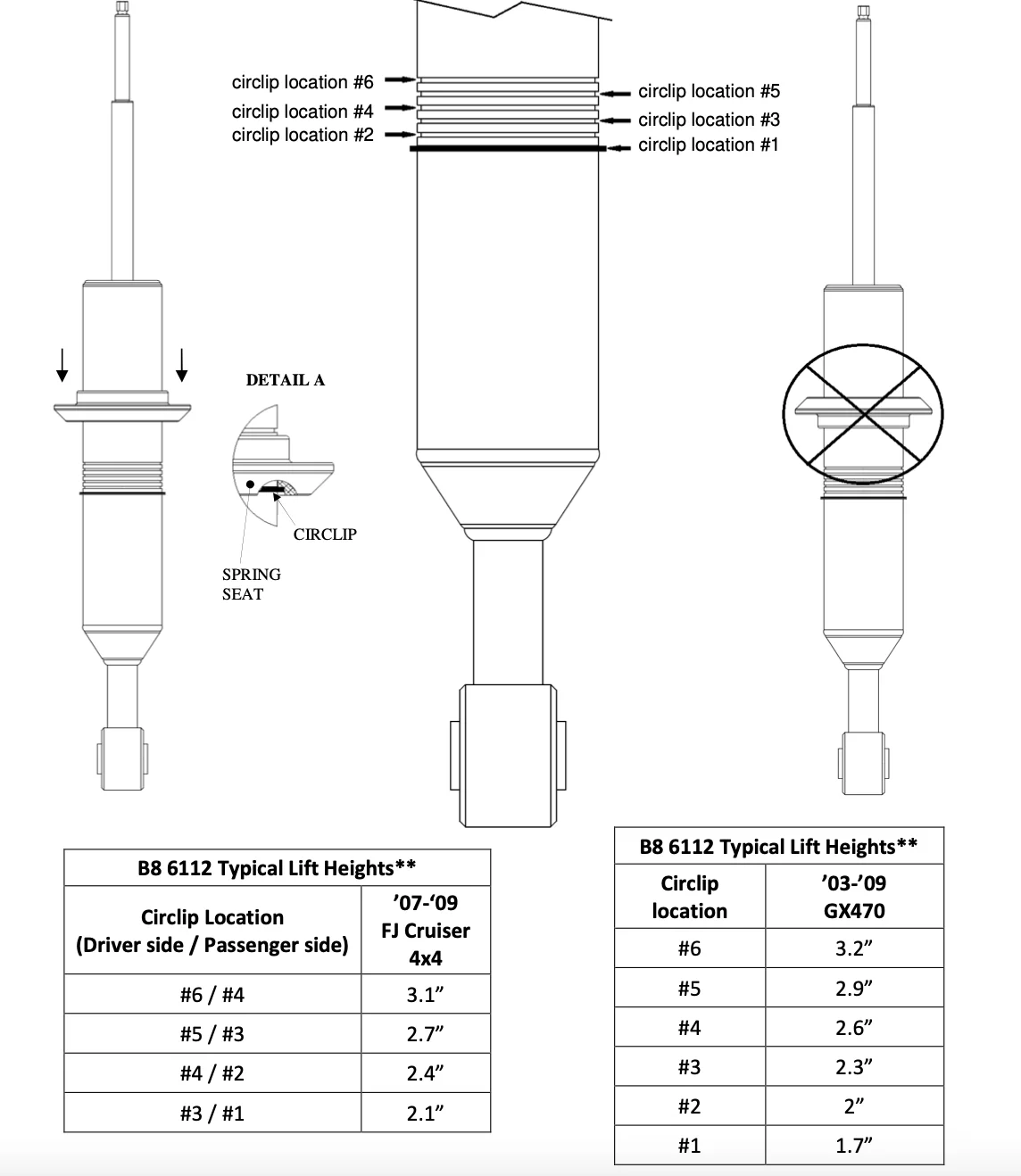

The Bilstein 6112 shocks can be rebuilt, but weren’t designed to be rebuilt. These shocks use the same parts (seals, etc) as other shocks so the rebuild parts are available. @helocat also said this in a post about USA made shocks having interchangeable internals.
In order to rebuild, a new port has to be installed to inject nitrogen to refill. The shock did not come with a refill port, so it has to be added.
This rebuild process takes several weeks due to backlog at an independent repair/service station. Moreover, the cost to do this custom rebuild costs just as much as the current cost for a new 6112 coil over kit.
So, it’s better to just order a new 6112 coil over kit. Also, the standard kit with 600 lbs/in spring is still available but the one with 650 700 lbs/in is back ordered.
In terms of costs related to the 6112s:
1. Coilover kit cost $732
2. Cost assemble spring, shock, top hat $100
3. Cost to install $200
4. Shipping/tax where applicable $73
So, looking at $1100 for this option. Keep old one that’s not leaking as spare
Other option is to ditch Bilstein and go with another brand front/rear. This option costs more for sure, but how can I get better reliability without requiring rebuilds which are expensive and take weeks if not months to rebuild.

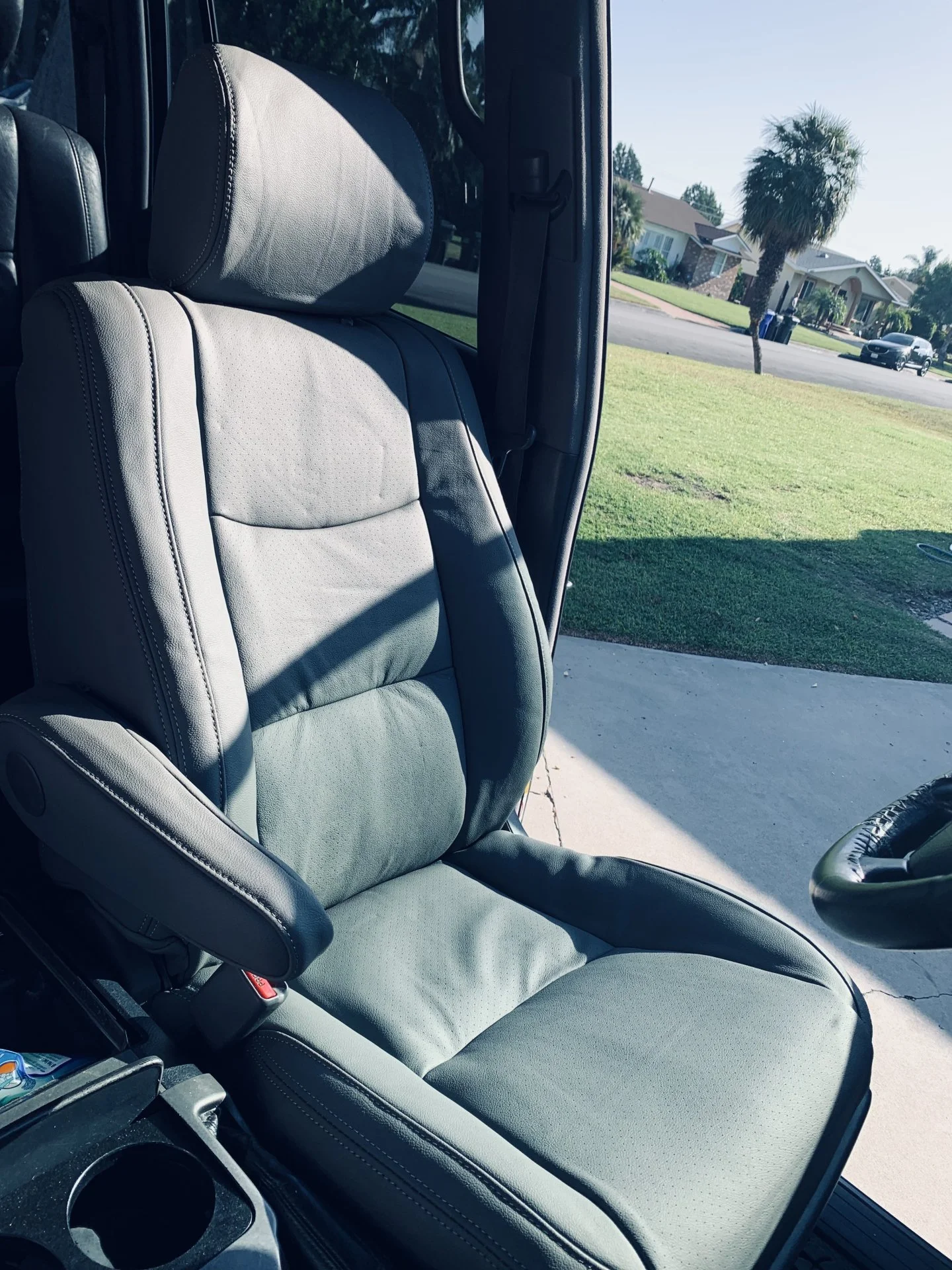

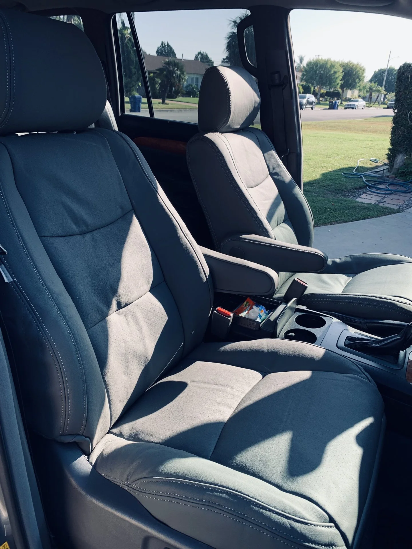

Update on leaking Bilstein 6112 shocks and my replacement leather seats from LSeat.com...the auto upholstery shop that quoted me $250 over the phone turned into $450 when I went in person. Even though he had no work that day...he wouldn't lower the price to match my 2nd lowest quote at $375.
So, I went to the shop that quoted me $375 in person and they are super busy. He cannot do it right now.
I then went to another auto upholstery shop that would do it for $400 total and he let me make an appointment for Monday morning at 8 am. Very nice guy in a nicer area than the other places. I should have done a video me driving around some shady parts of LA looking for a low cost auto upholstery!
So, the moral of the story...do more stuff DIY to save money! Replacing your front seat's leather is going to cost you around $800 total if you have a shop do it professionally. You can save half if you can do it yourself. Prices are going up for labor.
Now back to my leaking front driver shock. After crunching the numbers...for my specific situation with digressive extended length ICON 56550 shocks in the rear...my lowest cost alternative is just to replace the leaking front Bilstein 6112s. I'm also taking this opportunity to increase the spring rate on the front coils from the standard 600 lbf/in to 650 700 lbf/in (by the way I just realized that spring rates are measured in "pounds of force per inch" = lbf/in).
So, I'll keep my current coilovers as spare. And if I don't like the heavier coil...I could always swap back in the 600 lbf/in coils. The 600 lbf/in feel very smooth driving in the city and even offroading. So, we'll see how the 650 700 lbf/in coils change the ride.
The Bilstein 6112 kit with the stiffer spring rate is 47-284142. The kit with the standard spring rate is 46-227187. I ordered the kit assembled with a KYB top hat for the GX470. That was extra, but I hope to be able to follow my own DIY advice and install them in my driveway. I just need to watch YouTube videos on how to take the coilover off without disassembling it.
I originally ordered the 6112s assembled on the 4th circlip. I then found this chart and didn't want to be 2.6" high in the front, so I switched my order to be on the 3rd circlip. I did get about 2 3/8" of lift on mine on the 3rd circlip/notch from the bottom, so for me...the chart was correct. Just know that these are approximate lift heights and not guaranteed measurements. This chart only applies to the heavy load (700 lbf/in) coilovers not the standard load (600 lbf/in) coilovers. The standard coilovers have different lift numbers than those listed here.
LSeat.com leather front seat kit installed. They fit a tad loose compared to oem. Color is not a perfect match, but close enough.
