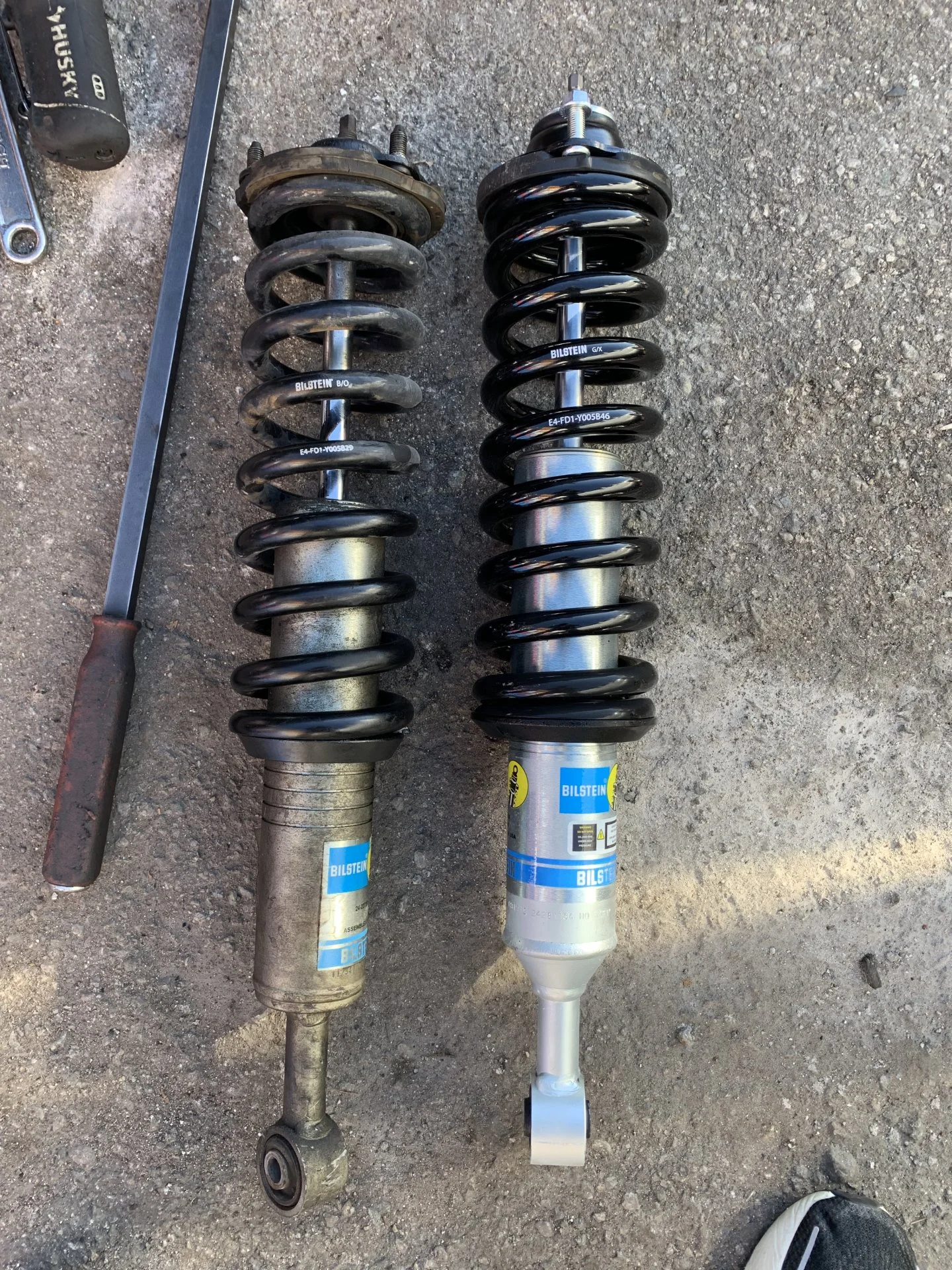

I'm at a tire shop getting my new Bilstein 6112 coilovers installed.
My current coilover was seized at the top 3-bolts in the hat. Took 25 minutes to get it out after adding penetrating fluid and using a hammer and crowbar.
My Bilstein 6112 are so original that the design changed on the new ones. Look at the shorter rod and beefier top. I didn’t realize the design had changed.
Old Front coilovers are Bilstein 6112 kit #46-227287 with 600 lbf/in coils and the new one is kit #47-284142 with heavy coils at 700 lbf/in.

Well...my initial reaction to the 700 lbf/in springs in the front is not bad. The ride home was only 5 minutes on city streets, but the ride wasn't noticeably different. Maybe a little stiffer (or as some you might say more sporty).
After a week of city driving, it looks like the front has settled a little. These Bilstein 6112s kit #47-284142 with the heavier 700 lbf/in coils on the 3rd circlip (from the bottom) is about the same as the Bilstein 6112 #46-227287 with 600 lbf/in coils on the 5th circlip (from the bottom). I'm sitting at about 22 1/2" in the front hub to fender (plus or minus 1/8").
I'm pretty level now, but I might sag a little in the rear if I add more cargo weight.

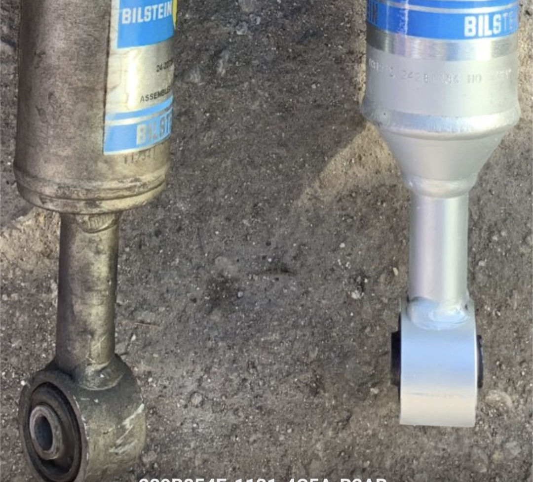

Old Front coilovers are Bilstein 6112 kit #46-227287 with 600 lbf/in coils and the new one is kit #47-284142 with heavy coils at 700 lbf/in.View attachment 2876118
Yeah that's rad, the slight differences.
Like the beefier bottom too.
I wasn’t aware of the design changes to the Bilstein 6112s, but then again I don’t follow shock design improvements for a living.

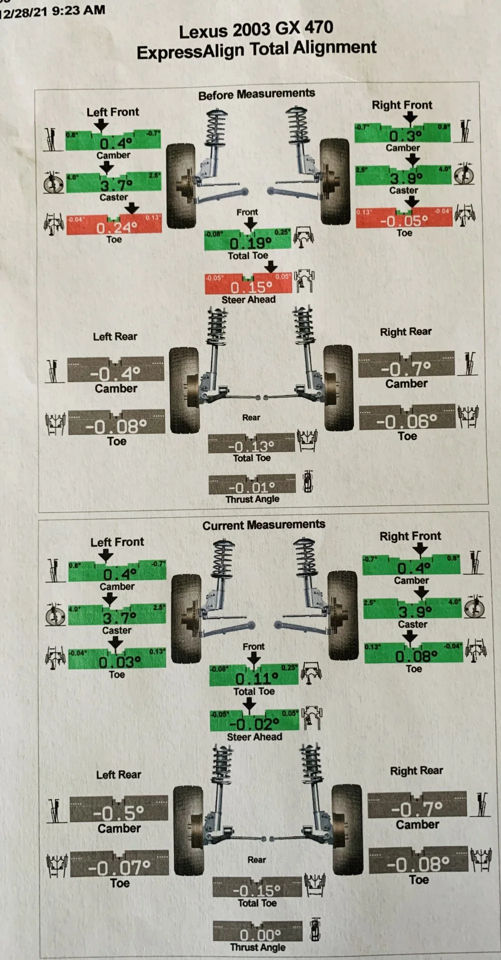

After changing the front coilovers, an alignment is due. Im at the alignment shop getting my 5th alignment in 3 years. This is the last one as part of the 3-year alignment plan I purchased on 1/05/2019 for $199 at American Tire Depot.
They didn’t try to extend my plan. Not sure why, but tires are half worn by now. Im thinking that with 50% thread left or less, no more alignments until my next set or I really misalign it bad offroad.
In my case, it looks like the tie and steer ahead got affected by hammering off off the old coilovers

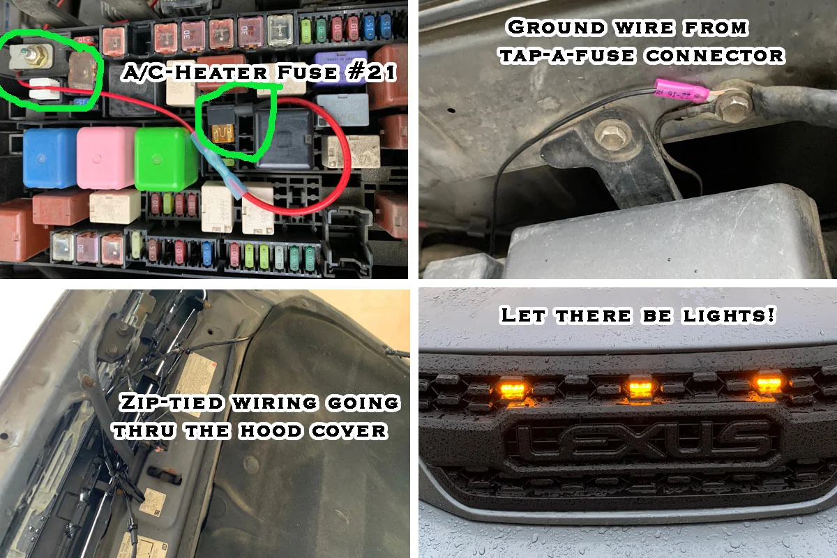

Raptor lights working now off the a/c-heater fuse #21. I updated the post on this tap-a-fuse method, but it was a journey full of turns. I'm just glad it's working. If you see me with the raptor lights on, that means I have the air on! LOL
Man, I was psyched on my install. Critical fuse.. did you have to put it like that? 😖🤣👍

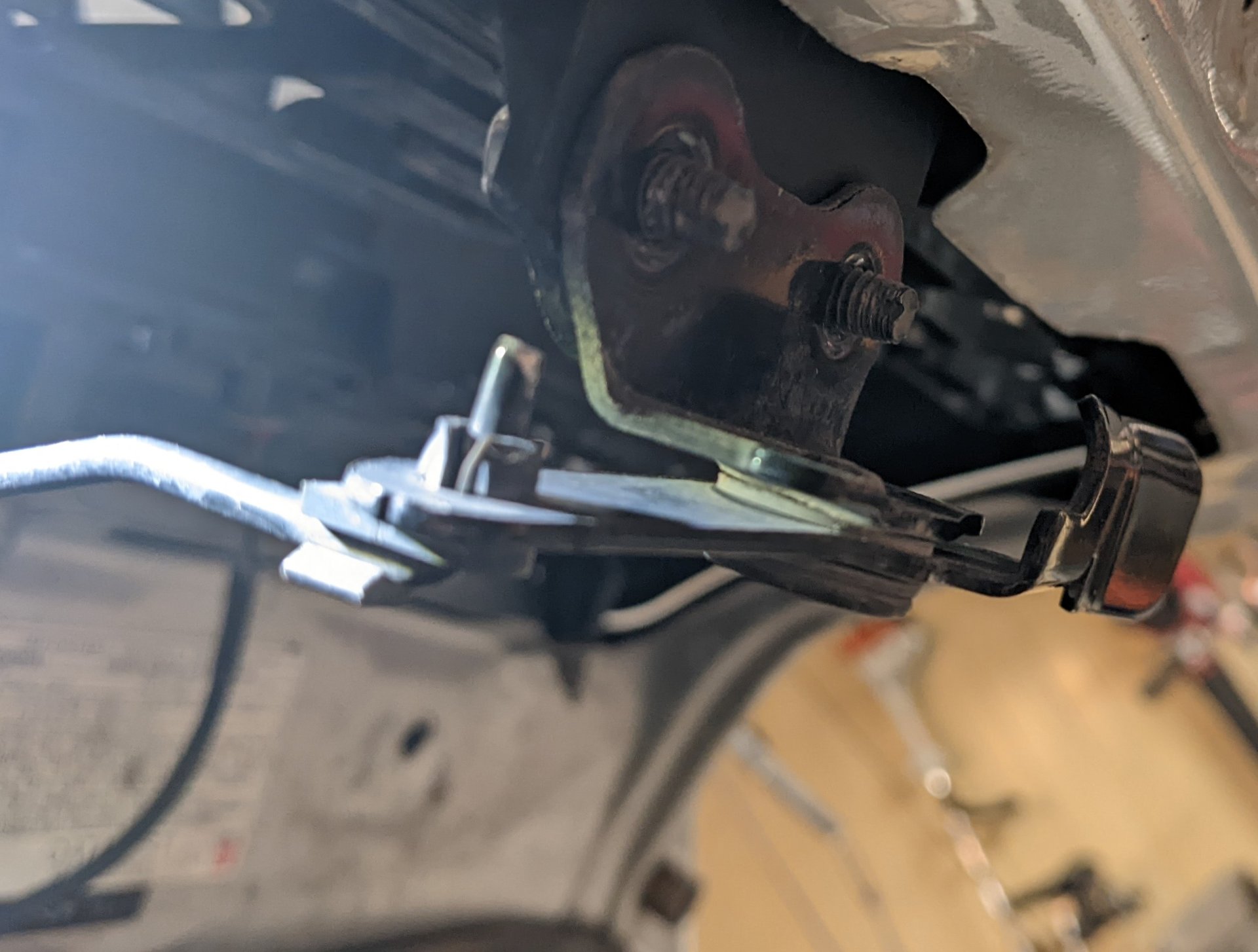

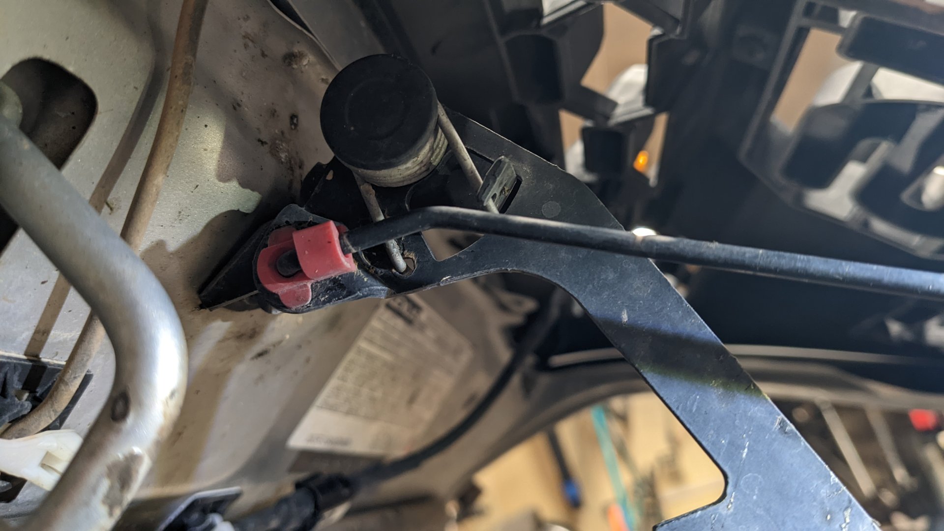

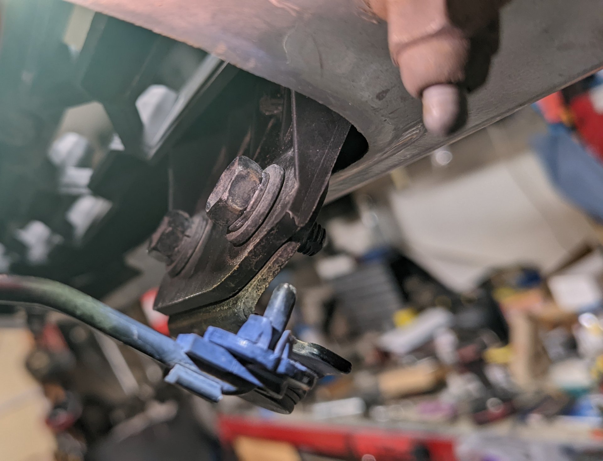

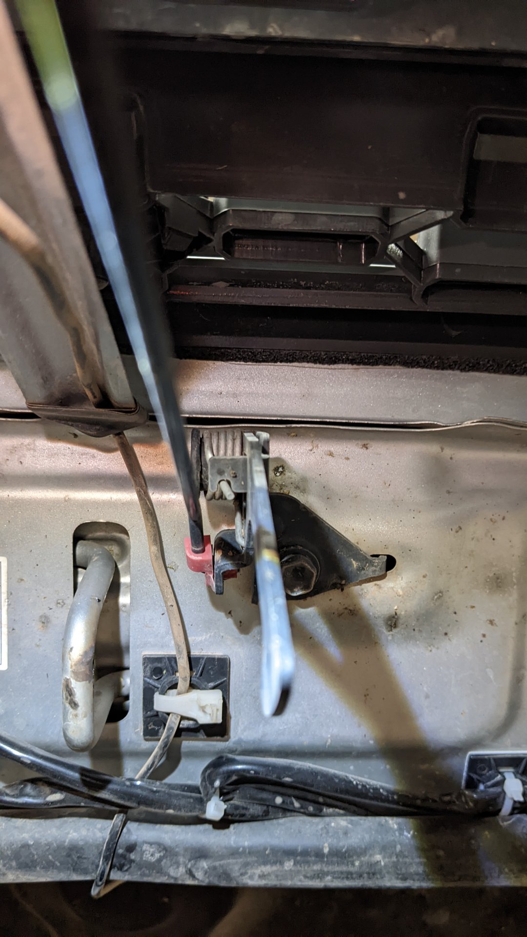

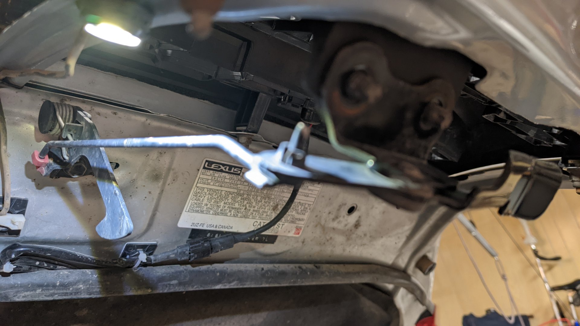

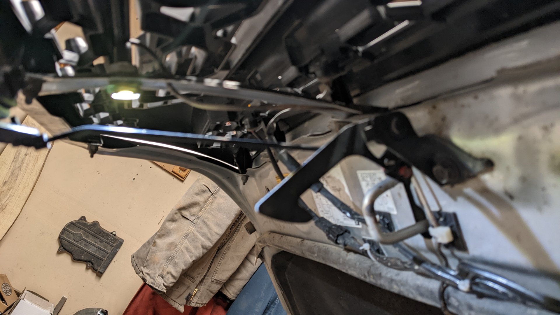

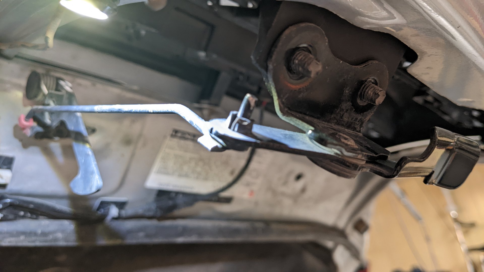

Here is the latch. The key is mounting the latch on the bottom side of the grille's mounting tab, not on the tip side..
It's still a little finicky and I think that mounting tab could be a bit better reinforced, some grind the latch hook for better clearance, I just finesse the handle side.

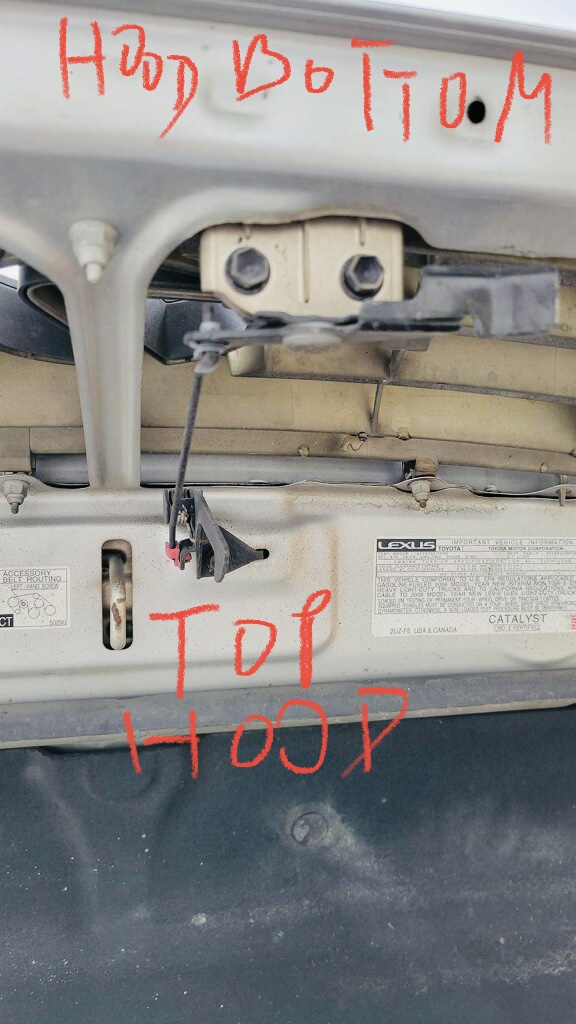

@DRANGED I checked with a friend's GX470 with a stock grille and his installation matches mine. The bolt heads are facing the ground, then the stock oem grille plastic tab, then the metal latch plate. In your picture, your bolt heads appear to be facing up (not down towards the ground). Just wanted to let you know what I found out.
Here’s his photo….
Here’s his photo….
Hmmm... 🤔
IIRC, I have them that way because:
A: when fitted with the grill below the plate, you can't unhook the latch...
B: I think the metal plate has the captive threads so i figured I'd sandwich the aftermarket plastic plate with the bolts and captive threads.... It still requires some finesse to unhook, but can be done.
I should revisit, and you can see the impression from the washer so yeah it was bolts from below, But i think the plate has captive threads so it made sense to go top-down to capture the plastic.. (but, yeah i see how stock is plastic below and bolts going up...
The first way I had it i couldn't unlatch it AT ALL...
I do wish I'd taken pix before messing with it, i was mod-eager so just got it done...
thanks for that pic!! What year is friend's GX?
makes me wonder though... That seems easy enough to mess with... I would like the hood latch to be like stock though, as it is, others can't open the hood and that's no good.

He has two GX470s. One is a 2005 and the other is a 2007. I believe he sent the picture from his 2007.
And if it's working for you, then just leave it. Mine is working great. I've opened the hood like 10 times trying to do my raptor lights and testing the hood latch!
