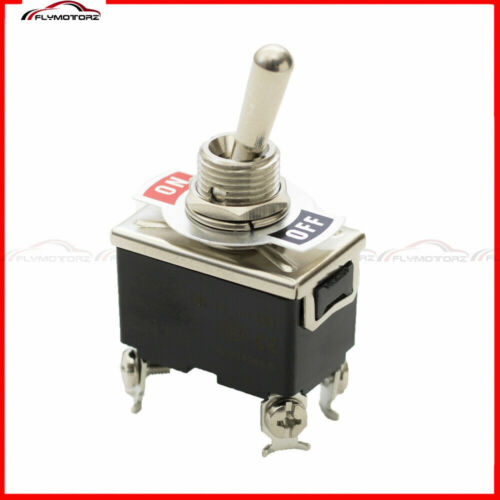

So you cut the 2 wires and extend the 2 wires originally going to the ahc to the switch and then you run another 2 wires back to the AHC connector. You're basically breaking 2 circuits. This is a double pole (2 circuit) single toggle switch(meaning that you toggle 2 circuits with 1 switch instead of having 2 switches for the 2 circuits)
I can't find any round based switches with 4 prongs, only see squared ones, anyone have any luck?
Makes sense...thank you for the explanation. Excellent work.
When searching for switches the magic acronym is DPST. Double pole single throw.
Perhaps...???
Amazon product ASIN B079R7Y5RH
Or...anything like this should work drilling a round hole.
That switch will not work because it is a DPDT(double pole, double throw), you need a DPST. Here is a link to the switch I used
Amazon product ASIN B07MV52SRM

You have two coming in and two going out so it can turn on and off, else it's just Off.

Here's what I understand of this mod, in MSPaint form. You need a DPST switch because Pin 4 and 17 aren't connected to each other. The switch is there to interrupt the signal to both wires at the same time. When the switch is flipped to OFF, it disconnects both wires/circuits simultaneously, so the AHC system cannot function. With the switch flipped to ON, it is as if both wires are connected as normal, which returns normal function.
Disclaimer: I'm a mechanical engineer (not an EE) that hasn't done this mod on my own vehicle. If this is not how it works, I'll delete later.
You're exactly right, that's how the switch works. It's basically two switches controlled by one toggle (or throw), hence the "dual pole single throw" terminology (DPST)
