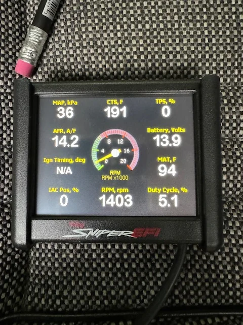

I still chase that IAC number as mine routinely and eventually winds up at zero my question becomes is there some other part of the software responsible for that because mechanically I have not been able to find anything. So in this post, I guess I am looking for some ideas on updating firmware which they show and explain on some YouTube videos….that of course passes right over my head as my computer skills are MINIMALLY acceptable …
I would love that a few will chime in here on their experiences
FWIW my IAC is zero at idle at temperature. Cannot get it to show what they spec.
@cstav86 hmmmm. Good to know. Thanks for that. My truck runs great. Starts well so besides that, I’m happy with this and the new spark plugs and wires smoothed out the idle even further
@cstav86 and other Sniper EFI users….. decided I was anal enough to go thru each step with painstaking care and spent over 3 weeks installing the EFI, I could not live without having tortured myself by waiting 22 minutes on the phone waiting for Holley Tech Support. Gotta say that after 6-8 minutes that 4 bar beat “music on hold” has to be designed to make you hang up. At about 18 minutes you start not to hear it.
Believe me I am happy to have a way to get in touch with them…they are always nice, easy to deal with and are sure you understand their information… but at my age maybe I don’t want to kill time waiting for some things so I become cynical with MANY things during the day.
So…what happened…. He told me to start the engine, bring it up to operating temperature. Remove the air cleaner and block off the little triangle on the flat part of the throttle body with strong tape. Back out the “carb throttle screw” to about 50 rpm less than the setting you have in the initial setup file screen. Remove the tape and your IAC will respond differently. Restart.
EDIT: 2:27am. Forgot to add….re-adjust the carb screw accordingly

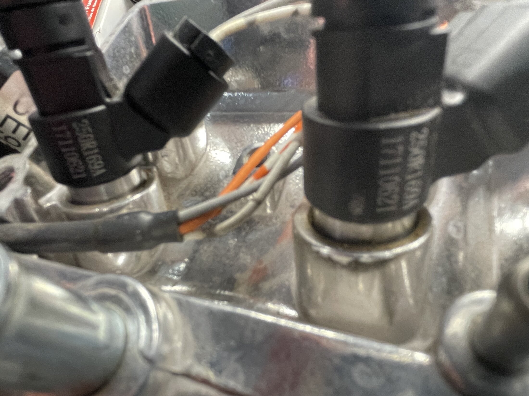

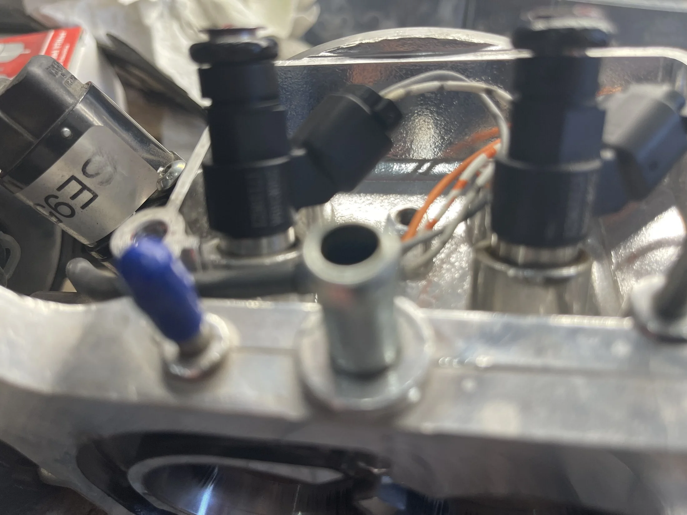

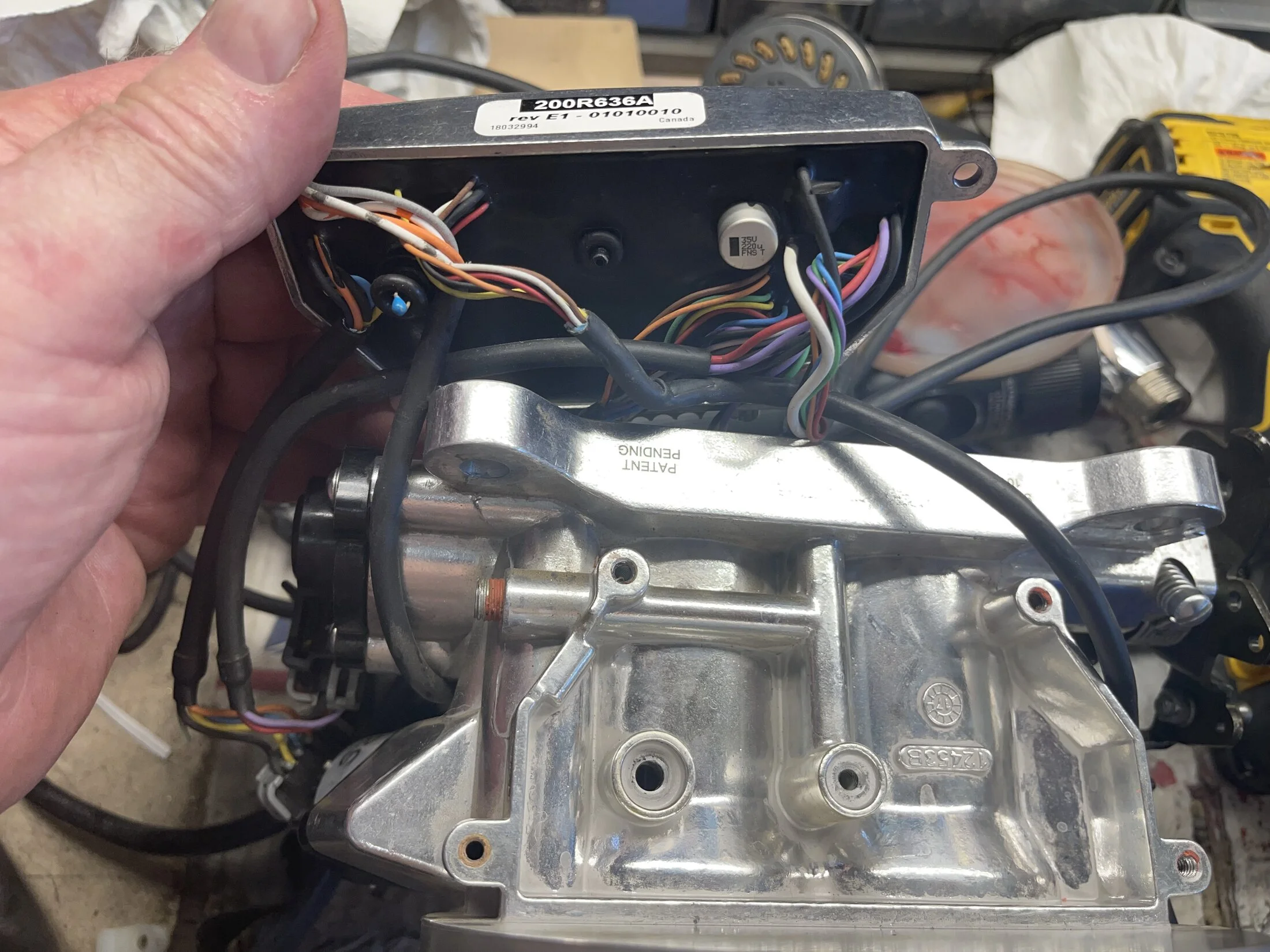

Here’s what is under those side covers. Solid state electronics (firewall side), and a look at the injector's on the other side.
@mrboatman thanks for these pictures. It makes a lot more sense seeing this. Especially when @POTATO LAUNCHER and @cruisermatt posted about replacing injectors with Bosch ones and just changing o-rings. Lots more to it than I figured. My goal is to be trouble free for a few years…by then I’ll be older than I would want to be and probably need a cushier ride, like a La-Z-Boy.

Well, I had honestly never looked at IAC. Setup the sniper a couple months back. Been starting it regularly and letting it get to temp but not driving (still finishing some things up). So I gave it a check yesterday. After I started it was around 12-13, as it warmed up and rpm came down so did IAC to about 6-7. Then i revved it a few times and it settled in at 3 at idle.
@MOTOV8R well, from everything I have been able to extract from reading, video and telephone calls…your setup seem ideal . Doing mine today based on the recommendations from Holley and I hope to wind up accordingly. Of course, I’ll post those results
