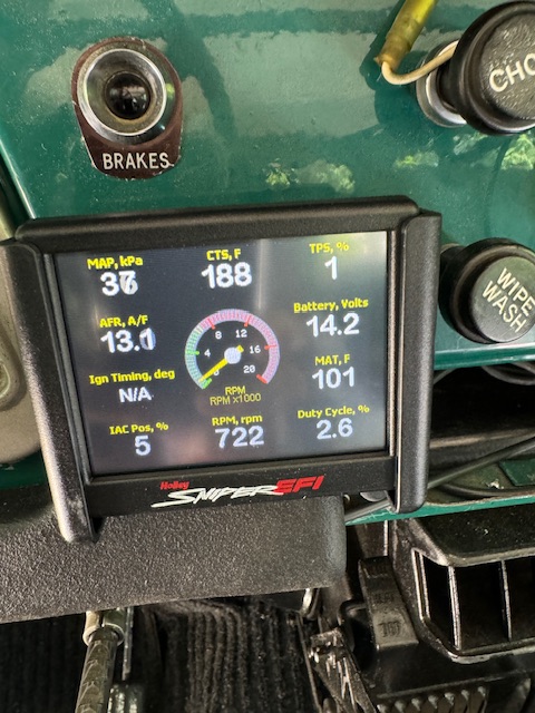

Well, I had honestly never looked at IAC. Setup the sniper a couple months back. Been starting it regularly and letting it get to temp but not driving (still finishing some things up). So I have it a check yesterday. After I started it was around 12-13, as it warmed up and rpm came down so did IAC to about 6-7. Then i revved it a few times and it settled in at 3 at idle.

This is what my instructions looked like. At the time I just wanted it to stop being at the 2500 rpm it started at out of the box. So found the idle adjustment screw and dialed it in to 650 rpm after it was above 165 F. I never looked at the IAC display until yesterday.
Since this is a FAQ style thread, just to be clear. That is not the idle screw. The idle is set by the computer, whatever you decided you wanted it to be during the Wizard.
From experience I’ve been doing 750-800 depending on the patient. Some like to fight when warming up by dying at stoplights pre-165 and those usually get a higher base RPM
What you adjusted was the IAC screw. You just happened to nail it without knowing it.

5) once at 165 degrees adjust your IAC. If the TPS starts to creep up. Turn it off and restart it. That should reset to zero.
After trying the technique told to me by Holley Tech Support…it seems to have worked…took a few up and down adjustment of the RPM and pumping the throttle here and there but this has been a pretty steady read out for about 6 minutes….never had that before. Now I can put the radio back and tidy up the rest of the wires behind it
When you shut it off and back on see if the TPS goes to zero.
@wngrog … you may find this funny… I mentioned I have a LINKS page in the computer to reference all of the Sniper installs and adjustments on videos etc. I was just on your install of Texas Red…page 3 post number 59 where you explain how the IAC was out of whack due to a previous vacuum leak and what to do to fix it….word for word from Holley in the phone conversation I had with them on Thursday…
Anyhow, the TPS did zero out on restart. I also bought a new timing light where you can set your advance and follow the bead in the observation window. I believed it was set to 8-9 degrees BTDC..,it was at 5. Brought it up to 10. Running nicely. I might try 12 but I’ll let it run a few days before I do that. With this new timing light, you can drop a degree or 2 and see the BB drop behind the pointer and then bring it back up and over for more advance. I’m sure you have one. I hadn’t bought a timing light since the mid 1970’s
Regardless, thanks again for pointing me in the right direction
