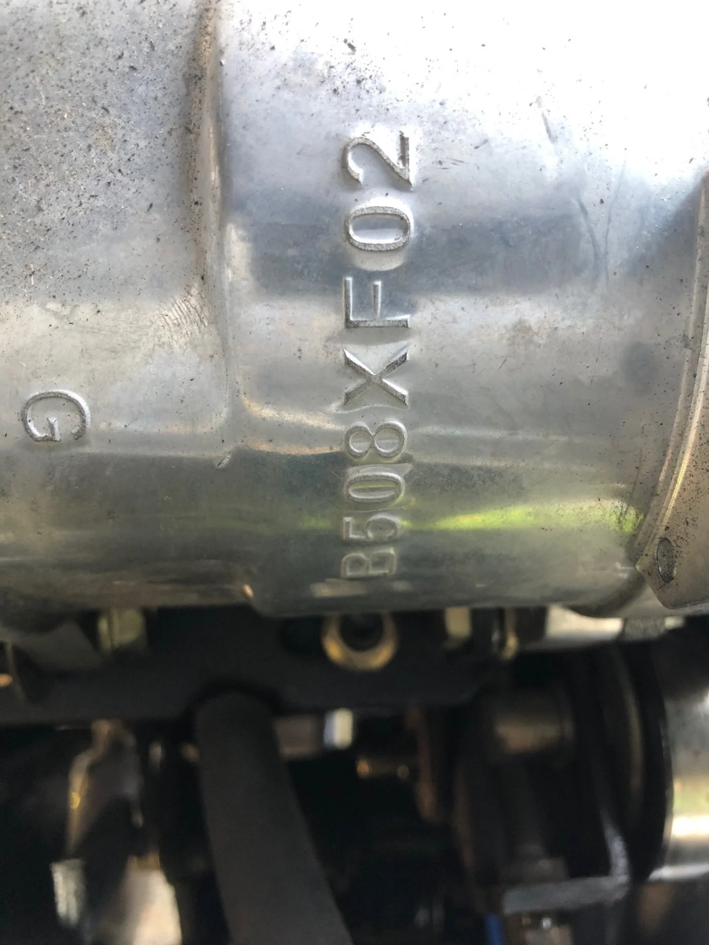

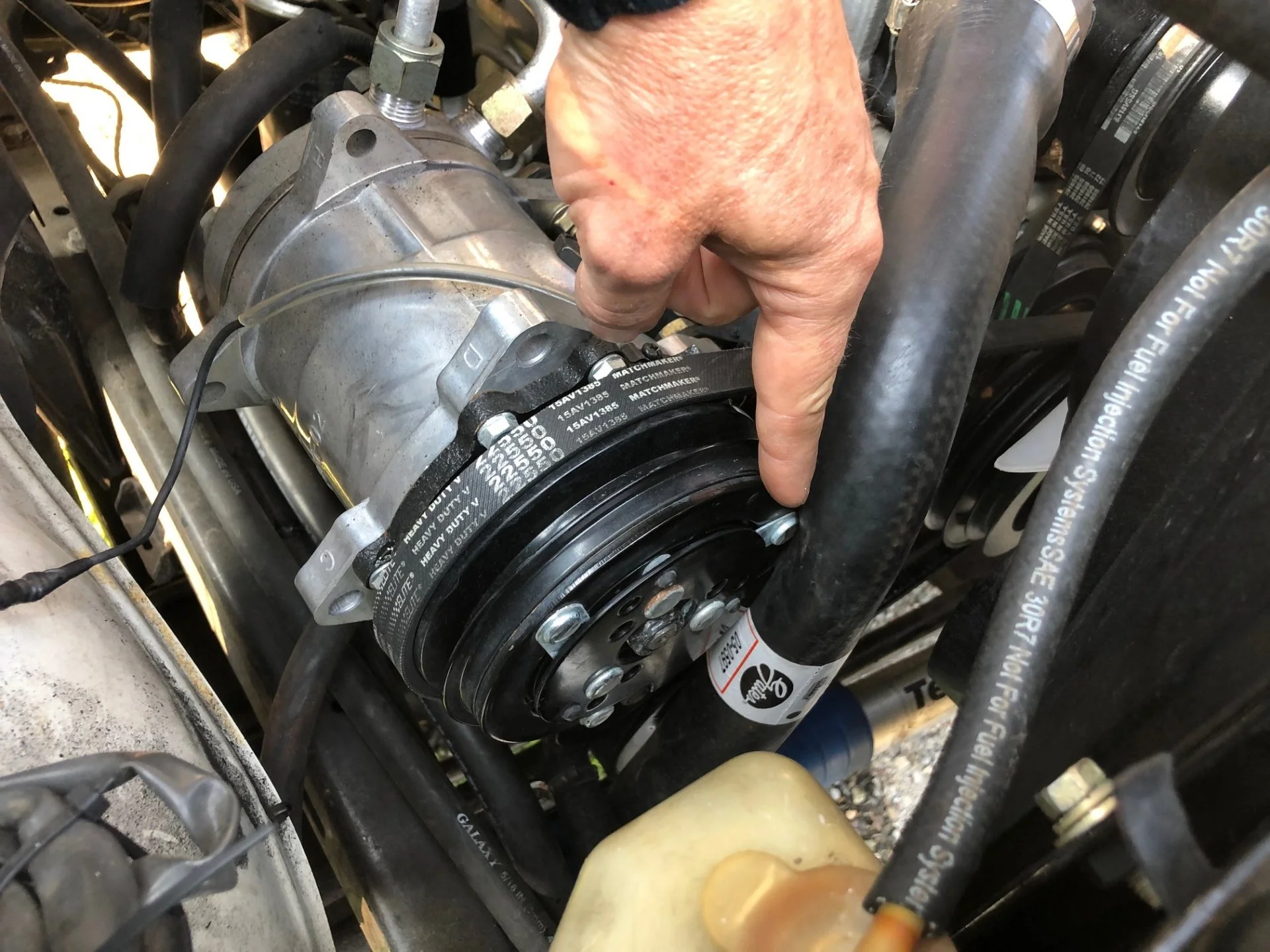

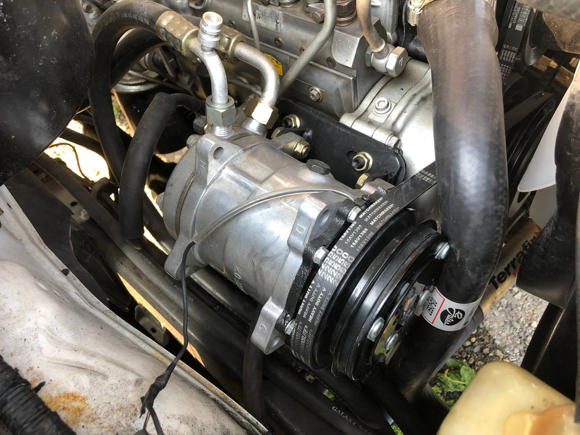

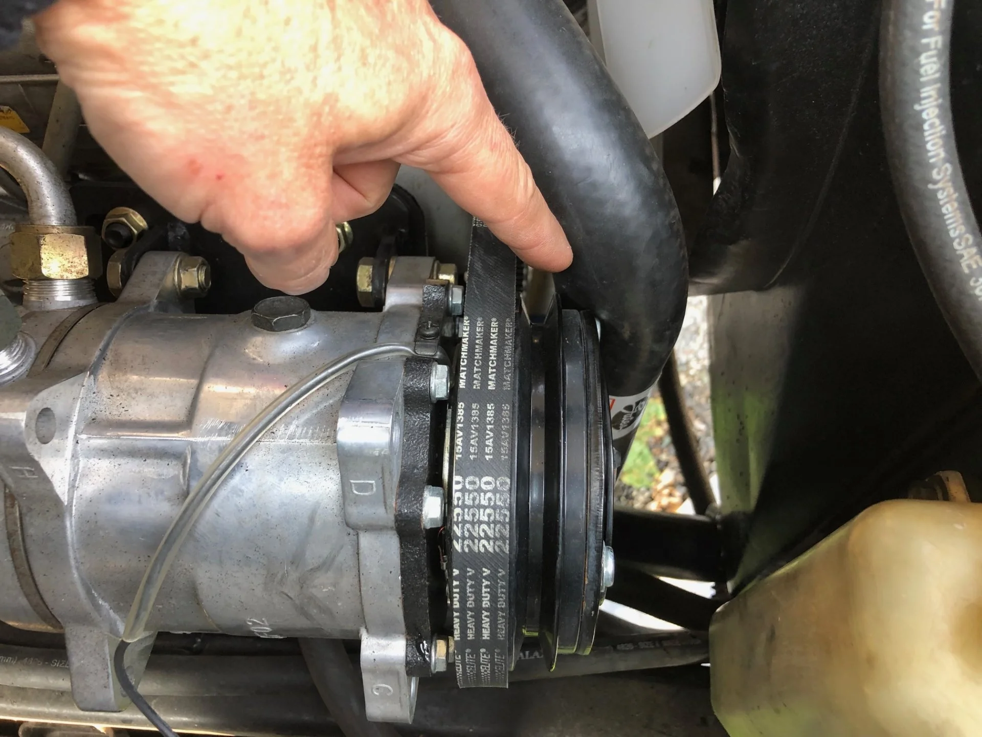

Hi there, I have a little bit of an issue. This troopy is new to me and after I drove it a little, the radiator hose had a huge leak. after inspection, I noticed the radiator hose was rubbing on the air con compressor. I thought, I'll just get an original 1988 HJ75 hoes kit and the problem would be fixed. Today I installed the hose and there is no way this will work. The air con looks aftermarket, has B508XF02 written on the back. Do I just remove the air con and sweat it out, is there a different compressor I can get? Any help is highly appreciated. I've attached pictures of the compressor and where it rubs on the hose.

i think the compressor is mounted wrong.
has to be moved to the other side of the mounting tabs on the bracket. that should pull it away from the hose, and allow you to use the front groove on the pulley.
just spit balling based on the first pic.

Thank you, I was wondering about that. I'll see how I can remove the compressor and move it. Stay tuned.

Agree with you but unfortunately it looks like the pulleys are aligned where they are. In other words they will be misaligned when he mounts it correctly - but like you I'm just going by the photos so could be wrong.
I think you are going to need a different compressor.

thats what i was thinking too, then i noticed that the compressor bracket mounting bolts have slotted holes.
i think it'll work with some fiddling.

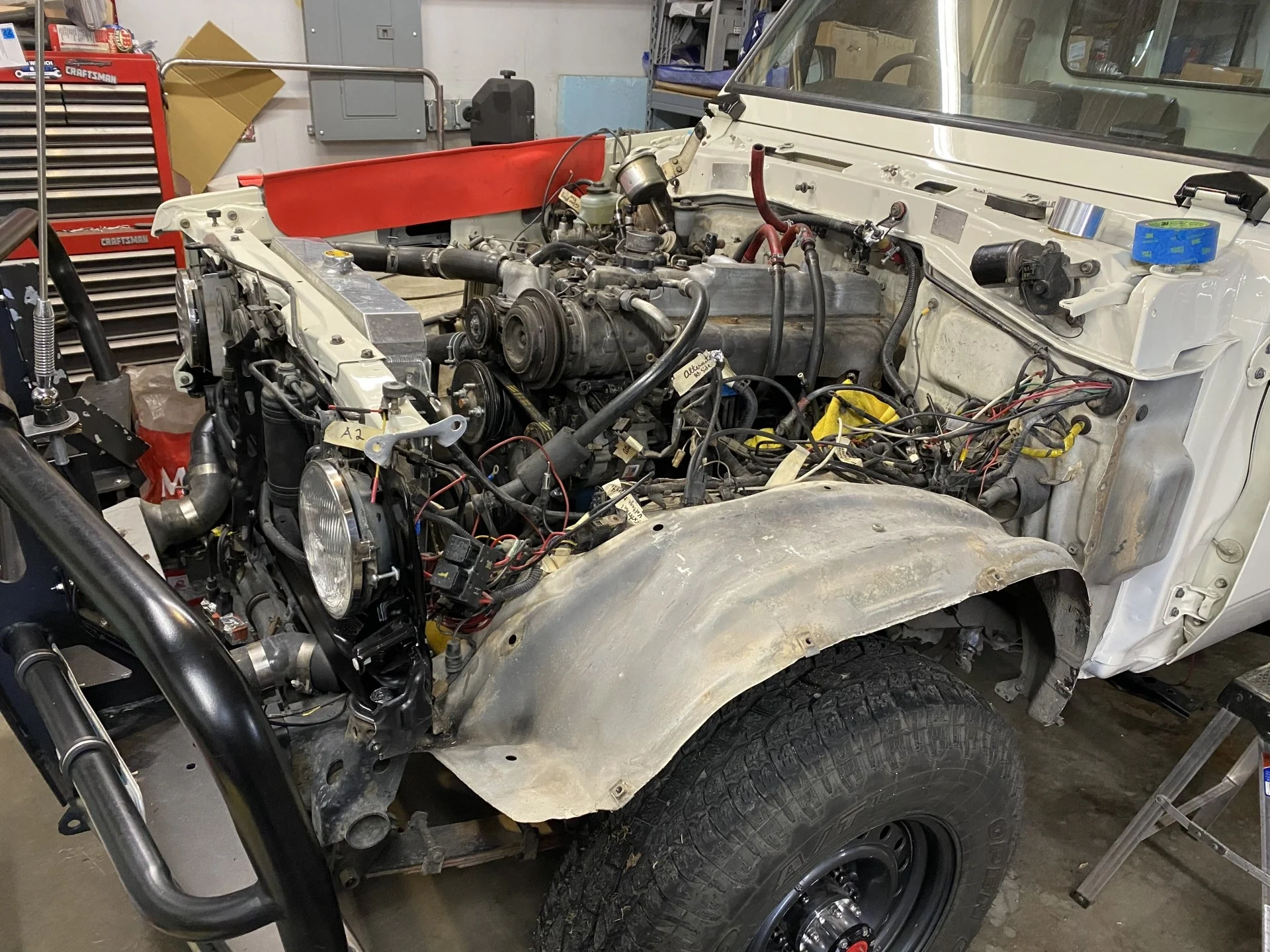

Borrowing the picture above I circled the factory ac
Copy that! Thank you! I just found that image on the web. All that makes sense. I think I'll remove the aircon, get the rest of the engine bay in order and maybe bring the aircon back in the future. I don't really like air conditioning anyways.

I had it custom built in Australia to my specifications :)

Not a lot of help here... that is definitely an aftermarket AC compressor install. Very similar to the way they did it on my FJ75. That said, if your radiator was fed from the thermostat to the top of the rad it wouldn't be an issue.
