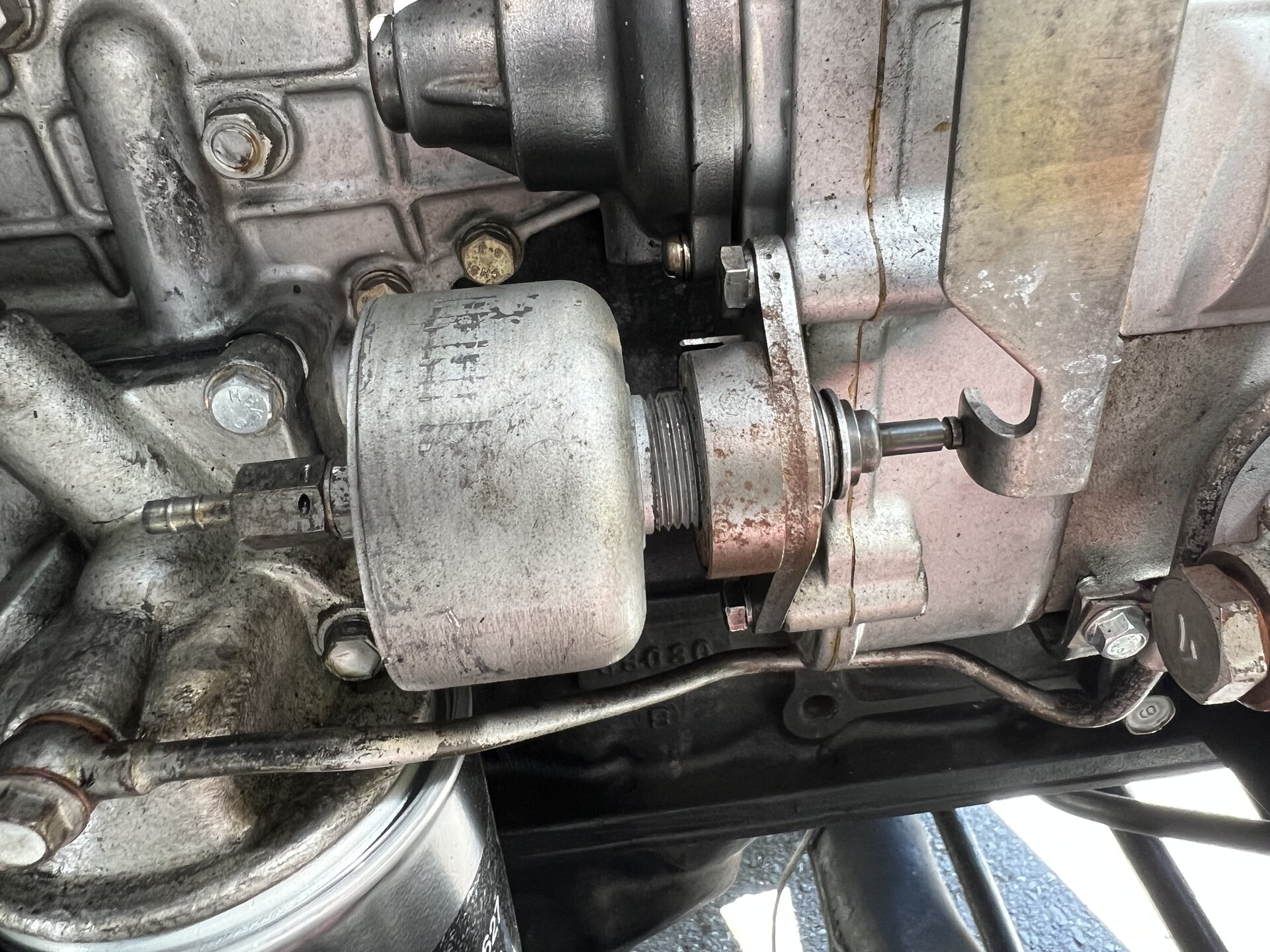

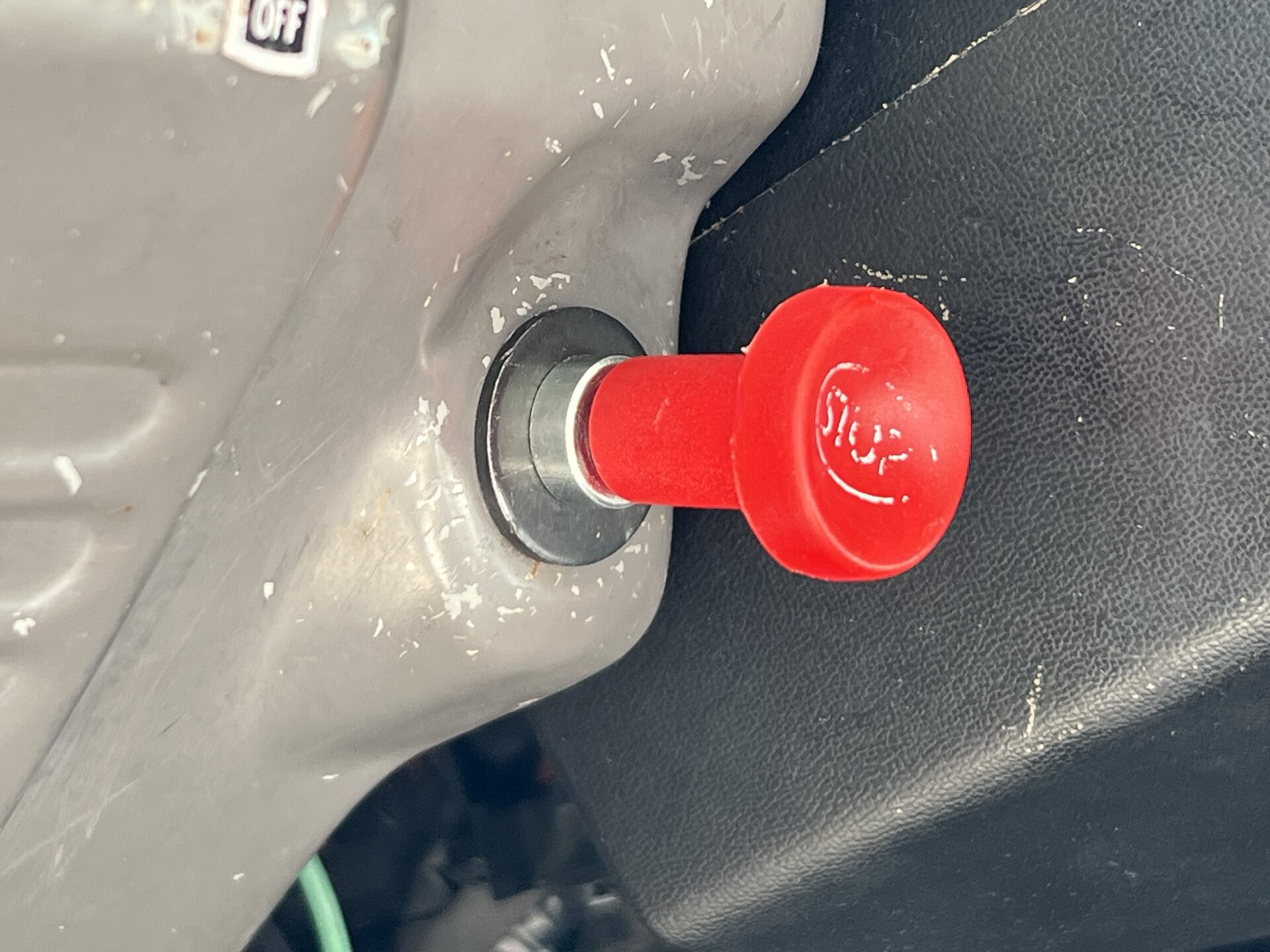

I have a 1988 Hj75 with a 2H that has a hard time starting. My ignition switch is disabled, so I have this pull kill switch, see picture. Starter is new-ish, battery is good and fully charged, cables are new-ish. The only thing zu haven’t touched is this, see picture.
Any ideas? Thoughts? When I wiggle and ouch and pull the levers She usually starts, but it’s not super reliable.
Thank you!!

The ignition works for start, sorry, I didn’t make that clear. Sometimes she just doesn’t want to start and I think it’s maybe that kill switch.
prolly nothing other than that manual knob. in to run out to stop, or vise versa, ive seen some wacky stuff over the years

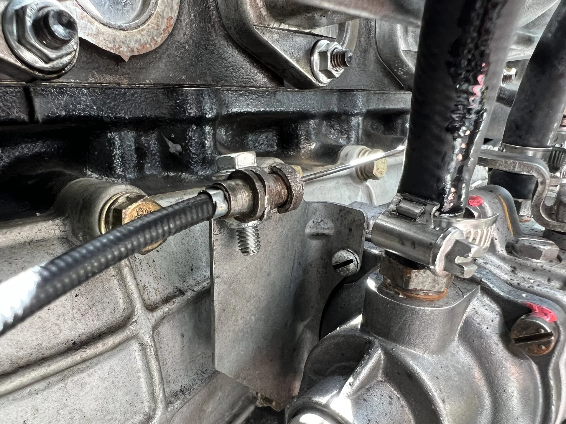

if i make assumptions based on the info given i'd say you need to play with getting that cable adjusted on the fuel cut lever
Of course we’re on a trip right now, I’ll nurse her home and try to make adjustments or replace it.
Thank you!
That fuel cut switch was probably put in because of a bad edic/computer issue. It’s purely a fuel cut off switch. Disconnect the rod and puts the lever forward while someone starts the car. If it starts, the switch is fine and I’ll bet your connecting rod needs adjustment.

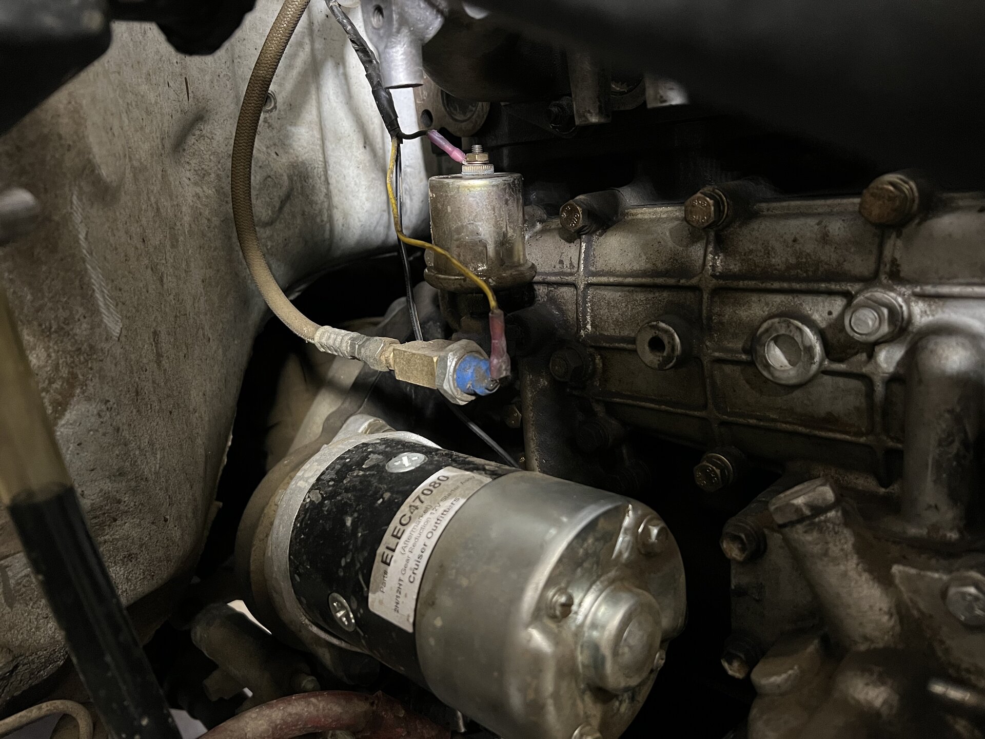

One more question: what is this and how do I test it.
Looks like an after market oil pressure sender, perhaps even autometer. It is not factory. The oil cooler housing is a typical place for folks to install aftermarket oil pressure senders.
Hmmm. Good idea! I’ll do more wire tracing. Thank you!!
Ha! You’re absolutely right. I traced it and you’re spot on. Thank you!

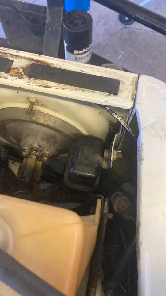

Traced all wired to try to find a starter relay, to no avail. Is it built into the starter???

I can not find any documentation on where the starter relay might be mounted, I can not find one.

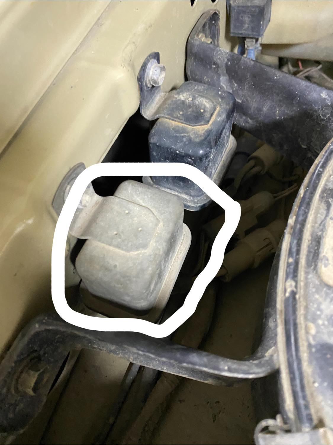

Unless this vehicle has been converted from a petrol vehicle, it'll have a starter relay (especially if its definitely an unmolested HJ75 ).. it is most likely on the inside guard behind the air cleaner. Click the ignition and track down the clicking sound.. there's a very strong chance the contacts are pitted based on what you've reported.
I think this photo is an HJ60.. just to give you an idea what you're looking for..
Thank you! I also thought it must have a relay, I’ll look again in the morning and keep you posted.
If you're getting click no crank, the fuel control has absolutely nothing to do with your issues.
First port of call would be starter relay.
Possibly near your right hand side headlight it seems..
