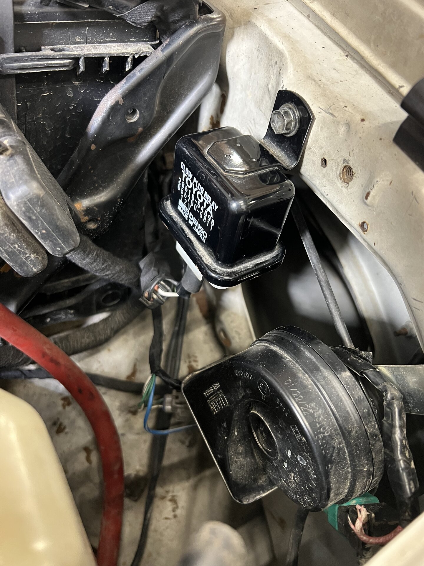

Here is the starter relay in the original position. I removed the glow plug relay since I am not using it.

That engine bay looks spectacularly clean, a credit to you.

Here is the glow plug relay and the passenger side all empty.
She is a 1988 HJ75 LHD from Costa Rica.
