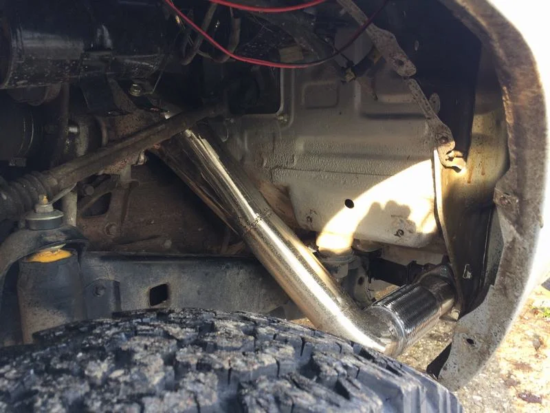

So, I finally got all the parts sorted out for then new 3" exhaust.
As a damper I'm going for the Jones JT-3030XL
I't quit big, but will fit in nicely between chassis rail and the sill. I'm going for a side pipe, in order to avoid the tricky bend over the rear axle.
Inner fender removed. I'll need to modify that one as the exhaust will pass through it
I got a flange that bolt straight to the turbo from Wink4x4
Since it's stainless steel, I needed to either get new gas and welding wire for the MIG welder or go with electrode welding.
For this I chose the cheap way and decided to use electrodes for welding.
Never done it before, so made a few trial welds. Not to bad for a first timer.
I opened up a 90 degree elbow, as I start with the oval shape on the turbo.
Also opened up the 3", 2mm thick pipe I got to taper it down from oval to round.
Damper roughly in position
main items tagged in place
Trial and error with welding position and settings, but I got a good hang of it
Again, trial and error. Some welds are good, some require some grinding...
This is it for now, coming week I'll continue.
I'l get a flexible part directly after the elbow directing it horizontal. I also got an addition flange, but i'm still not sure about necessity of making the exhaust partible... What do guys think?
The exhaust is finished!
I made the split right behind the flexible part:
For a first timer with stainless steel electrode welding, I'm pretty excited with the outcome
Bracket for mounting
Tagged in place
Exhaust in place, Only have to cut my inner fender to make space for the 3"
Bracket in place, right after the flexible part
The end result!
The sound is awesome!! When the engine is working hard, it makes a deep roar followed by a very nice wissle when shifting gears.
When cruising at cruise speed the sound is comparable with the orignal, a little louder and deeper.
This is the exact combination that I was looking for.
Allthough I find it difficult to judge, it feels as if it has some more power, and picks up quicker at lower revs when accelerating.
Step one is (almost) finished. Just need to get the inner fender back in place. Next big project might just be an intercooler.... Or one of the other things on the wishlist ;)
