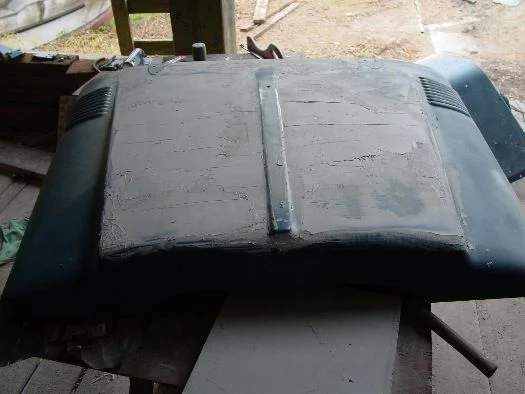

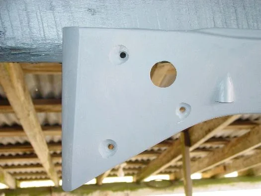

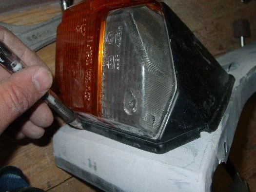

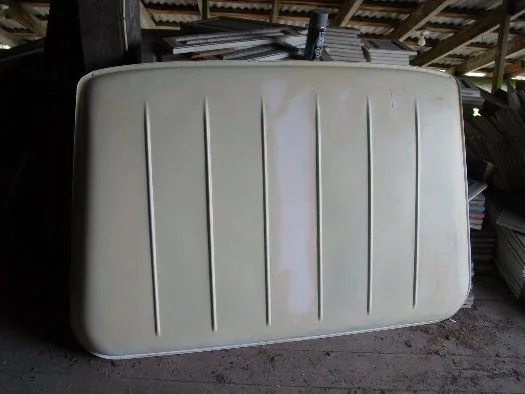

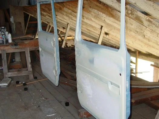

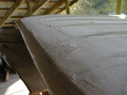

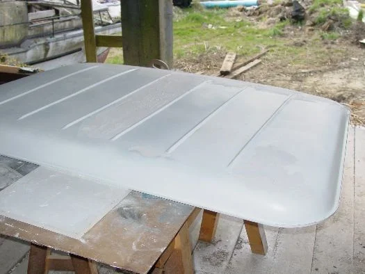

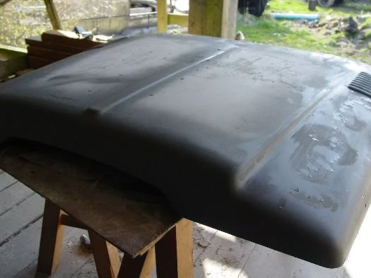

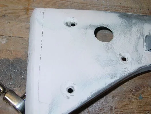

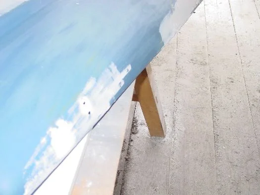

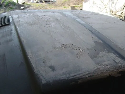

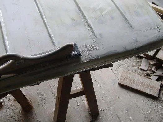

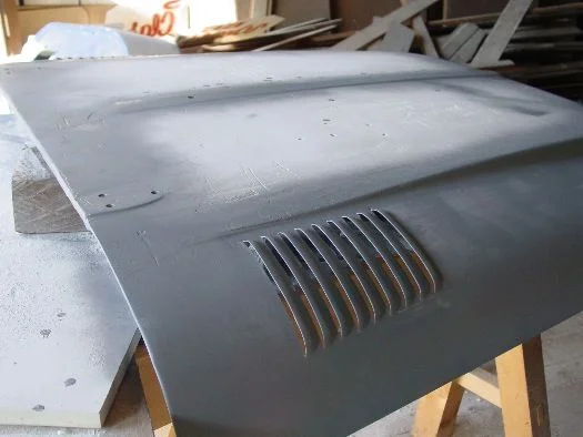

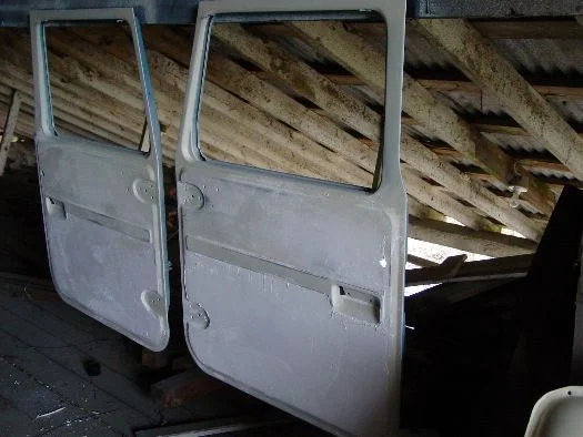

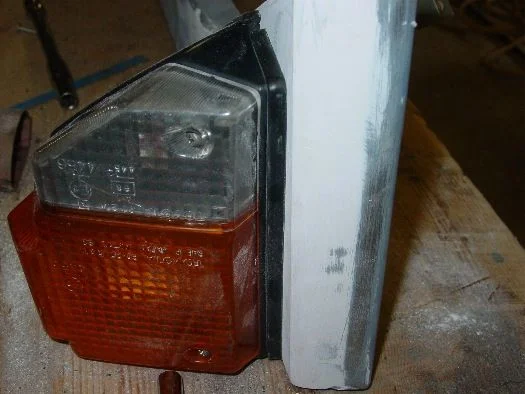

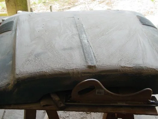

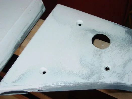

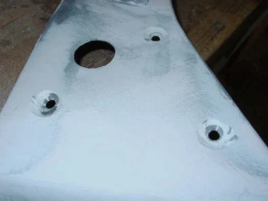

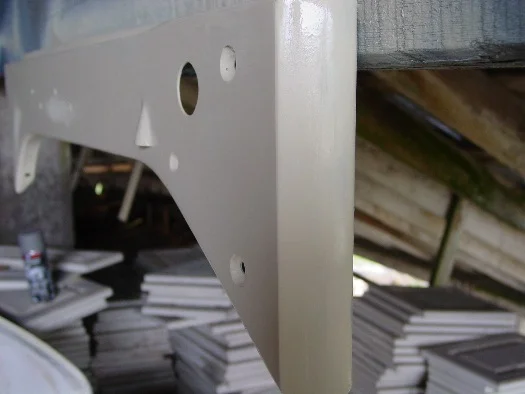

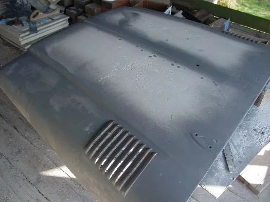

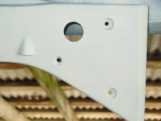

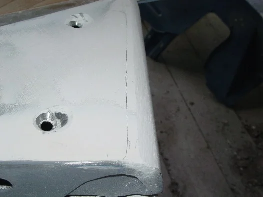

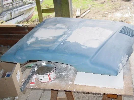

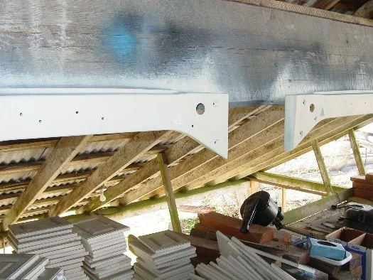

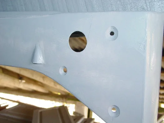

Put in a solid 7 hours on the 47 today, mostly on bodywork, and starting with the aprons
more to look at. Besides the bodywork, i also put 10.5 volt glow plugs, NGK 7493 Y-147T, into the 2H. That didn't seem to resolve the overheating of the glow controller coil however. I will re-focus again on the electrical snags soon enough, but right now i'm concentrating on the body filler work. I'm giving myself until the end of the month to finish the 9 panels, and then another 15 days to do the tub and upper cab.

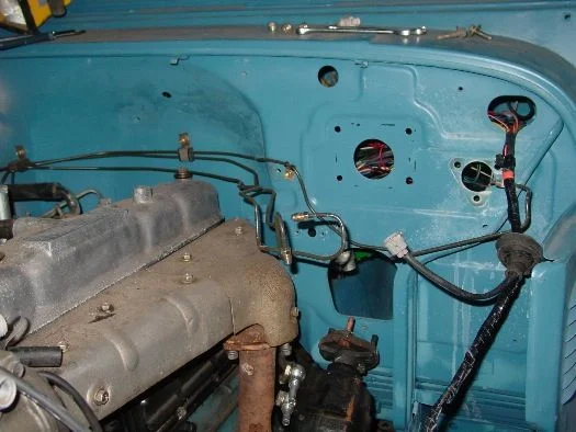

I also pulled the clutch and brake masters, and the pedal bucket from the firewall.
