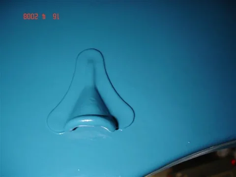

another couple of the apron catches - they are now getting some plastic filler on them, and I'm slightly flattening the lead edge so as to get a better seal with the front of the 70 series marker lamp housings. Pictures tomorrow of that.

On another subject, if those hood hooks are stainless they'll react with the mild steel where they hook on. (Because it will be impossible to stop metal-to-metal contact there and rain will add the electrolyte for electrochemical-reaction to occur.) The stainless of the hooks will also eat into the thin mild steel through wear.
I've noticed that the factory hooks have the metal folded over in the centre of the female component to double its thickness there (and thus combat wear).
To prevent electrochemical reaction and wear I've actually brazed a stainless lip on my apron-mounted female components. (I'm at work now. If I was at home I'd post a photo.) I'm hoping my paint will stop electro-chemical reaction where the different metals meet while the rod-lip will prevent wear from becoming a problem.

That's a good point about the dissimilar metal contact issue with the hood hooks. The factory ones I have seen have usually been a little eaten away at the point of contact to the hood hook tip, and it hadn't registered that the cause might be due to something more than wear and tear.
You mentioned that,
"To prevent electrochemical reaction and wear I've actually brazed a stainless lip on my apron-mounted female components. (I'm at work now. If I was at home I'd post a photo.) I'm hoping my paint will stop electro-chemical reaction where the different metals meet while the rod-lip will prevent wear from becoming a problem."
Didn't the brazing eliminate the paint at the point of contact between the stainless lip and the apron mild steel? It seems to me that there would still be electro-chemical reaction happening, though the greater surface area might reduce the erosion (?).
I'm not too worried about it, though it does give pause to consider if I should do something about it. Were the factory hooks stainless steel or not? If not, then perhaps the simplest route would be to put mild steel hooks on and paint them?
I was planning to isolate the stainless hooks from the hood by using a small piece of duct tape in-between.

.....That's a good point about the dissimilar metal contact issue with the hood hooks. The factory ones I have seen have usually been a little eaten away at the point of contact to the hood hook tip......
Like this HJ? - Note the bit of folded-over sheetmetal too.
........Didn't the brazing eliminate the paint at the point of contact between the stainless lip and the apron mild steel? It seems to me that there would still be electro-chemical reaction happening, though the greater surface area might reduce the erosion (?)............
What I mean is that the NEW paint will stop the electrolyte (water) from getting at the junction between the dissimilar metals HJ.
These photos will explain:
..... Were the factory hooks stainless steel or not? If not, then perhaps the simplest route would be to put mild steel hooks on and paint them? ......
Stock hooks are painted mild steel but I hate the rust streaks that they leave down both apron sides. That's why I've gone to stainless like you have HJ.

That's a tidy job on those catches, Tom. I'm now inspired...
I'm thinking about a brass sheet, folded and wrapped around the lower lip, maybe soldered, would be a solution. I figure i can find some at the hobby store.
