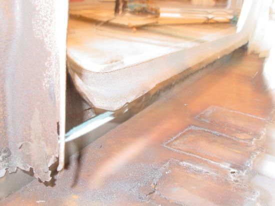

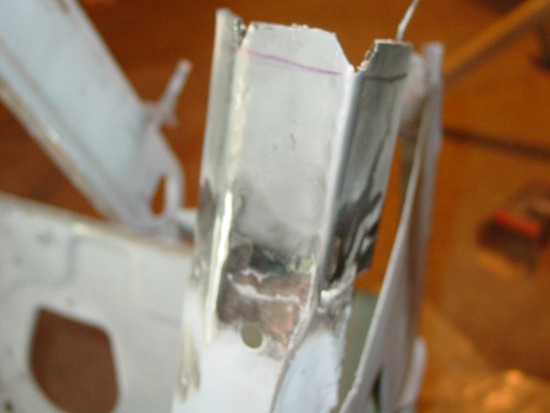

By the end of the day, I had both outer rockers tacked in place and was feeling pretty exhausted. I hope to have the LHD firewall into place tomorrow, along with the inner rockers (which will be a pain to fit into place) and fingers are crossed that this will come out the way I am intending. There are a lot of unknowns as far as the effects of shrinkage and possible warping that make me a little nervous about the result. You can see the end of the rocker where it joins to the door post at the front wanting to twist a little outwards in the photo below, and i don't think it is a significant issue at this point.

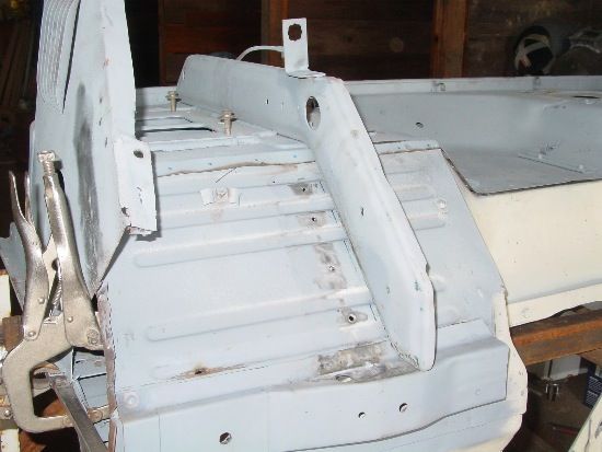

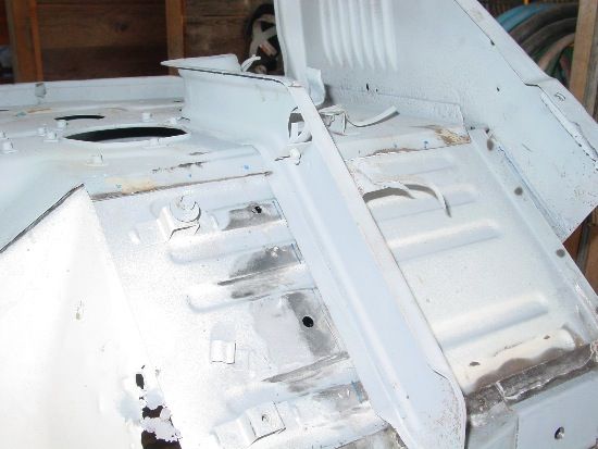

It took a while to hack out the remnant of the firewall door pillar, then, after tacking the inner rocker in place, I decided to take a look at how the LHD firewall would fit. I was getting nervous about metal warp at that point. As you can see, the firewall stiffeners are not in identical alignment for LHD/RHD firewalls

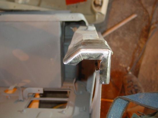

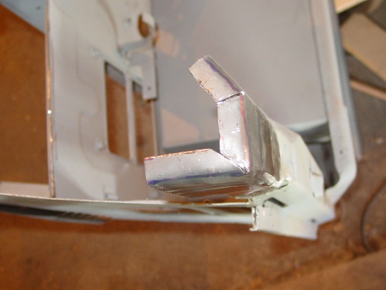

Then I chopped out the inner driver's side rocker, but chose not to tack it into place quite yet. I put the LHD firewall back on, and then used a little persuasion to adjust the outer passenger rocker panel into plane with the door pillar. Then I started fabricating the lower ends of the door pillars, doing the detail slightly differently than factory by bending little tabs onto the bottom which I will weld to the floor pan.
and at that point, the moment had come: I welded in the firewall and Henry James is now LHD :bounce::bounce:
I have lots of welding still to do on the cab, not to mention the upper cab window and one of the doors, but it felt like a milestone in this project to finally have the cab converted.

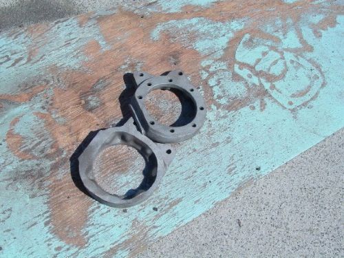

Got back to the truck and set about slicing the knuckles apart for the last 1" to produce a ring with the disc brake tabs. Then I ground them somewhat flat along the cut line and media blasted them.
Then I went to see how they might fit to the axle flanges, and it was a bit discouraging. The backside of the flange has a raised lip on it that is larger than the diameter of the knuckle section, so I would have to get them machined, and I know already that the diameter of that inner raised lip is 4.75" and that it sticks out from the back of the flange about 3/16ths. The bolt circles are different in diameter as well, and after machining a rebate into the knuckle section, there wouldn't be much meat left. Back to the drawing board...

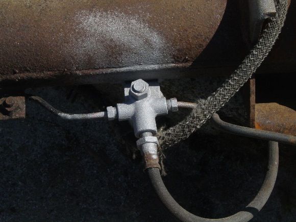

While i had the blaster going, i cleaned off the brake line mounts on an 60 series front axle I had, and then chopped them off. Then I cut the mounts for the lines off my 47 front axle and welded the 60 series bits into place.
