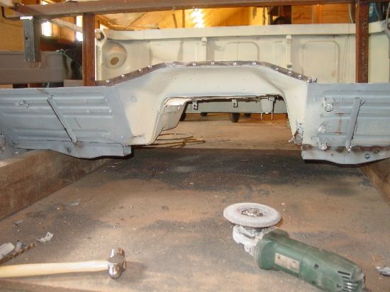

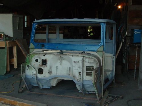

Then I turned my attention to the cab. I got some help and flipped it over. I wanted to get a brace on their so as to protect against warping from all the floor welding. I temporarily threw the cab sheet metal together to see how things looked, and all was well. Tomorrow I will weld a jigging brace into place in preparation for putting the new firewall in.
I have no idea what happened to the third picture, but I'll leave it there for now!
Here's a better picture of the mocked-up cab. The new windshield is in the same color I will probably be painting the truck, though I might opt for a Mazda blue instead of the Toyota 857 Nordic Blue. I chopped out the clutch master mounting and will graft it into the LHD firewall, as it has the mounting for the earlier 3-bolt flange clutch master.

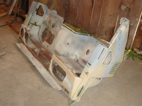

Started with the LHD firewall and welded the door jamb light switch bosses into place. Then I patched the upper corners of the dash, where the windshield fixing bolt brackets had been previously chopped out I have a set of the brackets to weld in afterwards, and will wait until I can use the windshield on this bulkhead to get the positioning right.
This LHD firewall needed its slave cylinder hose mounting bracket moved from the driver's side to the passenger side, as that is where the 2H located the slave cylinder.
Finally, as far as work on this firewall goes, I shortened the floor pan connecting sections, as I will be keeping that section of the floor with the existing cab, since the bosses are welded in to suit the heat shield mounting for the 2H exhaust.

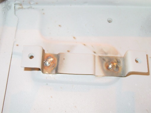

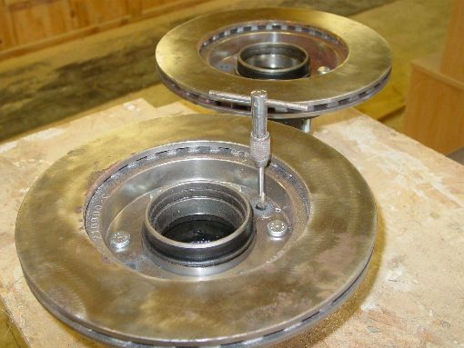

Then it was on to finishing off the rear hub/disc assemblies. To mark the center of the hole, I used a pilot point drill of nearly the same size as the hole in the rotor (pic 1), and this turned out to be adequately close enough. I wish I had a set of spotting punches though for these type of tasks.

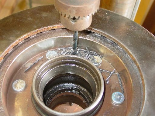

I drilled and tapped for the fixing bolts. I made an assumption about the size of the fixing bolts that was wrong (10mm, NOT 8mm), so I had to do the drilling and tapping twice. At least the mistake allowed for a simple solution. A little piece of trivia: I learned that the '8.8' that is marked on the heads of the 10 mm bolts must mean the size of drill required for tapping to the correct size (in the case of 10x1.25mm threads), since '8.8' is the correct tap size given in a machinists table or drill sizes I looked at today. All along I had thought that the '8.8' referred to some sort of strength standard. The wheel studs have '10.9' marked on the back of them, so is this the correct size to drill for those as well? Since the size to be drilled for 12mm bolts is 10.2 (http://www.engineersedge.com/manufacturing/metric-iso-tap-drill-chart.htm), and this hole is sized for the fatter part of the press in stud, I suspect that 10.9 is the size of hole needed for a good interference fit. Or am I drawing completely wrong conclusions here?

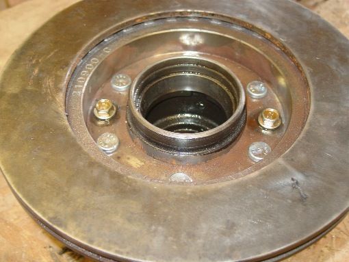

Last pic, showing the finished up rotor install. I then went and drifted the bearing cups out of both hubs and they are now ready for new bearings, seals and so on. I can't proceed with the install however until I create some caliper mounts. After looking at a couple of options, I'm going to slice the disc mounts from some 60 series knuckles, and find a way to attach them with at least 3 bolts. Looks like a set of knuckles from the wreckers, or G&S, will be $100.

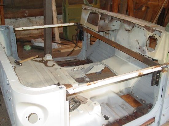

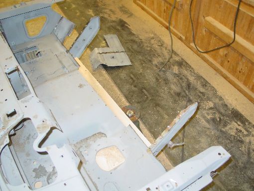

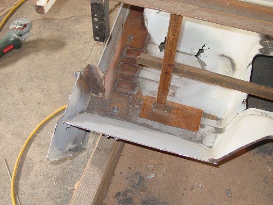

I spent the better part of the morning making a jig to locate the new bulkhead into position and keep the door posts from spreading. I used a couple of 'L' brackets, and drilled them to bolt up to the door limiter goes in place. I forgot about the light switch bosses newly welded in place on the LHD firewall, so I will need to shorten the bottom side of these brackets before the new firewall goes in.
Fortunately I was able to scrounge up enough steel to make the jig without having to buy any metal. After the brackets were bolted up, I put a cross-tie in, and then ran square tubing from the door striker mount are to the crosspiece. Finally, I welded a couple of knee braces in.

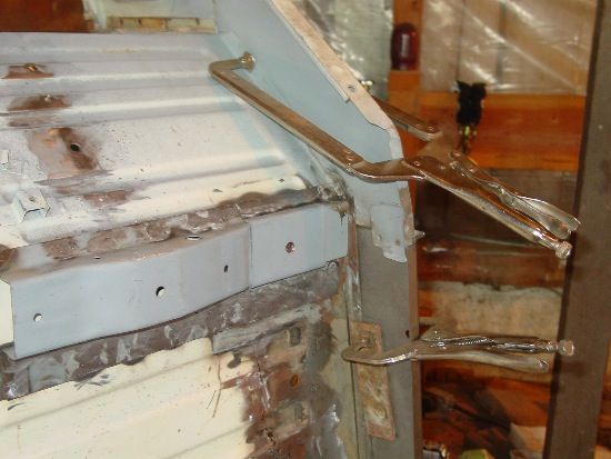

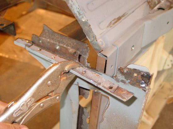

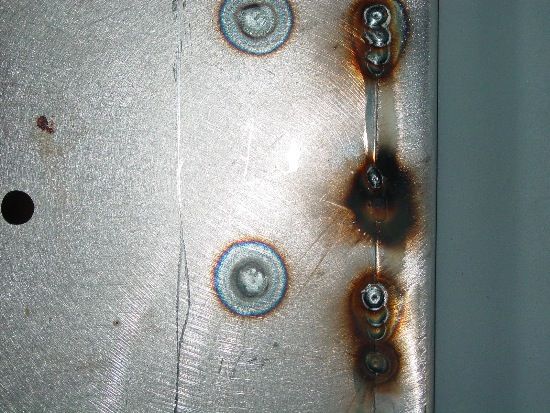

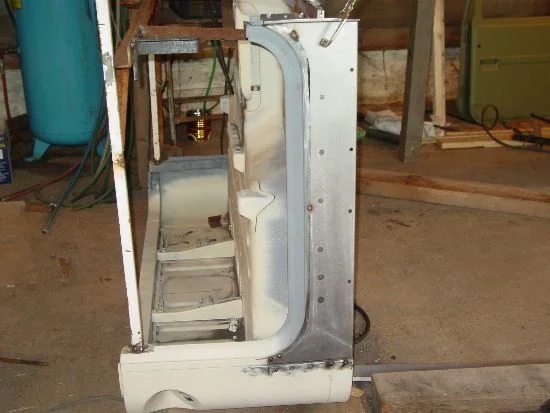

spot light on welding - there were a couple of areas where I didn't make very tight butt joints; in the case of the passenger side, I had to section some rusty metal out from above the patch panel's upper edge would be and there was no way to have one clean cut line to match the rocker.
