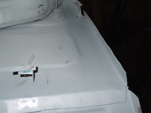

The side cowl off the old RHD firewall has the extra plate welded to the inside of it to connect to the heater blower - it's like a flange that the blower mounts against. While my heater blower now relocates over to the other side, I chose to not remove this flange from the cowl panel as I am scheming up a way of routing my air filter inlet to it (more on that later).
Here I'm just checking the fit of the panel off the old firewall in place on the new one.

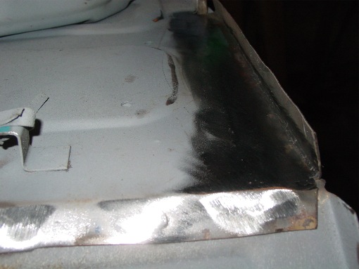

Next I started on repairing the rotten floor section adjacent to the side panel. I chopped it out, bent up a section of 16 g. and cut it to the same configuration. The bend on the flange is a bout 110˚.
When i removed the old section, I noticed that the inner side had the spring mount for the vent door spot-welded to it. I was lucky in my choice of cut line that I didn't slice it right in half :o
Drilled out the spot weld and mounted the hinge onto the patch repair section

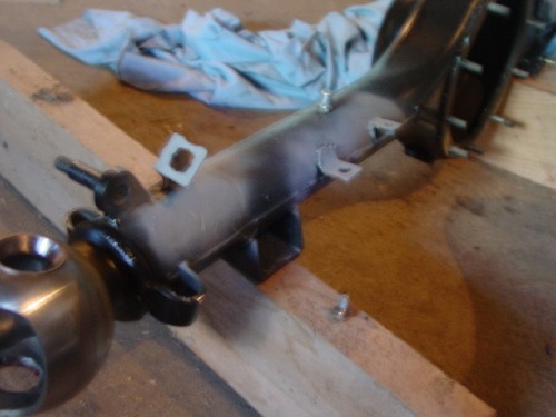

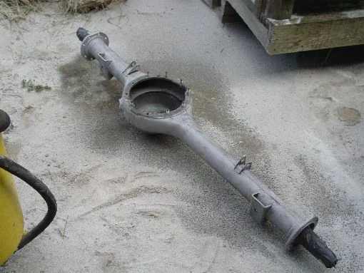

I had tried to figure out ways to mount disc brakes on my rear full-floater, but the 4-bolt flange style just is not cooperative in that regard. I was talking with John at E4 Auto about this issue and he very kindly offered to swap me an older style of full floater axle housing for mine. I knew that the earlier type of housing, with the eight bolt flange, would mean that the disc brake install would be a breeze, so I went for it, even though it was another round of the 'one step forward two back' dance i have been getting very proficient at.
it took me a couple of hours to strip the axle down. In the process, I learned all about the differences between '75~'80 F.F. axles, and '80~'90 axles. Other than the flange, the main difference is in the way the hub is mounted. The fixing nut and lock washer system are different, and the outer seal in the early axles is contained withing the outside fixing nut, whereas on the later type of full floater the outer seal is fitted to the end of the axle tube.
The difference in seals led me to examine the differences between the hub mounting tubes on the axles, and there is a length difference. However, upon closer inspection, the spacing between bearings, as well as bearing size, looks to be the same. The axle shafts have different sizes however in terms of the turned section just under the flange that rides against the seal. The earlier type with the seal fitted into the nut (a 'gland seal' or something like that) requires a axle shaft with a larger section to bear against the seal. The later type has a small section. so, I need to swap both housings and shafts, but the hub seems to fit either without problem (maybe there is something I'm not seeing in this equation yet however...).
Finished off by blasting the housing and axle shaft ends with crushed glass and then etch-priming them. The Gorilla brand duct tape is the answer for effective masking of surfaces when media blasting.

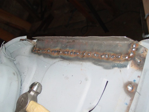

Did a bunch of cutting welding grinding priming yesterday and today. Didn't have the camera around yesterday unfortunately, but I remembered it today.
I finished off with the driver's side cowl panel, a job involving a fairly large patch, and then turned my attention to the passenger side. In the second picture I'm test fitting the panel back in, and it isn't fully lined up yet, as you can see.
