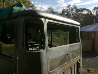

ok so ive made a bit of progress. i mounted my cabin. pretty straight forward. just cut my chassis mounts off and bolted them to the cabin. squared it all up and tacked some plates in. bit of mucking around. turned out pretty good.

hey mate. nah no roof. im gunna bob the end of it so that it has about 30mm overhang from the tyre. i just like the look of styleside. i will bar it up to limit damage lol. styleside will be cut of troopy tomorro and sitting on chassis ready to get the chop.
