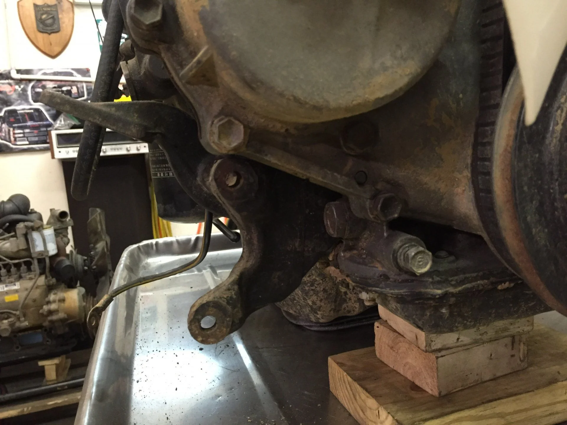

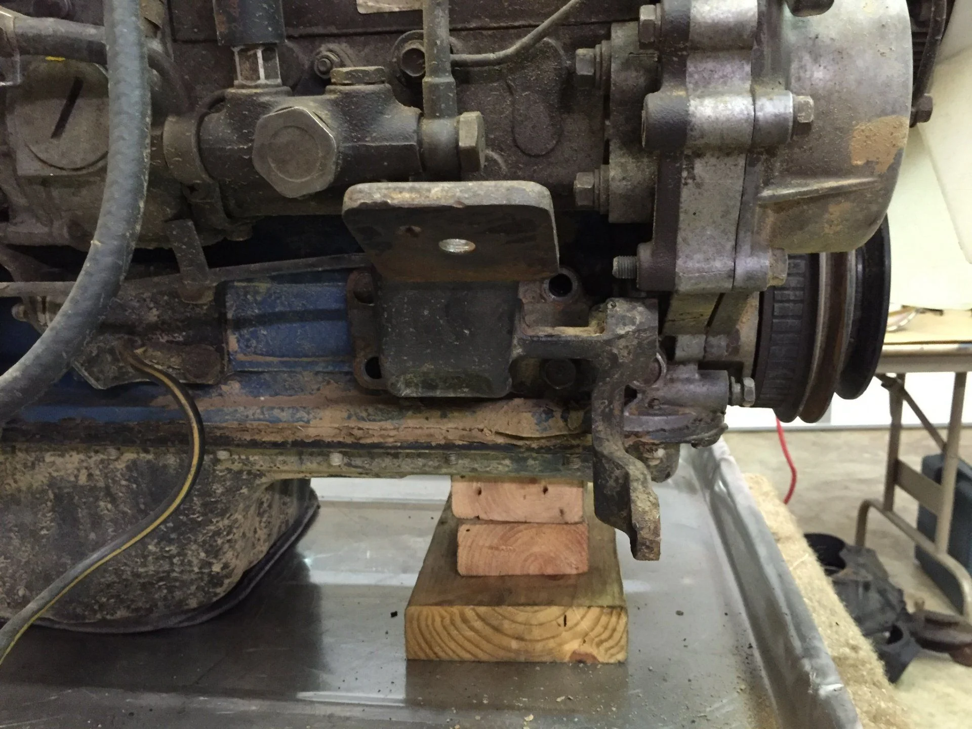

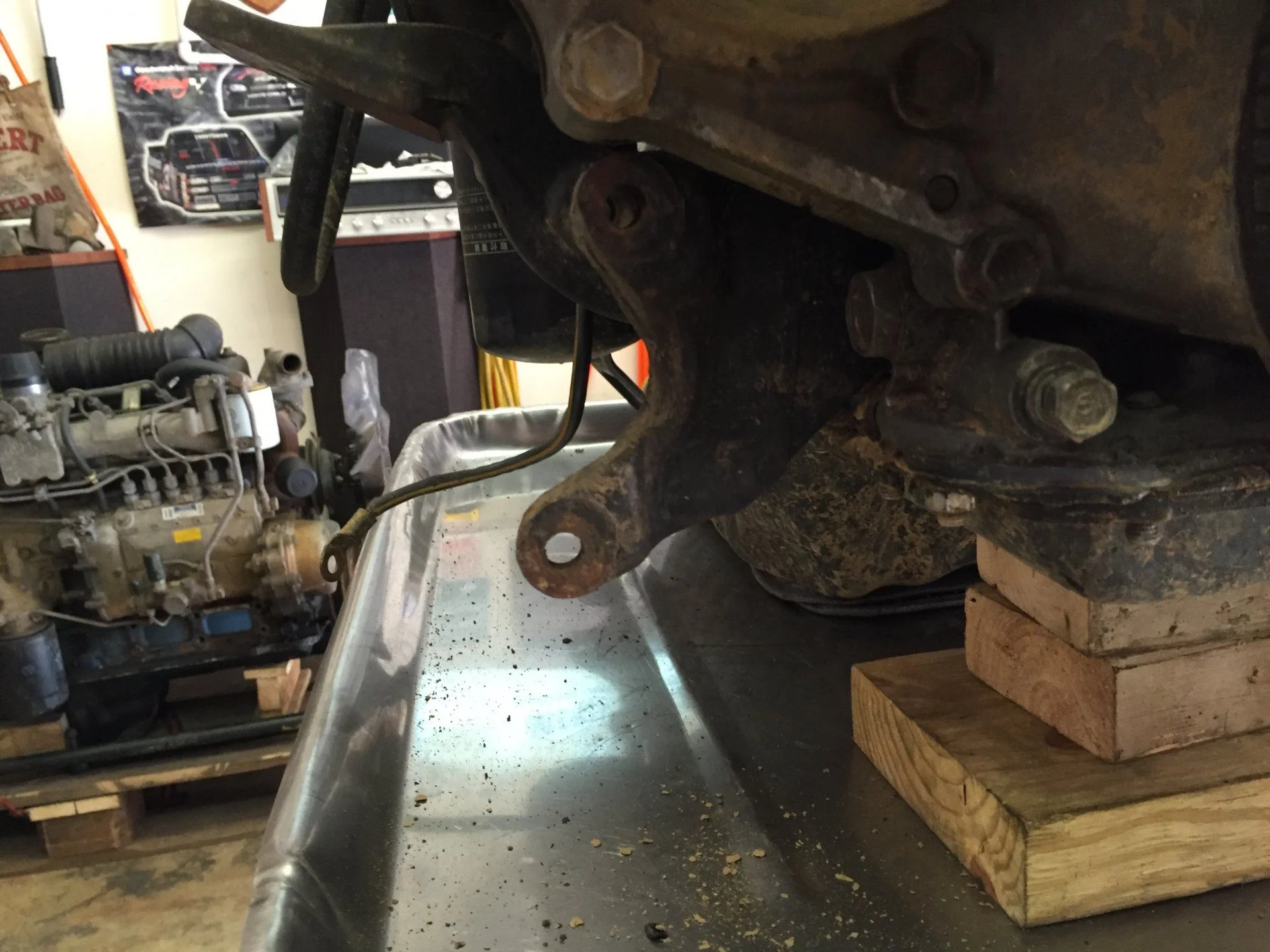

When I was building my version of an HJ45 I was told this a few times and yet I found am using a PS setup from an HJ 45/47 2H. It is not from a 60 series. I had one of those and would not work. BTW my parts came from AUS.
You probably had something that had been grafted onto a HJ45 or 47 from something else.
You graft cast iron mate
Yep.. its an early 60 series power steering pump mount. Bottom radiator hose will foul when fitted to a standard HJ45 or HJ47.. with modification it can work but it requires the bottom radiator outlet to be modified - its not an ideal outcome for the radiator.
